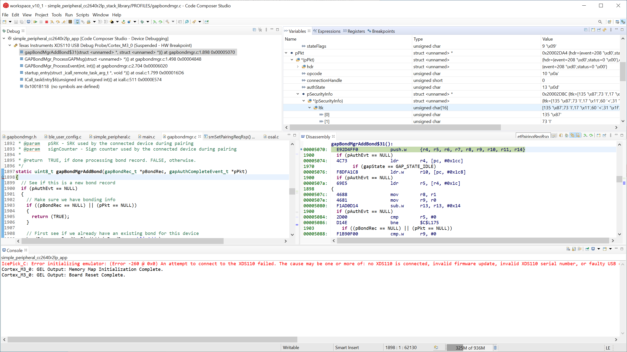

    The Security manager usually interfaces through the GAP Bond Manager, therefore I am debugging a level up from you to try to find a combination of factors accessible by the user to reproduce the problem. The flags on my system match yours (MITM disabled, Bonding, etc.) and at the point of authentication I have the following flags:
    At the moment am trying to reproduce the failing pairing "retention" bonding here in my setup to no avail so far - it always saves the bonding to the SNV memory. That is, as long as I keep the GAPBOND_BONDING_ENABLED set. I can see this when I get to the point of adding the bonding to the SNV, where the function gapBondMgrAddBond() shows a valid LTK.

  • Hi Rafael,
    Thanks for your response.
    You are right, I think I have gone a bit further because at the point you are showing at the first screen shot everything looks good:
    when it calls GAP_Authenticate(&params, pPairReq); the key distribution flags set properly to 0707: LTK, IRK, Sign.
    But when the stack builds the actual response message in smSetPairingReqRsp it somehow ignores this list and sets only IRK flag to be sent to the central. Thus the central send send only IRK key back to the peripheral and when it comes to gapBondMgrAddBond the pAuthEvt->pSecurityInfo pointer is NULL.
    Can you please put a breakpoint at smSetPairingReqRsp and try to see where it takes the flags from and why it doesn't set LTK flag in the response message?
