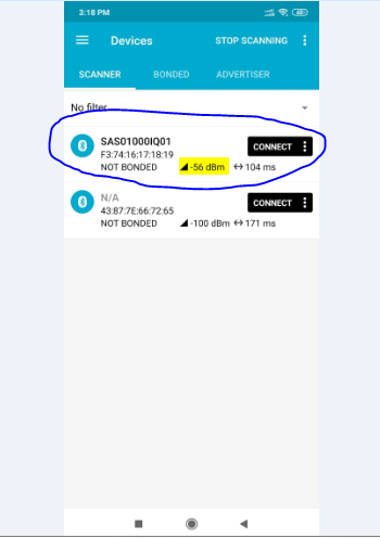

  • Hi ,
    I  have checked the tool you have mentioned in the last comment.
    In that also the dB value is not shown. Please help me in this issue.
    Doubt:
    As we know that the default dB value is 0dB.
    But when in that case when I am seeing the name of bluetooth device on the nrf-connect app, then the application is showing the dB value as  ~ (-50dB).
    Below is the image showing the dB value in the nrf-connect app.
    And when I am changing the default value to a different dB value --> In this case also the same dB level is shown on the nrf-connect app.
    Why is this so?
    Saurav
  • Hi Saurav,
    When using EnergyTrace, you will only be able to see power measurements such as change in current but not specifically TX power. I strongly recommend using a power analyzer if you need to see the exact TX power measurement.
    The nrf-connect app displays the RX power measurement not the TX power.
    Jenny
    When you set the TX Power it does not reflect at nRF Connect App.
