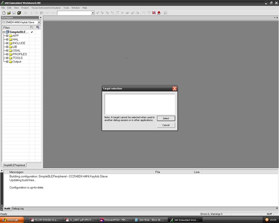

Today I had some problems with my computer and I reformated it and reinstall  the Iar 7.51 but now when I try debug the program the box showed below appears and the debug mode doesn´t enter because the Iar doesn´t recognizes the CC Debugger. I checked if the Cebal driver is correctly installed and it´s fine.
After instalation, I copied the files from EW8051-7.51M-EV to IAR 7.51 installation directory to compile to support the CC2540 chip.
Did someone face this problem? How can I do to fix it?

  • Are you able to use TI Smart RF flash programmer?  You should also verify you get a a green light on the CC debugger.
    -Greg
  • Hi Greg,
    I´m able to use TI Smart RF flash programmer and I verified the color led. I got a green light on the CC debugger.
    Best Regards
    Frederico
  • Have you installed all of the necessary patches for IAR v7.51A?
    1. Follow this link: http://supp.iar.com/MyPages/
    2.    Log in with email address and password
    3.    At the bottom of the page there will be two links: “Information on latest version (7.60)” and “All available versions”. Click the link for “All available versions”
    4.    There should now be a list of several version of IAR. Click the link for “7.51A”
    5.    There should now be a list of 6 downloadable items. The first is for the IAR installer itself, which it appears he already has. Download items 4 (“Update for Texas Instruments debugger driver”, 5 (“IAR Systems Embedded Workbench for 8051 patch 7.51L”), and 6 (“IAR Systems Embedded Workbench for 8051 patch 7.51M”)
    I installed all necessary patches for IAR v7.5A.  I copied the files that are showed below from   EW8051-7.51M-EV to their respectives directories at IAR instalation path.
    1) I copied ioCC2540.h to inc directory
    2) I copied lnk51ew_cc2540b.xcl lnk51ew_cc2540.xcl to
    config directory
    3) I copied CC2540.i51 CC2540.ddf to config/devices/Texas
    Instruments directory
    4) I substitute 8051emu_cc.dll .
    But now, the program returns the message showed below:
    Do someone have ideas to solve this problem?
    Frederico
    the picture is a little fuzzy, but i found the file 8051emu_cc.dll?
    C:\Program Files\IAR Systems\EW8051-7.60\8051\bin
    Note - I'm using 7.60, so you could try an evaluation installation of that + patches. Sorry, but I'm not sure what may be going wrong here.
    -Greg
