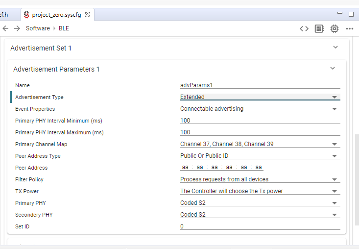

I've been trying to follow along with the bonus task 1 for the connections SLA:
https://dev.ti.com/tirex/explore/node?node=AKui.0P6XA0Q2Q70ZaYksA__pTTHBmu__LATEST

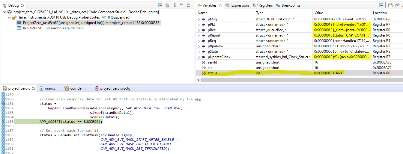

When I go and switch the advertisement type in syconfig to extended, the settings look just like what's shown in the SLA. However, my project zero is getting trapped in the project_zero_spin function and it looks like the code returns a status of 0x1E from line 1181 which loads the scan response data into the GAP.
This status return code doesn't even appear to be a valid error code. Is there something I'm misconfiguring here?
