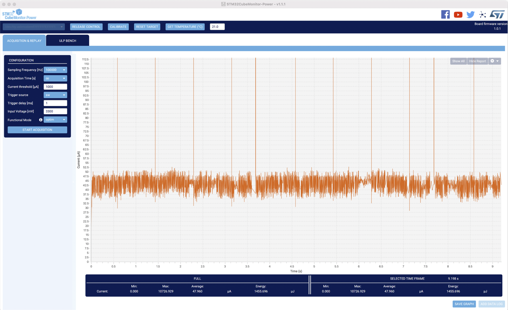

LAUNCHXL-CC26X2R1: SimpleBroadcaster standby current consumption 45uA
Part Number: LAUNCHXL-CC26X2R1
Other Parts Discussed in Thread: ENERGYTRACE, , CCSTUDIO, SYSCONFIG
Hi, I am trying to confirm the datasheet current numbers using the LAUNCHXL-CC26X2R1 and SimpleBroadcaster example. I have HW rev B, and removed R89 to disable the flash but can't get any standby current lower than about 45uA. All jumpers are removed and the board is being powered and measured by a third party board X-NUCLEO-LPM01A using 3.3v, and I see similar results using EnergyTrace. This screencap is for when advertisements are set at every 4 sec, with recharge pulses visible in between, cropped to zoom in on the standby level. Is there a way to get down to the 0.9uA level in the datasheet?
