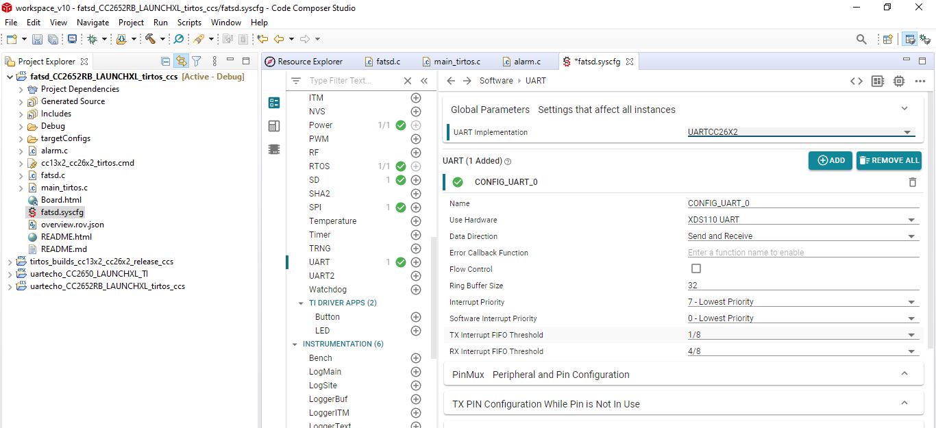

    These two while loops are in different tasks as shown in the attached image below. 1st while loop "while(1)" is in fatsd.c & another while loop is in alarm.c.
    In fatsd i am receiving uart data from another microcontroller and passing a message to another task in alarm.c file to write buf array data in sd card.
    2. Why do you keep calling SDFatFS_init, SDFatFS_open, and SDFatFS_close in a while loop? You should only call them once.

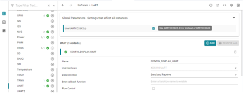

    As I mentioned in my first message, the CC26X2 UART driver is able to return on new line.
    1- Activate the proper driver using SysConfig:
    2- Set up the UART driver as following:

  • Hi , please look at my sysconfig screenshot, i think its already in CC26x2 driver mode. I am also not getting this option of use cc26x2 driver instead of cc26xx as in your case.

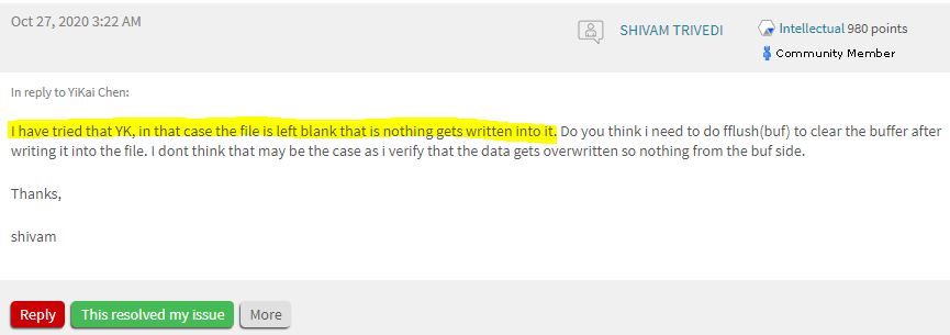

  • I suggest you to do fopen/fclose outside while loop to avoid fseek every time you want to write buffer.
  • I have tried that YK, in that case the file is left blank that is nothing gets written into it. Do you think i need to do fflush(buf) to clear the buffer after writing it into the file. I dont think that may be the case as i verify that the data gets overwritten so nothing from the buf side.
    shivam
  • Yes, I would suggest you to call fflush to flush data to file and you also need to check if you close the file before to remove SD card to check file on your PC.
  • I tried fflush still it didn't work.  Yes i am closing the file everytime after writing the data. The issue is that the every new string overwrites the earlier written string in the file. Please take a look at my code below. One more thing that i have noticed is when i am using  fwrite(buf, 2,strlen(buf), src); instead of fwrite(buf, 1, strlen(buf), src); i am getting my cursor (file pointer) after 2 strings but one string is empty as shown in image.

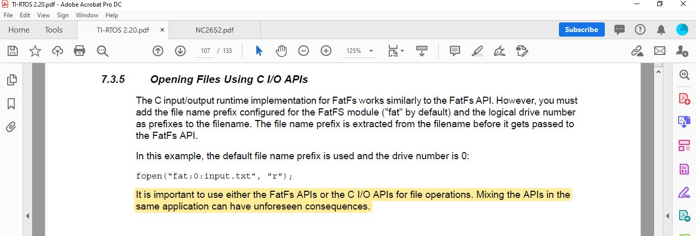

  • Hi i found this in tirtos documentation in the fatfs usage section is it something related to this that fatsfs api is able to write in a particular sector location only because of which the string is getting overwritten?
    Please see the attached image.
  • I don't see relation between the descriptions and your problem.
  • okay, please see this as well do you think this will affect as i am using both CIO Apis and FATFs apis in my code.

  • No i was talking about the highlighted text in the image.
  • I don't see you use other mixing API, right?
  • But i am using fflush and fwrite both from stdio.h & Fatfs.
    Anyways i will study more and check.
  • The original fatsd example uses fflush and fwrite so it should have problem.
