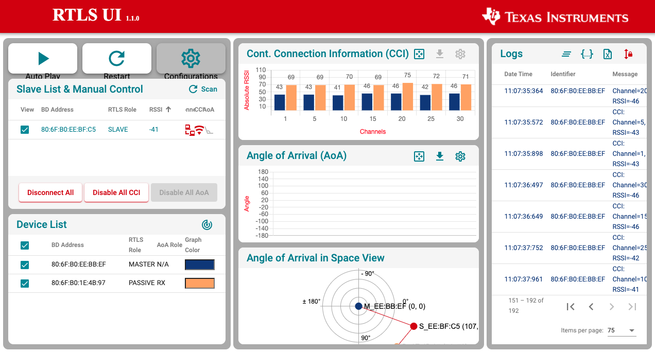

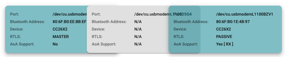

Dear TI Support,
I follow the SimpleLink Academy (4.30.01.00) to study RTLS Toolbox AOA. I have 3 LAUNCHXL-CC26X2R1 and 1 BOOSTXL-AOA set on passive device and using simplelink_cc13x2_26x2_sdk_4_30_00_54 SDK. I want to set my device to [Option 2] which is Only Passive device provide AOA measures. However, I cannot set my rtls_master file like this rtlsConfig.rtlsCapab = (rtlsCapabilities_e)(RTLS_CAP_RTLS_MASTER), it will warn me ==Warring! One of the devices not supporting AoA functionality==. And if I keep the file unchanged, I will get a csv file with both master and passive samples in it.
My question is how can I set my device to Only Passive device provide AOA measures?
Thank you very much!
