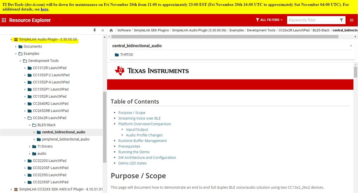

Please help me to find an example project for audio streaming over BLE. I couldnt find a code corresponding to this one in Ti example repository.
. Please help me on this. Thank You
Also please note there is an official audio plugin now available (similar UI and additional codecs):
Please see Google Chrome screenshot below. Maybe start with https://dev.ti.com/ ??
Please see Google Chrome screenshot ABOVE. Maybe start with https://dev.ti.com/ ??
You can click on the Software drop down and browse down to the SL Audio Plugin under SL SDK Plugins.
Not sure why my direct link is not working for you:
