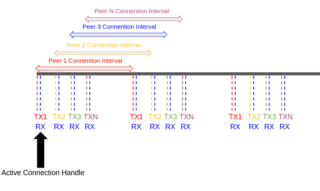

    You could refer to following screenshot, if Launchpad have connected to 8 peers(Central).
    For example 1:
    When LaunchPad wants to transmit notifications to all centrals, if the currently active connection handle is peer1. we believe that using your method to iterate through the array can transmit notifications to all centrals. it should be work.
    For example 2:
    When LaunchPad wants to transmit notifications to all centrals, if the currently active connection handle is peer3. Using your method to iterate through the array, it doesn't work. Because the wrong connection handle was used.
    Regarding above state, just my opinion, do you have any comments for us?
    BR
    Trevor

  • Trevor,
    I believe that your use case is exemplified in our SimpleLink Academy Lab called "Custom Profile". I would recommend going through it.
    Now, very specifically, from your diagrams you could learn the "active connection handle" by registering for a callback from the stack when a connection event happens, using our GAP layer's API named GAP_RegisterConnEvtCb(), on which you will pass a pointer to a function that will receive as a parameter a structure that has the connection handle of the active connection.
    Luis
  • Hi Luis,
    About GAP_RegisterConnEvtCb(), we are worried that it may impact the system performance when peripheral connects to many peers.
    But there seems to be only this method.
    Thanks.
