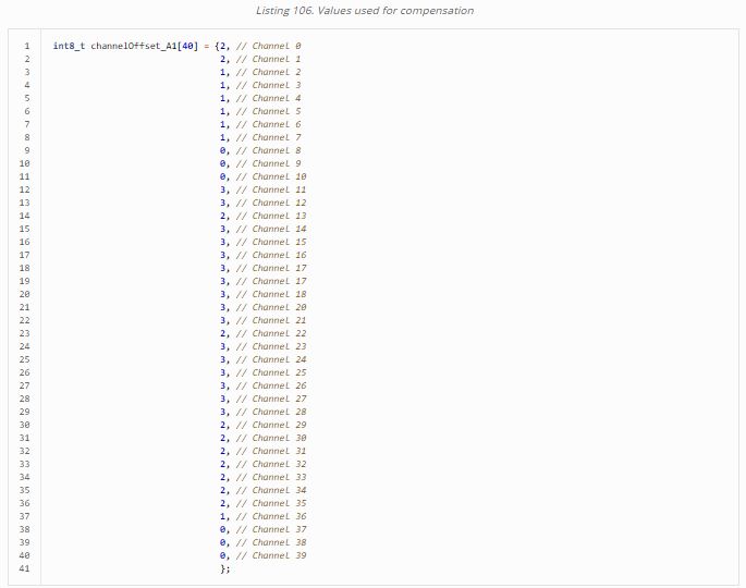

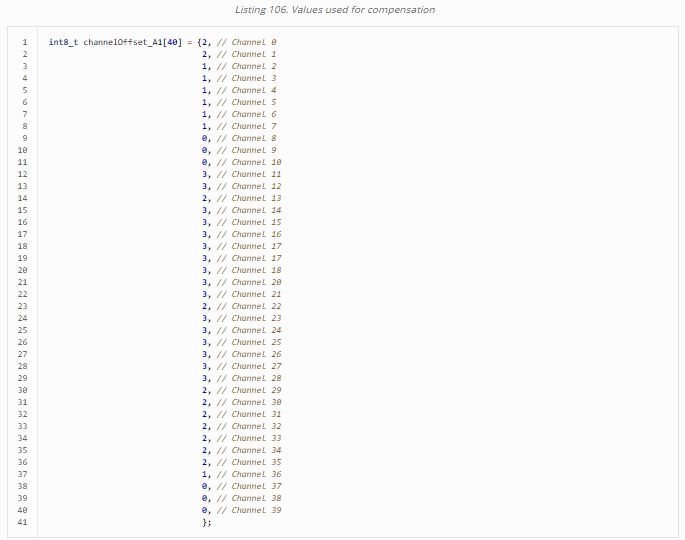

    The out of the box software provides fixed compensation values in the table pair_A1[]. In addition, some channel compensation values are provided in the table channelOffset_A1[]. Would you require some dynamic values instead of these fixed values?
    The compensation values have been determined in an anechoic chamber by our engineers. These specific values have been chosen in order to have the best results possible for a given fixed angle.
    If you want to do the same, you need to take a few measurements for the angle you want to optimize. The measurements have to be made for all the BLE channels.

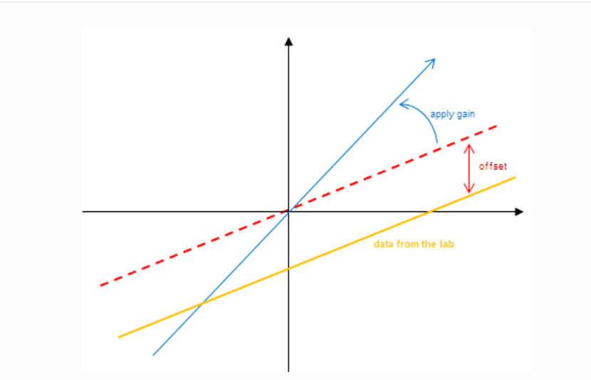

    It may be the answer to my questions from RTLS Toolbox. Dose it right in the following steps I think?
    1. Add the angle compensation in 0 degree. Test in fixed channel and the value is "offset" in the source code
    2. Adjust the slope for all angle compensation Test in fixed channel and the value is "gain" in the source code.
    3. Add the angle compensation in 0 degree.  Reproduce step 1 and test by each channel and the value is "channel offset" in the source code.

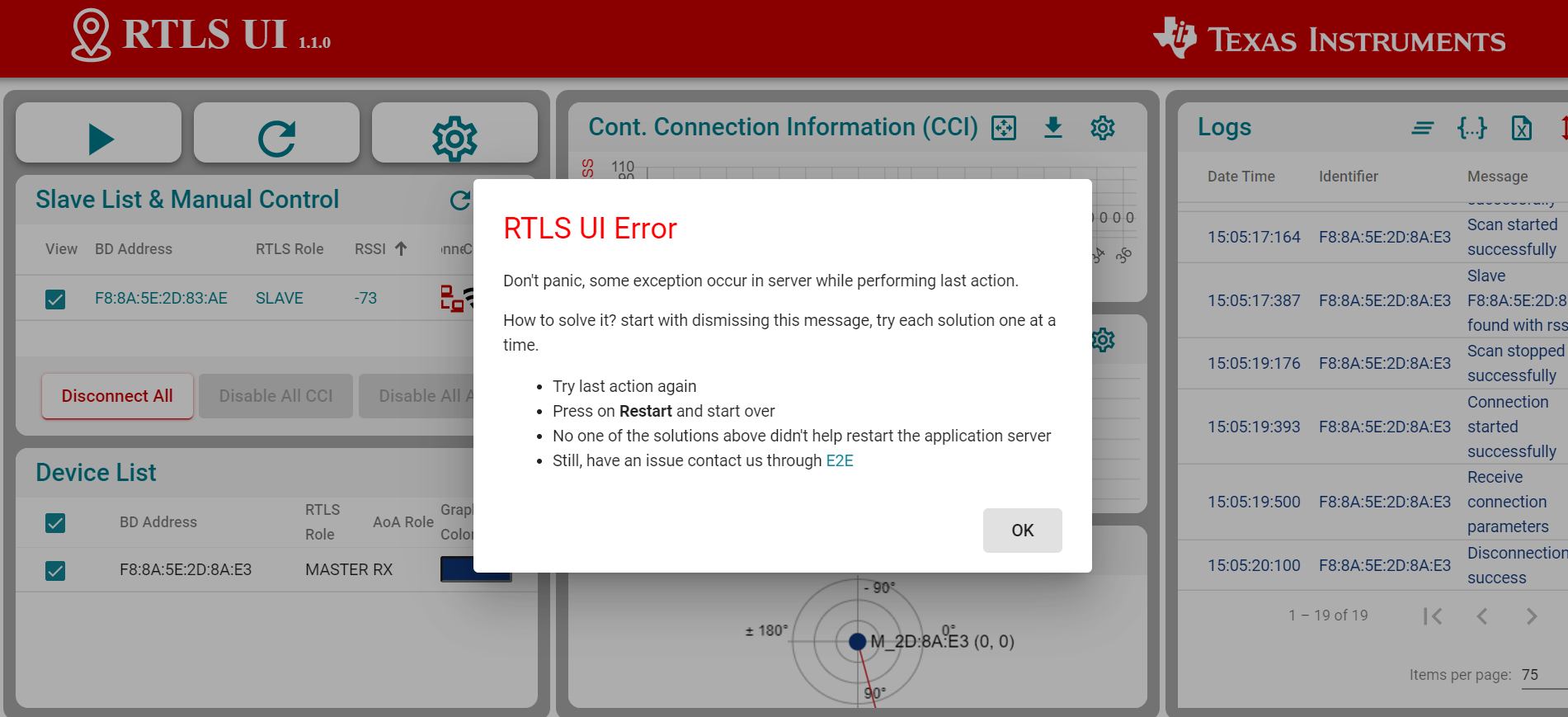

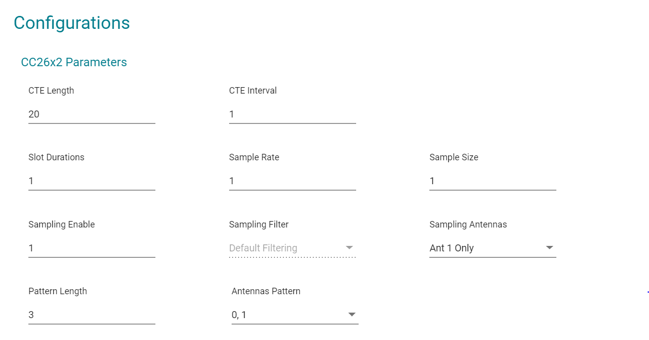

    It also reports RTLS UI ERROR when I set two antennas(0, 1) of array1 for the test. Work normally if test by default(0, 1, 2)

    The screenshot of RTLS Toolbox :
    The screenshot of RTLS Error:
    The screenshot of two antennas setting:

    The steps for angle compensation you have described look correct to me.

    On your screenshot, I see an error on the pattern length (which is 3 instead of 2).

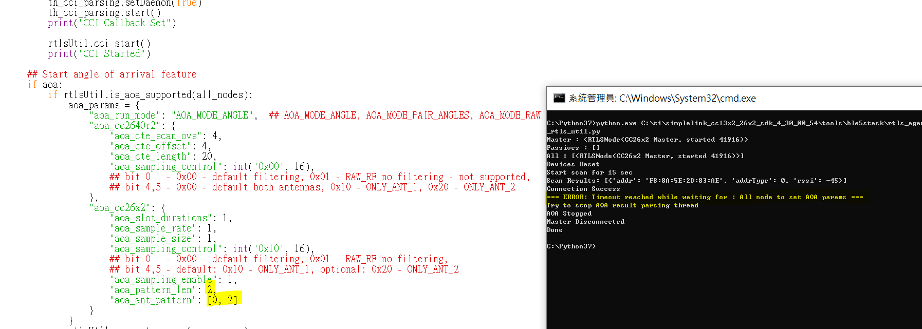

    One more question, I have tried to modify pattern length from 3 to 2 and it worked normally in two antenna case. Antenna pattern : (0, 1).
    However, it still pop out the same error in the other case such as (0, 2) or (1, 3) for array 1.
    Any setting I miss if I want to add compensation for each two antenna? Thanks.

    I have also tried it in python script. Looks like the same symptom as UI. I still can't be running by two antennas.
    In the case of two antennas, it only worked in (0,1) but did't work in (1,2) or (0,2). I also got a poor AOA result in the (0,1) case.
    I not sure whether it is the bug of SDK or not even through UI and python script.
    Thanks.
    Fail in two antennas:
    Pass in three antennas:
  • Hi Patrick,
    The issue is due to a limitation of our implementation (due to the algorithms used to compute the angle). If your are using AOA_MODE_ANGLE (as done in the UI and in the python code you have shared), you cannot change the antenna pattern field. It must be 0,1,2 for antenna array 1 or 3,4,5 for antenna array 2.
    In your case, you need to use the RAW mode and do the angle calculation out of the tools provided.
    An other option is to modify the code running on the device in order to allow the algorithm to compute an angle based on only two antennas.
