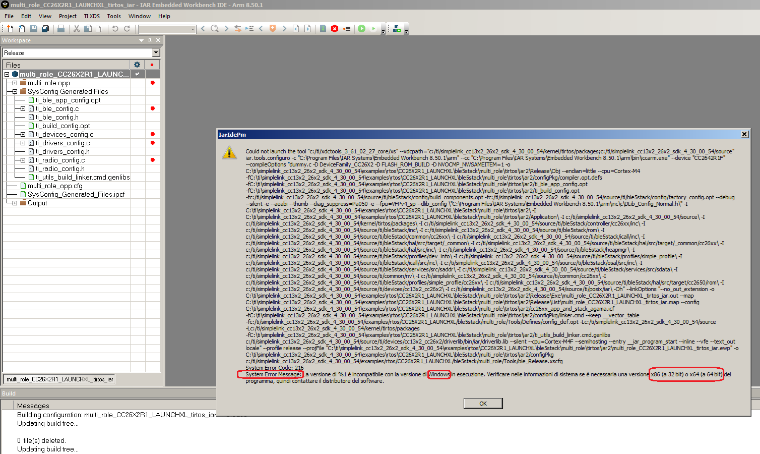

 fHi everybdoy ,
I m on WIN7 proferssional  32bits  and latest SDK and latest IAR 8.50.1
now I have issues  as in the past  like this post  ---e2e.ti.com/support/wireless-connectivity/bluetooth/f/538/p/779205/2888779#2888779----
I applied same workaround no success , coudl you help me ?
here is the error I get on multirole example
thank you
br
Carlo
  • Hi Colombo,
    I will investigate internally to determine whether there are any solutions, meanwhile can you please explicitly describe the steps performed to try and resolve this problem.  Also, do you have any issues when using CCSTUDIO?
    Edit: The XDCTools v3.61.02.27 Release Notes contain the following: XDCtools 3.55.x (and greater) for Windows targets purely 64-bit distributions for of Windows. As a result, this release requires a 64-bit Windows host. If you need to use XDCtools on a 32-bit Windows host, you must use XDCtools 3.51.x (or below).
    Ryan
  • Hi Ryan
    what we tried is same steps as other post mentioned , in that case worked  now no .
    CCS we cannot use for now
    thank you
    BR
    Carlo
  • Hi Colombo,
    The previous case involved an SDK which used a XDCTools version of v3.51.x or below and will not work for this instance.  As explicitly stated in the Release Notes excerpt, you must use a 64-bit machine with the SIMPLELINK-CC13X2-26X2-SDK v4.30 which uses XDCTools 3.61.02.27 or revert to v3.20 for XDCTools 3.51.03.28 support.
    Ryan
