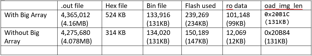

In the example application project simple_peripheral_oad_offchip_CC13X2R1_LAUNCHXL, I want to use byte array of big large size 87KB or more larger like as follows:

And I found the size of generated oad images are almost the same with big huge array or without big huge array but their hex file size are big different, as following tables
Please our hex file, map file and bin file with big array or without big array.

    Can you use the map file to compare the memory usage of the files instead of the bin/out/hex files? Because then you will see the actual difference in memory usage.
    Elin
    Yeah, you are right and I have compared the map file and resolved this problem. I want to ask another problem I have come across. I have done the off-chip OAD but when I build the project and output the following information including .ccfg:
