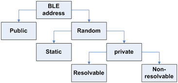

    Let me share this picture summarizing the way BLE addresses work:
    The Public address has to meet the IEEE 802-2001 standards. The public address  has a OUI (Organizationally Unique Identifier) obtained from the IEEE. A registered Public address is hard coded on the device. This address has a OUI obtained by TI from the IEEE. There is a way to modify this address and to replace it by another address obtained from the IEEE (this needs to be modified in the ccfg.c file through the defines SET_CCFG_IEEE_BLE_0 and SET_CCFG_IEEE_BLE_1).
    So if your question is does the the BLE Public address (also called BD_ADDR) is the same address as the MAC, then the answer is YES.
    However, if your question is does the BLE address used by a device is always the same as its MAC address, then the answer is NO (because as you can see on the graph, a BLE device can use a random addres).
    Regarding GAP_ConfigDeviceAddr, this function cannot be used to change the MAC address (BD_ADDR) of the device. This function is used to tell the stack what kind of address has to be used (public, static, private resolvable, private non-resolvable). As you may have seen, the function GAP_ConfigDeviceAddr() takes two parameters (an address mode and an actual address). The parameter passed as actual address is NOT used if you chose to use the public address or private resolvable.

  • Hi Pawan,
    The rules for static addresses are provided within the Bluetooth Core Specifications in BLUETOOTH CORE SPECIFICATION Version 5.1 | Vol 3, Part C, §10.8.1 and BLUETOOTH CORE SPECIFICATION Version 5.1 | Vol 6, Part B, §1.3.2.1:
    As you can see, the static address has to be random and changed at each power cycle. It means you are not allowed to use a fixed addr as static address for all the devices in production. I don't know what could happen if two devices have the same address but probably nothing goo (at the same time this case is almost impossible).
    The random addresses are used for privacy reasons, to avoid to have someone tracking a device. You may want to review the user's guide for more details on addresses types.
    To read the MAC address, GAPRole_GetParameter(GAPROLE_BD_ADDR , ownAddress) is the correct function for peripheral devices. For central devices, you can use GAPCentralRole_GetParameter(GAPCENTRALROLE_BD_ADDR, ownAddress). Just FYI, these are not the only ways to read the address (you could use an HCI command like HCI_ReadBDADDRCmd()).
