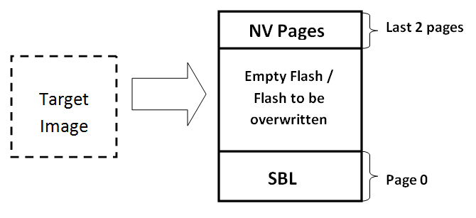

This last definition (OAD_KEEP_NV_PAGES) is optional. If defined, the NV pages (non-volatile memory where bonding information, among other things, is stored) on the target device will not be overwritten. This will allow any previously bonded devices to remain bonded. If not defined, the NV pages will be overwritten and bonded devices will be forgotten.

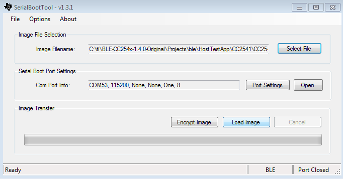

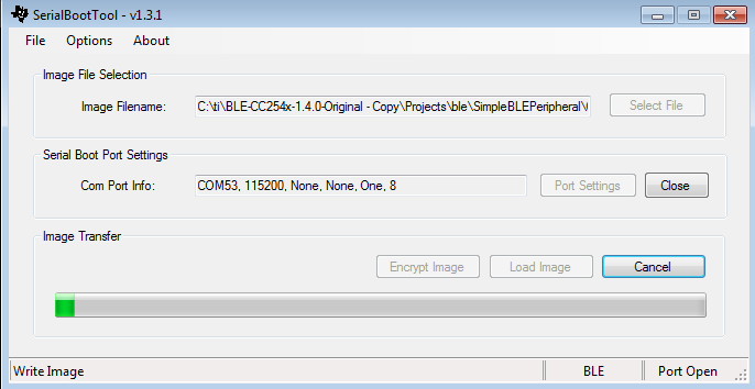

8. Open the SBDemo application (see the Tools Section Above) and choose the .bin file created in step 6. Select the correct COM port with the following and choose "Load Image."
9. The PC application will write the image and then verify that it was written successfully by reading it back. The device will then reboot into the SBL, realize that it has a valid image, and jump to the target image.

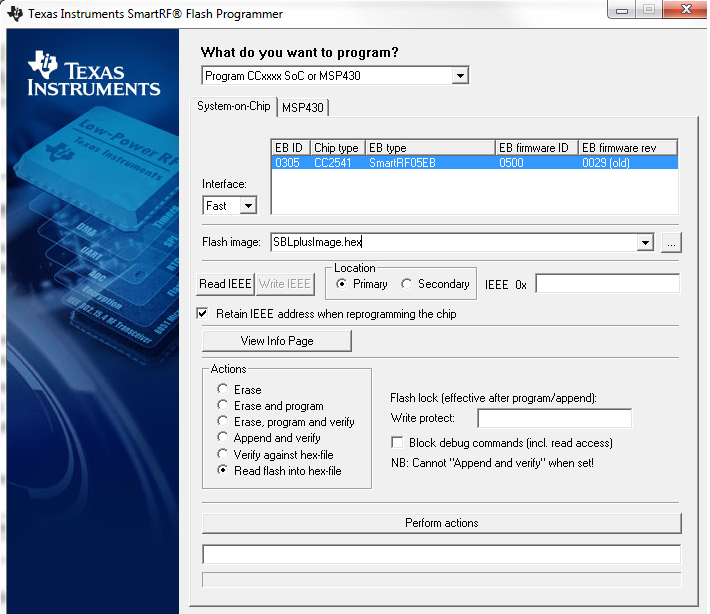

Generating a .hex of the SBL plus your Target Image.
This section will describe how to flash the device so that it contains the SBL followed in flash by a valid target image. The idea is that the target image will run initially, then when it needs to be updated, we will return to the SBL as described above and load a new image. The easiest way to do this is to perform a serial load of your target image to the bootloader as described above, then read back the the entire .hex file (SBL + target image). This can be accomplished using Flash Programmer with the following settings:

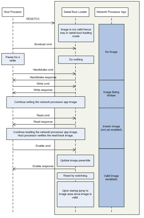

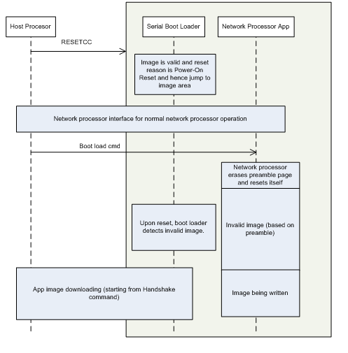

Boot Loading Sequences
The following two figures illustrate boot loading sequences and application image downloading sequences performed during boot loading. Note that the validity of the image is determined by checking the preamble (specifically CRC + CRC Shadow) of the application image area, which is updated only as the last transaction of image download sequence. If anything goes wrong during download of the image, such as power failure, the preamble of the image area is not updated and the SBL stays in boot loading mode waiting for boot loading command from host processor. When the image is valid, the boot loader jumps to the image area. Note that host processor reads back the application image to verify before enabling the image. The idea is to validate the written image without having to impose CRC checking in the serial boot loader. This was done to minimize the code size of the SBL. However, this increases the time taken for serial downloading since the entire image has to be read back.
Initial application image download sequence Consequent Application Image Download Sequence

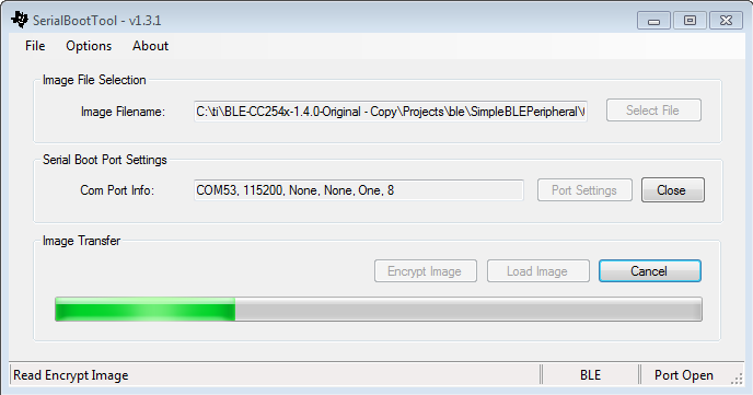

1. Open the Serial Boot Tool (see the Tools section above), select the unencrypted EBL target image, the correct COM port, use the following settings, and choose "Load Image:"
2. Once the image has finished loading onto the EBL encryprer, select "Encrypt Image" in the Serial Boot Tool. You may want to rename the "Image Filename" in order to prevent overwriting the original unencrypted image. The Serial Boot Tool will then start reading back the encrypted EBL target image:
3. Once the encryption is complete, the encrypted EBL target image is now placed in your PC's file system.
