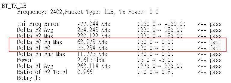

We are testing the RF but meet below issue:
Anyone know how to calibrate the RF freq? Or which document is talking about RF calibration?
Thanks.

From the test it looks like you have ~60 kHz frequency offset. That indicate that you are using load capacitors that are not tunes to the xtal you are using. Which CL is the xtal you are using spec'ed for and what are the values of the load caps you are using?
And the load caps, do they use the internal cap array or have they mounted load caps and turned the internal load caps off.
You have tune the Crystal frequency either by using Load Caps ( External) or Cap Array value ( in the software) to achieve better Frequency Accuracy.
You can use SmartRF Studio for Cap Array Value tuning. Please refer to SWRA640 for further details.
