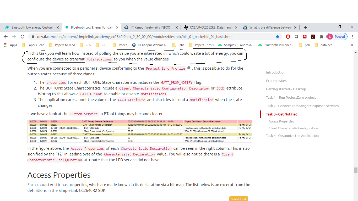

You can refer to Task 3 - Get Notified in tutorial dev.ti.com/.../ble_01_basic.html to use notification to send char or string to Andriod App.
Task 3 is for Btool , but i am using mobile device. However that is button state, whereas i am using the last service with characteristic (UUID starts with F0001131) i.e. the data service. How can i enable notifications for the data service as the service corresponding to data in BLE scanner app doesn't have N (notification enable feature in the UI) whereas button service has it.

HI please refer the screenshots below, these are from project zero link
I want to enable notifications and update them without input from mobile device. Please see it in the attached image. I have circled the concerned portion.
Also tell me if i am on right track to send large amount of data from LP to Android app.
I think using the notifications is the proper way to solve your issue.

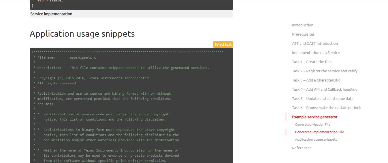

Further, i am following bluetooth low energy custom profile of this link http://software-dl.ti.com/lprf/simplelink_academy/modules/ble_01_custom_profile/ble_01_custom_profile.html.

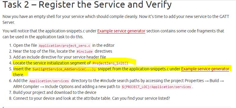

In this for completing steps 4 & 5 of task 2, where i have to add the SunlightService_AddService(); in the ProjectZero_init() section. Do i have to add the full generated appsnippets.c file in the project or only the code part of appsnippets.c in the ProjectZero_init() section or i just have to add the SunlightService_AddService(); along with other services as shown in the attachment.

Yes that's what i am asking, do i have to copy the whole code or just the line SunlightService_AddService();along with other services in the initialization section in projectzero.c . Please see the steps 4&5 of task2 in Bluetooth custom profile in this link software-dl.ti.com/.../ble_01_custom_profile.html How to implement these steps, is not given clearly in the tutorial.
Thanks for the link YK. The steps 4 & 5 are almost same for both the links. Can you please elaborate how to complete these steps as i am unable to find the service initialization segment of ProjectZero_init() and
Insert the SunlightService_AddService(...);
snippet from the application-snippets.c under Example service generator there.
My question is what part of code i have to insert and where exactly?
Please help me.
I usually do this manually and don't use Example service generator. I suggest you to following task 1 to 6 to make this work.
That is okay YK, i got it but my question is different. I am following task 1 to 6 only. I am just asking where in the code of project zero.c i have to insert the sunlighService_addservice(); from appsnippets.c and how much i have to add there?

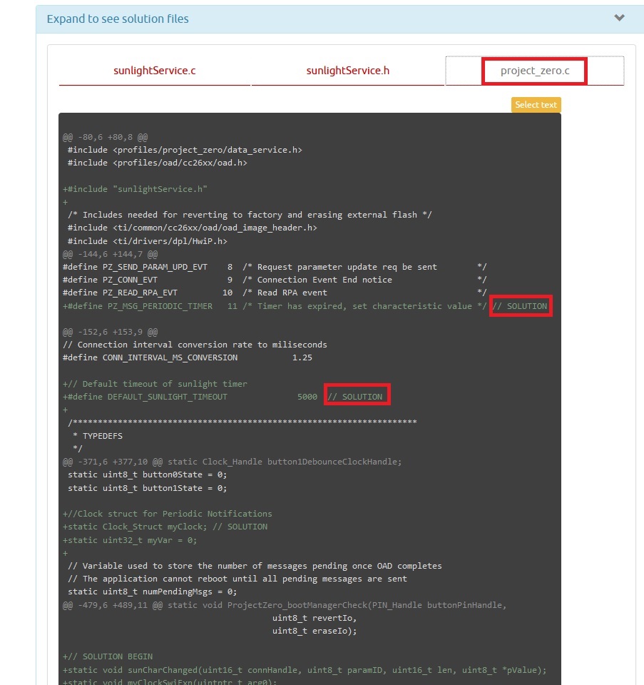

According to task 1, you can create sunlightService.c and sunlightService.h files in your project_zero and copy the source codes provide in task 1 to those two files. Then, added code by searching for SOLUTION in the project_zero tab to add related code into project_zero.c.
Okay, i got it. What about the step 5 in task 2?
How to implement it? Where exactly it is to be inserted?

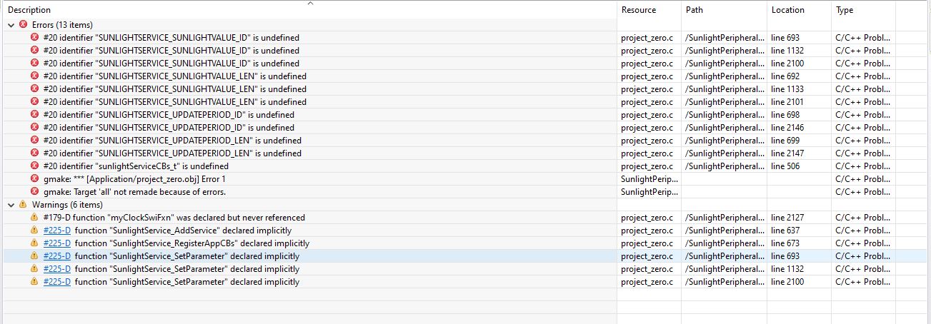

After adding the code blocks in Solution , i am getting the errors as shown in the attached image. Please let me know how to remove them as when i am including the #include "sunlightService.h" , i am getting an error that unable to open the file. I have created the sunlightService.h & sunlightService.c file in service folder in the application folder of the sunlightperipheral project.
1. You don't define SUNLIGHTSERVICE_SUNLIGHTVALUE_ID/SUNLIGHTSERVICE_SUNLIGHTVALUE_LEN/SUNLIGHTSERVICE_UPDATEPERIOD_ID/SUNLIGHTSERVICE_UPDATEPERIOD_LEN in sunlightService.h
2. You miss adding the following lines to your project_zero.c.
+// SOLUTION: Sunlight Service callback handler. +// The type Data_ServiceCBs_t is defined in sunlightService.h +static sunlightServiceCBs_t ProjectZero_Sunlight_ServiceCBs = { + .pfnChangeCb = sunCharChanged, + .pfnCfgChangeCb = NULL +};

Many Thanks for your suggestion, but i have added the code part in my project_zero.c that you have mentioned above in your reply. Please see the attached images and the code file for my project_zero.c.

I tried the steps and I can build the task without problem. I attach my sunlightService.c, sunlightService.h, and project_zero.c for your reference.
You can directly create sunlightservice.h & sunlightservice.c in the application folder
Add "SunlightService_AddService( selfEntity ); // SOLUTION" right after the line "DataService_AddService(selfEntity);" in ProjectZero_init().
Okay Thanks and what about the 6th step in the shown image, there is no application/services directory in my project as i have added the sunlightservice.c and sunlightservice.h directly in the application folder of the project. Do i need to add this path in the include options as its already added as shown in the second attached image.
If you added the sunlightservice.c and sunlightservice.h directly in the application folder of the project, you don't have to do this step.

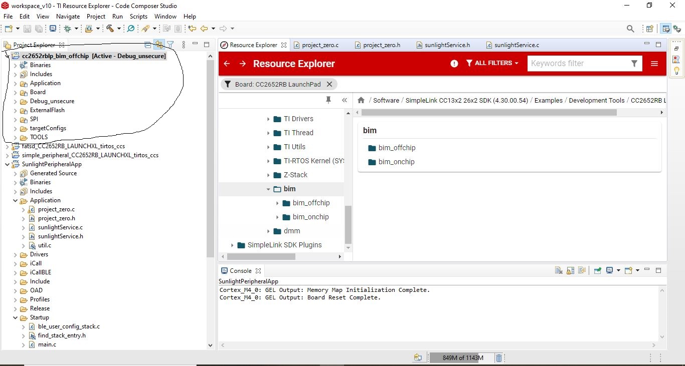

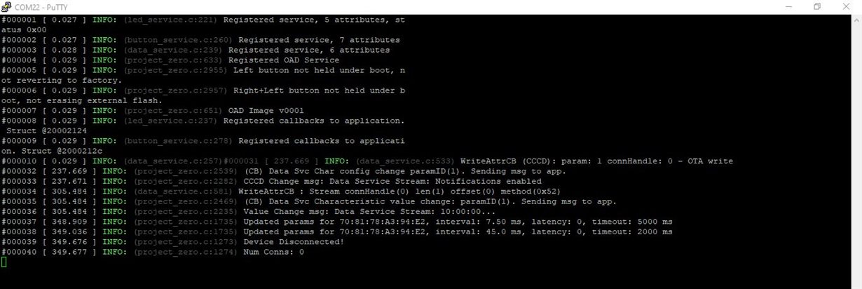

Please see the screenshot of my result and let me know whether its right? I am also facing one more issue, after some time the LP becomes undiscoverable in the BLE scanner app and it becomes available again when i download the program again onto the launchpad. Why is this problem, do i have to download the program every time when i have to connect with the smartphone?
It looks correct. My screenshot is from iOS and it might be different to Android system. Before you download project_zero to test it, do you also download BIM into your launchpad?
