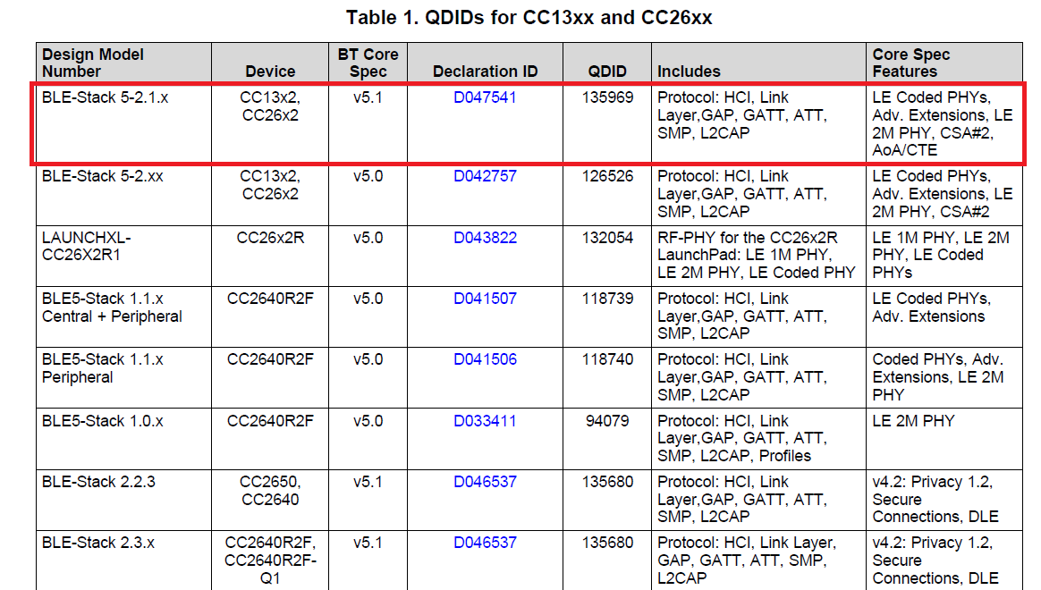

Hi team,
My customer use CC2642R and base on simplelink_cc13x2_26x2_sdk_4_20. However, their code fix to use 1Mbps only.
Now, they are doing Bluetooth certification. Could they use QDID 135969 ?

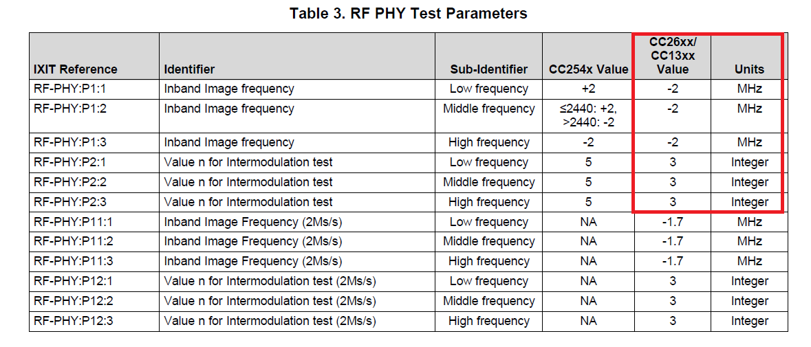

For RF PHY parameters, could they only use below items in red ? Thank you.
  • Hi Jerry,
    simplelink_cc13x2_26x2_sdk_4_20 release is covered by QDID 135969 with expiration date 2022-09-19 and TCRL 2018-2. For more information please refer to the application report SWRA601 - How to Qualify Your Bluetooth Low Energy Product.
    You do not require to use all the core spec features covered by a QDID to use it.
    You only need to verify that all the features required by your project are covered by the QDID. (If not additional testing will be required)
    In short, YES, QDID 135969 can be used here.
