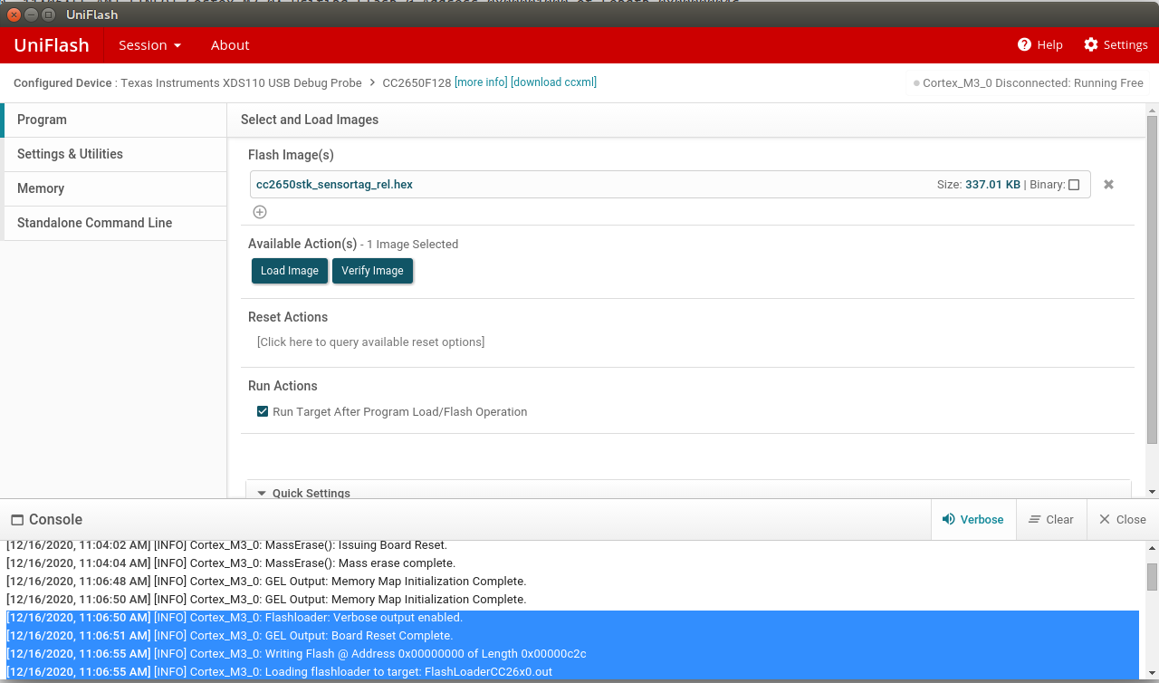

Hi TI E2E Community,
I am using the cc2650 Sensortag with a default pre-build image
ccs v7 on a ubuntu 16.04 64bit pc.
In uniflash I can able to load the image successfully.But there is no expected behaviour like led blinking and advertising mode(not detected while doing lescan/Simplelink SensorTag Mobile Application). But it was working before this situation.
Issue:
So I verified the image by enabling "verify image" on uniflash and i got the following verification errors:
[ERROR] Cortex_M3_0: File Loader: Verification failed: Values at address 0x0001E000 do not match Please verify target memory and memory map.
Full log has been attached
How to resolve this ?

  • Hi Nachiappan,
    Where do you get the cc2650stk_sensortag_rel.hex pre-build image, and what UNIFLASH CLI commands do you use in your Linux environment?  You may need CCSTUDIO v8 for full compatibility.  You are having difficulty verifying the last flash page which stores the CCFG and is typically contains configuration parameters for the ROM boot code, device hardware, and device firmware.  Please note the following resources:
    http://downloads.ti.com/ccs/esd/uniflash/docs/latest_qsguide.html#command-line-interface
    https://software-dl.ti.com/ccs/esd/uniflash/docs/v6_1/release_notes_6.1.0.html
    https://software-dl.ti.com/ccs/esd/documents/ccsv8_linux_host_support.html
    Ryan
  • Hi Ryan

    In uniflash 6.1.0 gui interface load the image successfully.But there is no expected behavior like led blinking and advertising mode(not detected while doing lescan/Simplelink SensorTag Mobile Application).

  • Can you read the device memory, and is it similar to your hex image contents?  Try using CCS  or a Windows PC to program the hex file and let us know if either of these options resolve the issue.
    Ryan
