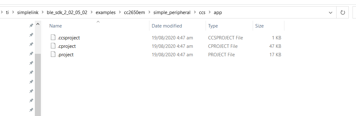

  • Hi Clement,
    I was not  be able to find the .projectspec file in the said directory
    I only have this files
    Please bear with me on my next questions :)
    1.) What should I modify in the Projectspec files?
    2.) Can I modify it so that if I imported the project files, it will load or copy all the linked files and directories instead of creating a virtual one?
    Thank you,
    Jonathan
    1) The modification should probably be done in the .project file. You will see in the file how to add a folder and link a file.
    If you are not used to work with projectspec file, I would recommend to first do the modification manually (i.e. without modifying the .project file).
    For additional questions related to the .project / projectspec file, I will kindly ask you to open a new thread.
    2) This can be done but I don't know if some side effects may appear (I never tried).
