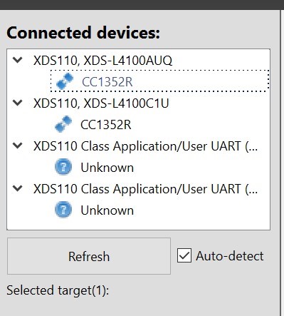

    I know SmartRF Flash Programmer 2 GUI can do this. But I would like to do this in SmartRF Flash Programmer 2 CLI and read MAC from multiple devices at the same time.
    Do you have any suggestion for it?
  • I just use ".\srfprog.exe -ls all"
    PS C:\Program Files (x86)\Texas Instruments\SmartRF Tools\Flash Programmer 2\bin> .\srfprog.exe -ls all
    Texas Instruments SmartRF Flash Programmer 2 v1.8.2-windows
     Connected devices:
     0 Device: XDS110, ID:XDS-L4100AUQ
               Chip: Unknown
     1 Device: XDS110, ID:XDS-L12002NP
               Chip: Unknown
     2 Device: XDS110 Class Application/User UART (COM11), ID:COM11
               Chip: Unknown
     3 Device: XDS110 Class Application/User UART (COM4), ID:COM4
               Chip: Unknown
    Then I input ".\srfprog -t lsidx(0) -r macsec" then get this result,
    PS C:\Program Files (x86)\Texas Instruments\SmartRF Tools\Flash Programmer 2\bin> .\srfprog -t lsidx(0) -r macsec
    ERROR: Not able to read device index from argument: lsidx 0
    Anyone know whats going on?
  • Aichi,
    I lost track of this thread. Is your customer still having issue?
    The method you are using is sound and should work, unless there is a problem on the connection between the Debug Probe and the device.
    One way to identify if this is the core issue is to issue the -ls command with the auto parameter, which indicates if the devices themselves are readable.
    command line said:
    C:\Program Files (x86)\Texas Instruments\SmartRF Tools\Flash Programmer 2\bin>srfprog -ls auto
     Connected devices:
     0 Device: XDS110, ID:XDS-L1100H6E
               Chip: CC2652R
      Chip Revision: E (2.1)
     1 Device: XDS110, ID:XDS-L1100H6L
               Chip: CC2652R
     2 Device: XDS110 Class Application/User UART (COM15), ID:COM15
               Chip: Unknown
     3 Device: Intel(R) Active Management Technology - SOL (COM3), ID:COM3
               Chip: Unknown
     4 Device: XDS110 Class Application/User UART (COM7), ID:COM7
               Chip: Unknown
    If the devices are unable to be properly identified, I would try some of the troubleshooting suggestions on this other thread.
    https://e2e.ti.com/support/wireless-connectivity/bluetooth/f/538/p/972778/3602221#3602221
