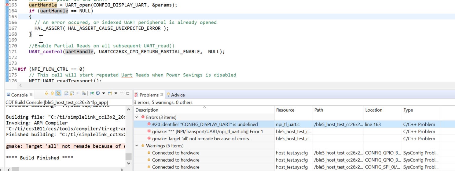

I remove Display (UART is removed automatically as well) since we do not have a display
Compile failures:
#20 identifier "CONFIG_DISPLAY_UART" is undefined npi_tl_uart.c /ble5_host_test_cc26x2r1lp_app/NPI/Transport/UART line 163 C/C++ Problem
Alternatively: in the past there was the Board.h file that made use of my custom board file. Is it possible to easily use that board file in the host_test project that was created with host_test.syscfg?
    Compile fails with same error as before:

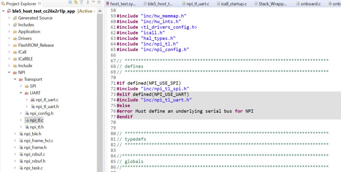

  • Hi Krs,
    Thanks for making the changes!
    If you are still receiving this error I suspect it's still because the NPI_USE_UART predefine symbol is still being used. This is because, npi_tl_uart.h is only pulled in if NPI_USE_UART is defined as seen in the following piece of code from npi_tl.c:
    #if defined(NPI_USE_SPI)
    #include "inc/npi_tl_spi.h"
    #elif defined(NPI_USE_UART)
    #include "inc/npi_tl_uart.h"
    #else
    #error Must define an underlying serial bus for NPI
    #endif
    I would suggest perform the steps in the following order:
    1. Verify in a text editor that both .opts are exactly like the changes you made and save.
    2. Create a new workspace and then import your project.
    3. Verify in npi_tl.c (located under NPI/Transport in your Project Explorer) line 71  that you see the #elif defined(NPI_USE_UART) is greyed out so that npi_tl_uart.h is not being used.
    Jenny
  • 1. Both .opts are the same.
    2. Created a new workspace and reimported a clean project
    3. npi_tl.c the NPI_USE_UART is greyed out (see pic)
    Error:

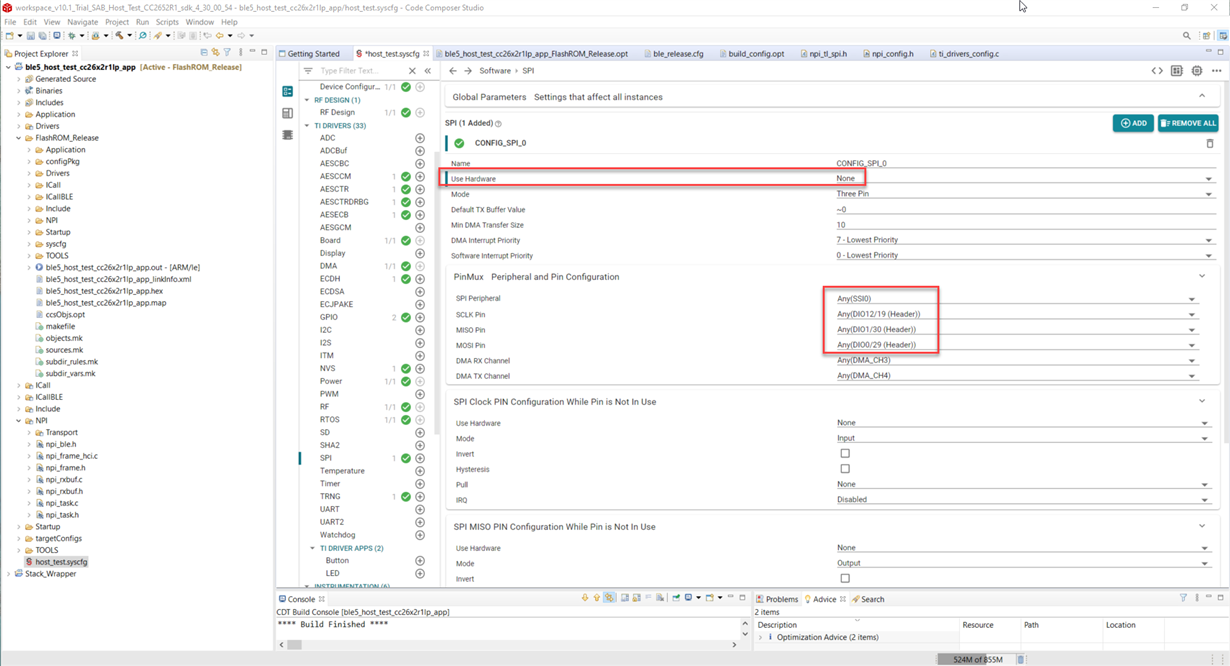

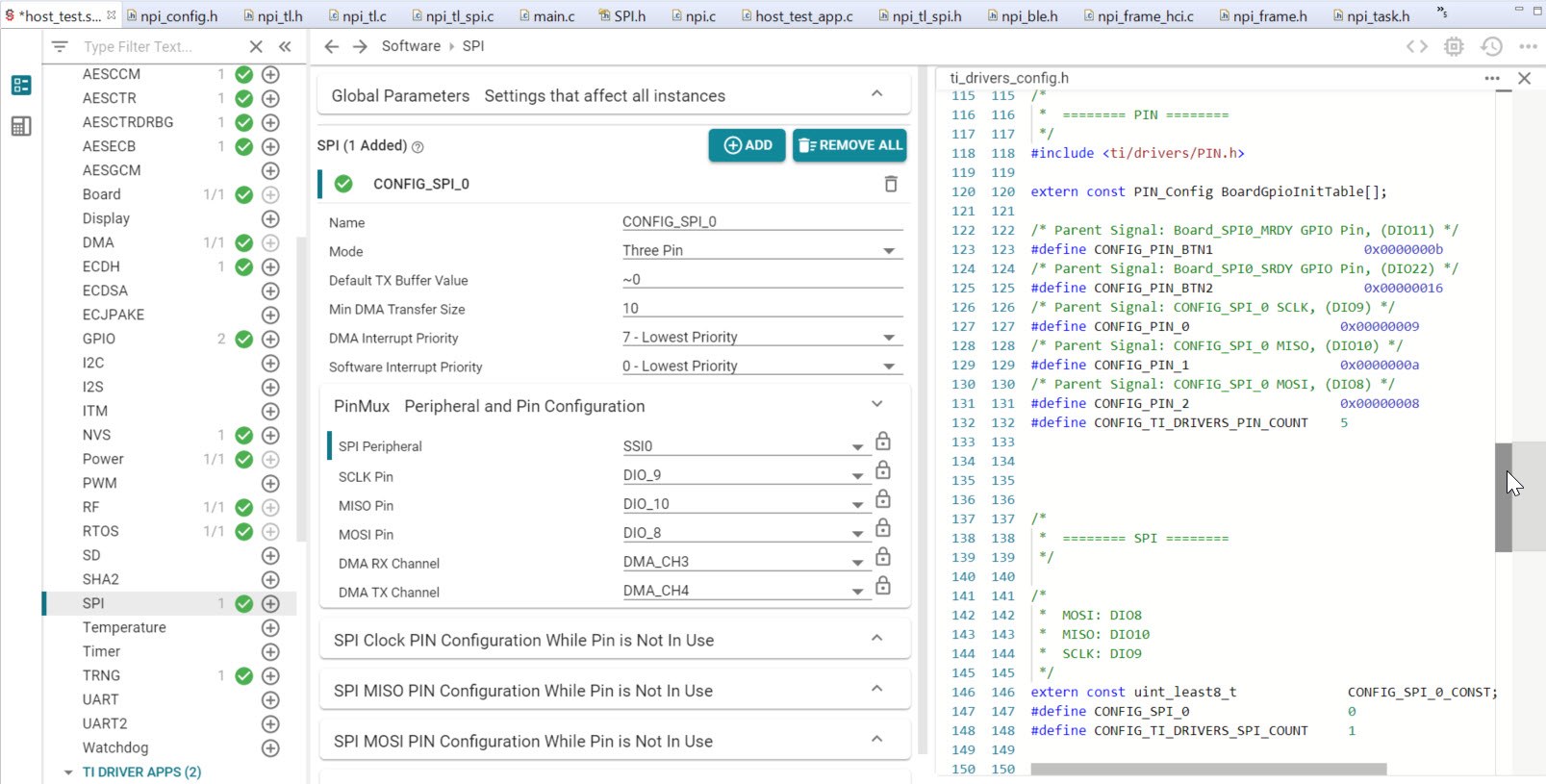

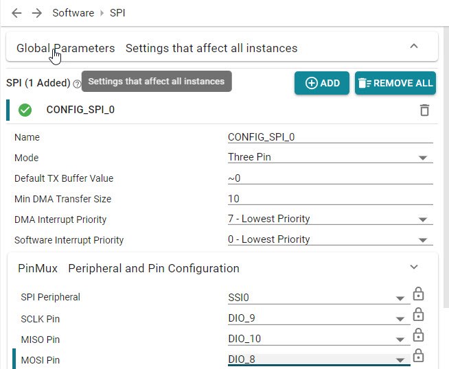

  • In the end I do not use UART so I just removed from Build the file npi_tl_uart.c, and got rid of the error above.

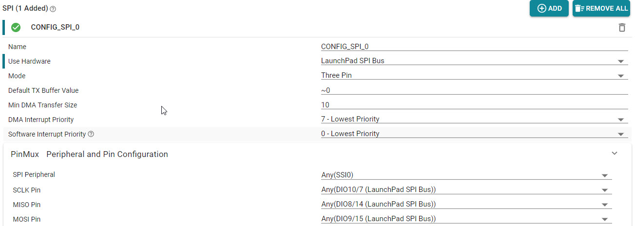

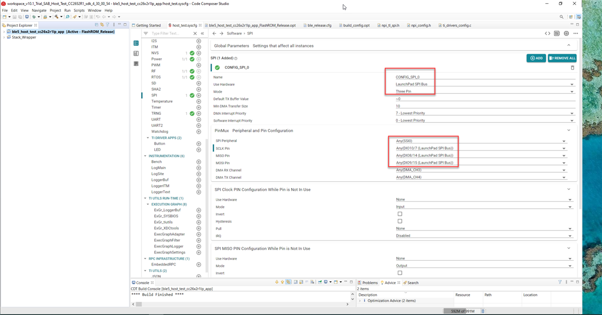

    Now I try to configure the SPI on my custom board.
    I have -DNPI_SPI_CONFIG=CONFIG_SPI_0
    As SPI I have... (As SPI Peripheral I can select only SSI0 - what does this setting do?)

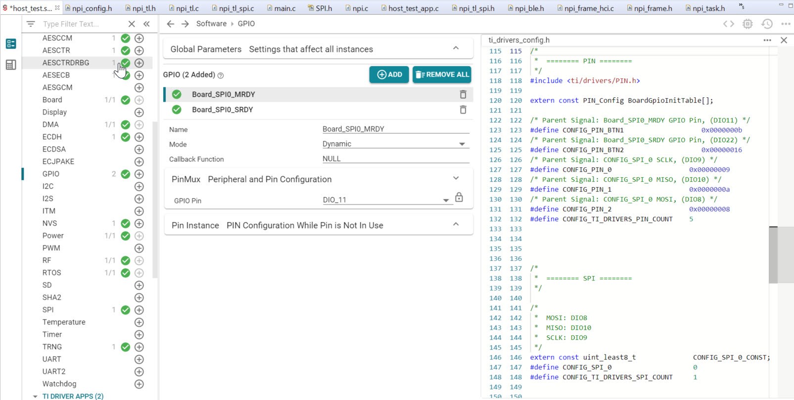

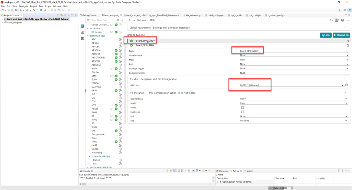

    At GPIO I added Master Ready and Slave Ready like this.

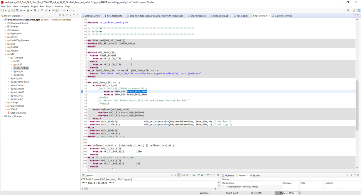

    In npi_config.h i have:
    #if !defined(NPI_SPI_CONFIG)
    #define NPI_SPI_CONFIG CONFIG_SPI_0
    #endif
    #ifndef NPI_FLOW_CTRL
      #ifdef POWER_SAVING
        #define NPI_FLOW_CTRL       1
      #else
        #define NPI_FLOW_CTRL       0
      #endif
    #elif !(NPI_FLOW_CTRL == 0) && !(NPI_FLOW_CTRL == 1)
      #error "NPI ERROR: NPI_FLOW_CTRL can only be assigned 0 (disabled) or 1 (enabled)"
    #endif
    #if (NPI_FLOW_CTRL == 1)
    	#ifdef NPI_USE_SPI
    		//#if (NPI_SPI_CONFIG == Board_SPI1)
    			#define MRDY_PIN Board_SPI0_MRDY
    			#define SRDY_PIN Board_SPI0_SRDY
    		//#else
    		//	#error "NPI ERROR: Board_SPI1 SPI module must be used for NPI."
    		//#endif
    		#define MRDY_PIN Board_PIN_BUTTON0
    		#define SRDY_PIN Board_PIN_BUTTON1
    	#endif
      #define SRDY_ENABLE()                   PIN_setOutputValue(hNpiHandshakePins, SRDY_PIN, 0) /* RTS low */
      #define SRDY_DISABLE()                  PIN_setOutputValue(hNpiHandshakePins, SRDY_PIN, 1) /* RTS high */
    #else
    #endif // NPI_FLOW_CTRL = 1
    Is this the correct way?
    Previous to sysconfig It was mandatory to use Board_SPI1, is this obsolete now?
    The NPI uses the SPI module pointed by the symbol Board_SPI1 (this is configured in npi_config.h). You cannot easily change this.
    However, you can safely modify the pins used by each SPI. You can also change the definition of the symbol Board_SPI1 (in Board.h) to use the SPI module you want (CC2640R2_LAUNCHXL_SPI0 or CC2640R2_LAUNCHXL_SPI1).  In that case be sure to properly define all the pins required by the SPI chosen :)

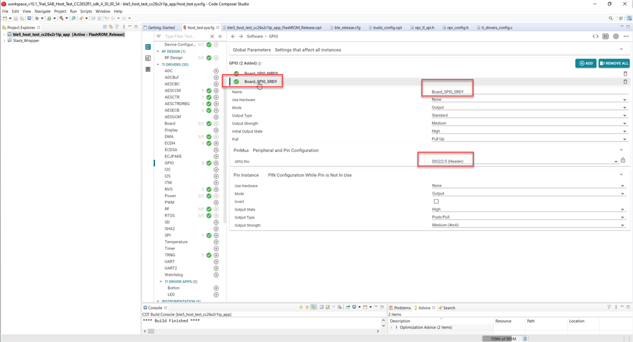

  • Hi Krs,
    I apologize for the delayed response.
    Yes you are correct. To use the MRDY_PIN and SRDY_PIN you need to replace your GPIO defines generated by SysConfig as you have already done. In addition, I believe you will need to define NPI_FLOW_CTRL as -DNPI_FLOW_CTR=1.
    Can you open your host_test.syscfg file within a text editor and locate the SPI portion please? Does it state that the instance is SPI1 or SP0? I believe it is still using SPI1, regardless of the name. I will also contact the person from the thread you are referencing to confirm this.
    Jenny
  • The initial thread for using SPI0 is this
    And below my sysconfig file:

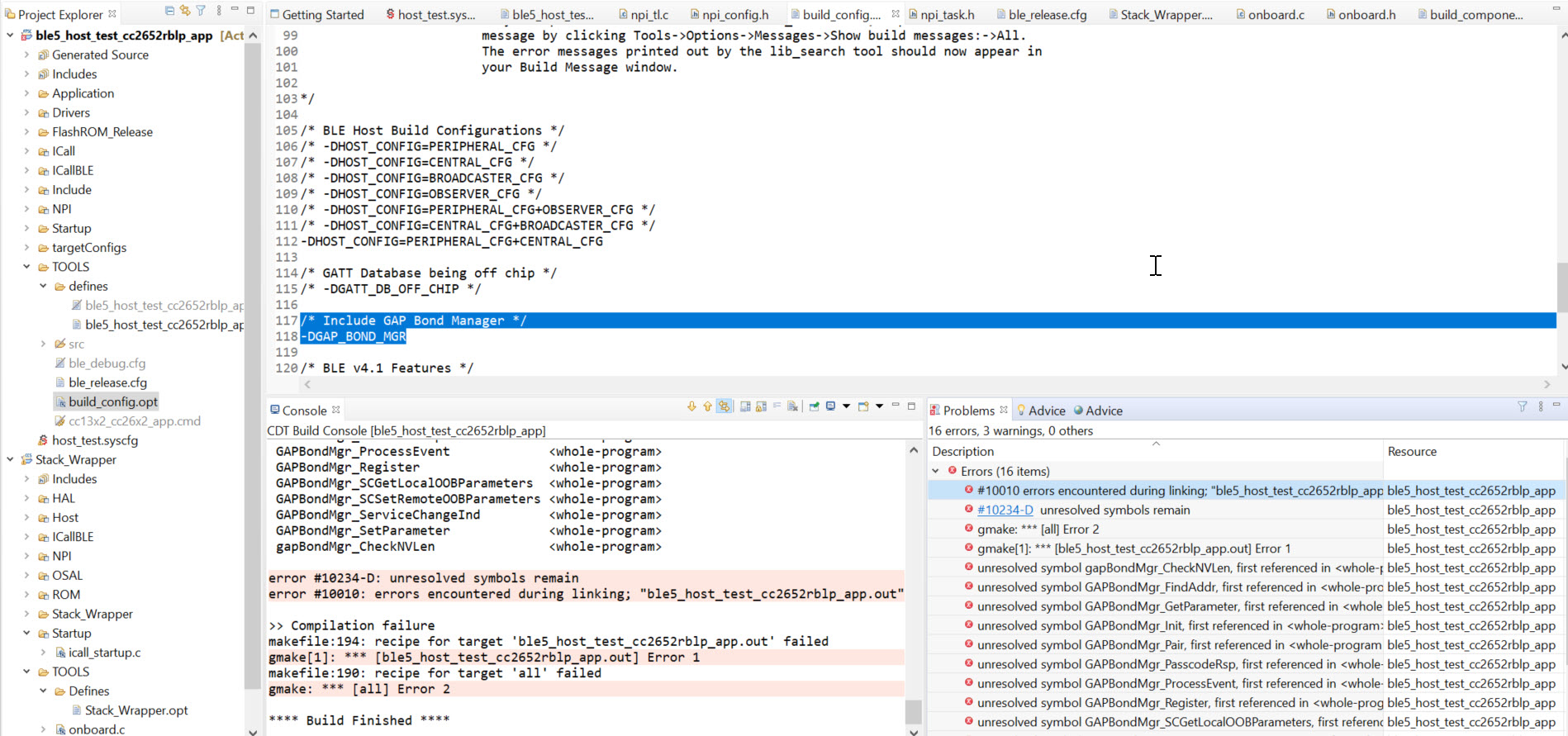

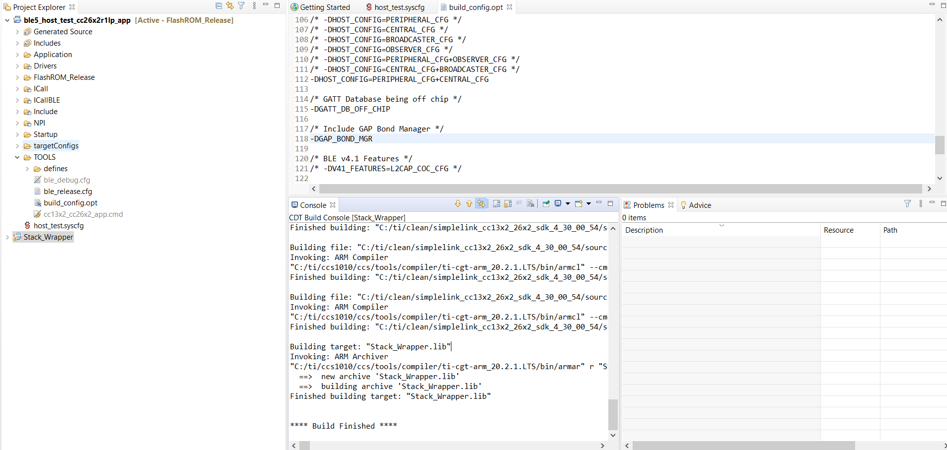

  • ok.... I still do not have SPI working (but I can check some things on Monday)
    but now a new issue! when I enable in build_config.opt
    /* Include GAP Bond Manager */
    -DGAP_BOND_MGR
    I get a lot of linker errors.
    (This is for a CC2652RB project, but in rest all things are the same)
  • Hi Krs,
    This linker error is due to the linker not being able to find the definition of these functions which I believe are located in gapbondmgr.c.
    It appears that my default build_config.opt appears different from yours. Regardless, I added the define -DGAP_BOND_MGR as seen in the image below and it builds without the linking errors present in your project.
    Can you please provide me with both your host_test.syscfg file and build_config.opt file please? I can drop both in my workspace and attempt to build.
    I had some additional questions:
    - I do see that you said this is for a CC2652RB project, but the rest are the same. I wanted to clarify, is this just referring to the modifications detailed in the previous posts on this thread?
    - To verify, the projectspec is also unmodified correct?

  • I mixed up the topics a little it seems... CC2642R1 compiles just fine!! The problem appears only on CC2652RB. I will open a new topic for that. https://e2e.ti.com/support/wireless-connectivity/bluetooth/f/538/t/969836
    Open issue remains the SPI not working. Can you please take a look on my host_test.sysconfig file to see if everything looks in order?

  • Let me replay with a general remark and if this is not helping I will address al your questions in order.
    Not 100% positive but no matter what I select as pin for SPI CLK, a clk is generated on default SPI0 CLK pin ... DIO10 !!
    These are the custom pins I try to set with clk on DIO9.
    These are he default pins for SPI 0 with  clock on DIO 10
    Below the generated Source/ti_driver_config.h and .c

     *  =============================== DMA ===============================
    #include <ti/drivers/dma/UDMACC26XX.h>
    #include <ti/devices/cc13x2_cc26x2/driverlib/udma.h>
    #include <ti/devices/cc13x2_cc26x2/inc/hw_memmap.h>
    UDMACC26XX_Object udmaCC26XXObject;
    const UDMACC26XX_HWAttrs udmaCC26XXHWAttrs = {
        .baseAddr        = UDMA0_BASE,
        .powerMngrId     = PowerCC26XX_PERIPH_UDMA,
        .intNum          = INT_DMA_ERR,
        .intPriority     = (~0)
    const UDMACC26XX_Config UDMACC26XX_config[1] = {
            .object         = &udmaCC26XXObject,
            .hwAttrs        = &udmaCC26XXHWAttrs,
     *  =============================== ECDH ===============================
    #include <ti/drivers/ECDH.h>
    #include <ti/drivers/ecdh/ECDHCC26X2.h>
    #define CONFIG_ECDH_COUNT 1
    ECDHCC26X2_Object ecdhCC26X2Objects[CONFIG_ECDH_COUNT];
     *  ======== ecdhCC26X2HWAttrs ========
    const ECDHCC26X2_HWAttrs ecdhCC26X2HWAttrs[CONFIG_ECDH_COUNT] = {
            .intPriority = (~0),
    const ECDH_Config ECDH_config[CONFIG_ECDH_COUNT] = {
        {   /* CONFIG_ECDH0 */
            .object         = &ecdhCC26X2Objects[CONFIG_ECDH0],
            .hwAttrs        = &ecdhCC26X2HWAttrs[CONFIG_ECDH0]
    const uint_least8_t CONFIG_ECDH0_CONST = CONFIG_ECDH0;
    const uint_least8_t ECDH_count = CONFIG_ECDH_COUNT;
     *  =============================== GPIO ===============================
    #include <ti/drivers/GPIO.h>
    #include <ti/drivers/gpio/GPIOCC26XX.h>
    #define CONFIG_GPIO_COUNT 2
     *  ======== gpioPinConfigs ========
     *  Array of Pin configurations
    GPIO_PinConfig gpioPinConfigs[] = {
        /* Board_SPI0_MRDY */
        GPIOCC26XX_DIO_11 | GPIO_CFG_IN_PU | GPIO_CFG_IN_INT_BOTH_EDGES,
        /* Board_SPI0_SRDY */
        GPIOCC26XX_DIO_22 | GPIO_CFG_OUT_STD | GPIO_CFG_OUT_STR_MED | GPIO_CFG_OUT_HIGH,
     *  ======== gpioCallbackFunctions ========
     *  Array of callback function pointers
     *  NOTE: Unused callback entries can be omitted from the callbacks array to
     *  reduce memory usage by enabling callback table optimization
     *  (GPIO.optimizeCallbackTableSize = true)
    GPIO_CallbackFxn gpioCallbackFunctions[] = {
        NULL,
        NULL,
    const uint_least8_t Board_SPI0_MRDY_CONST = Board_SPI0_MRDY;
    const uint_least8_t Board_SPI0_SRDY_CONST = Board_SPI0_SRDY;
     *  ======== GPIOCC26XX_config ========
    const GPIOCC26XX_Config GPIOCC26XX_config = {
        .pinConfigs = (GPIO_PinConfig *)gpioPinConfigs,
        .callbacks = (GPIO_CallbackFxn *)gpioCallbackFunctions,
        .numberOfPinConfigs = 2,
        .numberOfCallbacks = 2,
        .intPriority = (~0)
     *  =============================== NVS ===============================
    #include <ti/drivers/NVS.h>
    #include <ti/drivers/nvs/NVSCC26XX.h>
     *  NVSCC26XX Internal NVS flash region definitions
     * Place uninitialized char arrays at addresses
     * corresponding to the 'regionBase' addresses defined in
     * the configured NVS regions. These arrays are used as
     * place holders so that the linker will not place other
     * content there.
     * For GCC targets, the char arrays are each placed into
     * the shared ".nvs" section. The user must add content to
     * their GCC linker command file to place the .nvs section
     * at the lowest 'regionBase' address specified in their NVS
     * regions.
    #if defined(__TI_COMPILER_VERSION__) || defined(__clang__)
    static char flashBuf0[0x4000] __attribute__ ((retain, noinit, location(0x48000)));
    #elif defined(__IAR_SYSTEMS_ICC__)
    __no_init static char flashBuf0[0x4000] @ 0x48000;
    #elif defined(__GNUC__)
    __attribute__ ((section (".nvs")))
    static char flashBuf0[0x4000];
    #endif
    NVSCC26XX_Object nvsCC26XXObjects[1];
    static const NVSCC26XX_HWAttrs nvsCC26XXHWAttrs[1] = {
        /* CONFIG_NVSINTERNAL */
            .regionBase = (void *) flashBuf0,
            .regionSize = 0x4000
    #define CONFIG_NVS_COUNT 1
    const NVS_Config NVS_config[CONFIG_NVS_COUNT] = {
            .fxnTablePtr = &NVSCC26XX_fxnTable,
            .object = &nvsCC26XXObjects[0],
            .hwAttrs = &nvsCC26XXHWAttrs[0],
    const uint_least8_t CONFIG_NVSINTERNAL_CONST = CONFIG_NVSINTERNAL;
    const uint_least8_t NVS_count = CONFIG_NVS_COUNT;
     *  =============================== PIN ===============================
    #include <ti/drivers/PIN.h>
    #include <ti/drivers/pin/PINCC26XX.h>
    #define CONFIG_PIN_COUNT 5
    const PIN_Config BoardGpioInitTable[CONFIG_PIN_COUNT + 1] = {
        /* Parent Signal: Board_SPI0_MRDY GPIO Pin, (DIO11) */
        CONFIG_PIN_BTN1 | PIN_INPUT_EN | PIN_PULLUP | PIN_IRQ_DIS,
        /* Parent Signal: Board_SPI0_SRDY GPIO Pin, (DIO22) */
        CONFIG_PIN_BTN2 | PIN_GPIO_OUTPUT_EN | PIN_GPIO_HIGH | PIN_PUSHPULL | PIN_DRVSTR_MED,
        /* Parent Signal: CONFIG_SPI_0 SCLK, (DIO9) */
        CONFIG_PIN_0 | PIN_INPUT_EN | PIN_PULLDOWN | PIN_IRQ_DIS,
        /* Parent Signal: CONFIG_SPI_0 MISO, (DIO10) */
        CONFIG_PIN_1 | PIN_GPIO_OUTPUT_EN | PIN_GPIO_HIGH | PIN_PUSHPULL | PIN_DRVSTR_MED,
        /* Parent Signal: CONFIG_SPI_0 MOSI, (DIO8) */
        CONFIG_PIN_2 | PIN_INPUT_EN | PIN_NOPULL | PIN_IRQ_DIS,
        PIN_TERMINATE
    const PINCC26XX_HWAttrs PINCC26XX_hwAttrs = {
        .swiPriority = 0
     *  =============================== Power ===============================
    #include <ti/drivers/Power.h>
    #include <ti/drivers/power/PowerCC26X2.h>
    #include "ti_drivers_config.h"
    extern void PowerCC26XX_standbyPolicy(void);
    extern bool PowerCC26XX_calibrate(unsigned int);
    const PowerCC26X2_Config PowerCC26X2_config = {
        .enablePolicy             = true,
        .policyInitFxn            = NULL,
        .policyFxn                = PowerCC26XX_standbyPolicy,
        .calibrateFxn             = PowerCC26XX_calibrate,
        .calibrateRCOSC_LF        = false,
        .calibrateRCOSC_HF        = false,
        .enableTCXOFxn            = NULL
     *  =============================== RF Driver ===============================
    #include <ti/drivers/rf/RF.h>
     * Platform-specific driver configuration
    const RFCC26XX_HWAttrsV2 RFCC26XX_hwAttrs = {
        .hwiPriority        = (~0),
        .swiPriority        = (uint8_t)0,
        .xoscHfAlwaysNeeded = true,
        .globalCallback     = NULL,
        .globalEventMask    = 0
     *  =============================== SPI DMA ===============================
    #include <ti/drivers/SPI.h>
    #include <ti/drivers/spi/SPICC26X2DMA.h>
    #define CONFIG_SPI_COUNT 1
     *  ======== spiCC26X2DMAObjects ========
    SPICC26X2DMA_Object spiCC26X2DMAObjects[CONFIG_SPI_COUNT];
     *  ======== spiCC26X2DMAHWAttrs ========
    const SPICC26X2DMA_HWAttrs spiCC26X2DMAHWAttrs[CONFIG_SPI_COUNT] = {
        /* CONFIG_SPI_0 */
            .baseAddr = SSI0_BASE,
            .intNum = INT_SSI0_COMB,
            .swiPriority = 0,
            .powerMngrId = PowerCC26XX_PERIPH_SSI0,
            .defaultTxBufValue = ~0,
            .rxChannelBitMask = 1<<UDMA_CHAN_SSI0_RX,
            .txChannelBitMask = 1<<UDMA_CHAN_SSI0_TX,
            .minDmaTransferSize = 10,
            .mosiPin = IOID_8,
            .misoPin = IOID_10,
            .clkPin  = IOID_9,
            .csnPin  = PIN_UNASSIGNED
     *  ======== SPI_config ========
    const SPI_Config SPI_config[CONFIG_SPI_COUNT] = {
        /* CONFIG_SPI_0 */
            .fxnTablePtr = &SPICC26X2DMA_fxnTable,
            .object = &spiCC26X2DMAObjects[CONFIG_SPI_0],
            .hwAttrs = &spiCC26X2DMAHWAttrs[CONFIG_SPI_0]
    const uint_least8_t CONFIG_SPI_0_CONST = CONFIG_SPI_0;
    const uint_least8_t SPI_count = CONFIG_SPI_COUNT;
     *  =============================== TRNG ===============================
    #include <ti/drivers/TRNG.h>
    #include <ti/drivers/trng/TRNGCC26XX.h>
    #define CONFIG_TRNG_COUNT 1
    TRNGCC26XX_Object trngCC26XXObjects[CONFIG_TRNG_COUNT];
     *  ======== trngCC26XXHWAttrs ========
    static const TRNGCC26XX_HWAttrs trngCC26XXHWAttrs[CONFIG_TRNG_COUNT] = {
            .swiPriority = 0,
            .samplesPerCycle = 240000
    const TRNG_Config TRNG_config[CONFIG_TRNG_COUNT] = {
        {   /* CONFIG_TRNG_0 */
            .object         = &trngCC26XXObjects[CONFIG_TRNG_0],
            .hwAttrs        = &trngCC26XXHWAttrs[CONFIG_TRNG_0]
    const uint_least8_t CONFIG_TRNG_0_CONST = CONFIG_TRNG_0;
    const uint_least8_t TRNG_count = CONFIG_TRNG_COUNT;
     *  =============================== Temperature ===============================
    #include <ti/drivers/Temperature.h>
    #include <ti/drivers/temperature/TemperatureCC26X2.h>
    const TemperatureCC26X2_Config TemperatureCC26X2_config = {
    #include <stdbool.h>
    #include <ti/devices/cc13x2_cc26x2/driverlib/ioc.h>
    #include <ti/devices/cc13x2_cc26x2/driverlib/cpu.h>
     *  ======== Board_sendExtFlashByte ========
    void Board_sendExtFlashByte(PIN_Handle pinHandle, uint8_t byte)
        uint8_t i;
        /* SPI Flash CS */
        PIN_setOutputValue(pinHandle, IOID_20, 0);
        for (i = 0; i < 8; i++) {
            PIN_setOutputValue(pinHandle, IOID_10, 0);  /* SPI Flash CLK */
            /* SPI Flash MOSI */
            PIN_setOutputValue(pinHandle, IOID_9, (byte >> (7 - i)) & 0x01);
            PIN_setOutputValue(pinHandle, IOID_10, 1);  /* SPI Flash CLK */
             * Waste a few cycles to keep the CLK high for at
             * least 45% of the period.
             * 3 cycles per loop: 8 loops @ 48 Mhz = 0.5 us.
            CPUdelay(8);
        PIN_setOutputValue(pinHandle, IOID_10, 0);  /* CLK */
        PIN_setOutputValue(pinHandle, IOID_20, 1);  /* CS */
         * Keep CS high at least 40 us
         * 3 cycles per loop: 700 loops @ 48 Mhz ~= 44 us
        CPUdelay(700);
     *  ======== Board_wakeUpExtFlash ========
    void Board_wakeUpExtFlash(void)
        PIN_Config extFlashPinTable[] = {
            /* SPI Flash CS */
            IOID_20 | PIN_GPIO_OUTPUT_EN | PIN_GPIO_HIGH | PIN_PUSHPULL |
                    PIN_INPUT_DIS | PIN_DRVSTR_MED,
            PIN_TERMINATE
        PIN_State extFlashPinState;
        PIN_Handle extFlashPinHandle = PIN_open(&extFlashPinState, extFlashPinTable);
         *  To wake up we need to toggle the chip select at
         *  least 20 ns and ten wait at least 35 us.
        /* Toggle chip select for ~20ns to wake ext. flash */
        PIN_setOutputValue(extFlashPinHandle, IOID_20, 0);
        /* 3 cycles per loop: 1 loop @ 48 Mhz ~= 62 ns */
        CPUdelay(1);
        PIN_setOutputValue(extFlashPinHandle, IOID_20, 1);
        /* 3 cycles per loop: 560 loops @ 48 Mhz ~= 35 us */
        CPUdelay(560);
        PIN_close(extFlashPinHandle);
     *  ======== Board_shutDownExtFlash ========
    void Board_shutDownExtFlash(void)
         *  To be sure we are putting the flash into sleep and not waking it,
         *  we first have to make a wake up call
        Board_wakeUpExtFlash();
            /* SPI Flash CS*/
            /* SPI Flash CLK */
            IOID_10 | PIN_GPIO_OUTPUT_EN | PIN_GPIO_LOW | PIN_PUSHPULL |
            IOID_9 | PIN_GPIO_OUTPUT_EN | PIN_GPIO_LOW | PIN_PUSHPULL |
            /* SPI Flash MISO */
            IOID_8 | PIN_INPUT_EN | PIN_PULLDOWN,
            PIN_TERMINATE
        uint8_t extFlashShutdown = 0xB9;
        Board_sendExtFlashByte(extFlashPinHandle, extFlashShutdown);
    #include <ti/drivers/Board.h>
     *  ======== Board_initHook ========
     *  Perform any board-specific initialization needed at startup.  This
     *  function is declared weak to allow applications to override it if needed.
    void __attribute__((weak)) Board_initHook(void)
     *  ======== Board_init ========
     *  Perform any initialization needed before using any board APIs
    void Board_init(void)
        /* ==== /ti/drivers/Power initialization ==== */
        Power_init();
        PowerCC26X2_enableHposcRtcCompensation();
        /* ==== /ti/drivers/PIN initialization ==== */
        if (PIN_init(BoardGpioInitTable) != PIN_SUCCESS) {
            /* Error with PIN_init */
            while (1);
        /* ==== /ti/devices/CCFGTemplateInit initialization ==== */
        OSC_HPOSCInitializeFrequencyOffsetParameters();
        /* ==== /ti/drivers/RF initialization ==== */
        RF_enableHPOSCTemperatureCompensation();
        Board_shutDownExtFlash();
        Board_initHook();
  • Hi Krs,
    Thank you for posting this. At least based on your first image (if the pins in your first image are your expected pins), the generated files appear to generate the correct SPI pins so I don't think this is the issue that's causing SPI not to work in your setup.
    Jenny
  • I found not place where to say if my SPI is slave or master? Can you please point me to the right location where this is done?
  • At least based on your first image (if the pins in your first image are your expected pins), the generated files appear to generate the correct SPI pins so I don't think this is the issue that's causing SPI not to work in your setup.
    Even though the pins seem to be generated just fine... since there are problems with custom board settings
     could this mean there could be problems with pin assignments as well?
  • Hi Krs,
    This could be the case. However, comparing your SysConfig settings and the generated pins they look correct. I would imagine that the pins could only be wrong if you had saved the file, exited CCS, and re-opened CCS and then tried to debug (which by default will rebuild the project). If you build and debug right after making the SysConfig changes (without closing and re-opening CCS), I don't believe the pin assignments would be wrong especially since the project is referencing whatever is generated into ti_driver_config.h/.c.
    Jenny
  • I have managed to completely separate the CLK line between master and slave. I can see that TI chip starts clocking (even if it should be slave) on DIO10 which is the default SPI CLK pin on SSI0).
    I do not know what else to try.
  • Hi Krs,
    Based on this information, it seems like the configuration is still defaulting to the DIO10 SCLK (and I'm assuming DIO9 MOSI, DIO8 MISO based on your screenshots from the previous post). I am still awaiting an answer based on the SysConfig not properly saving which you brought up in the other post. However, with these default pin configurations (DIO10 SCLK, DIO9 MOSI, DIO8 MISO), do you see communication over the MISO and MOSI line? If possible, can you post a capture of a logic analyzer?
    In addition, were you able to try the other suggestions in the previous post? Specifically seeing if the code will enter the NPI SPI transmit callback?
    Can you also describe the process of how you initiate communicate on the master side?
    Another thing we can possibly try is introducing a SS, so to do this the slave (example project running NPI) SPI mode will be Four Pin SS Active Low which will introduce a SS pin. On your master side, create a GPIO pin that will serve as your SS pin that is connected to the slave SS pin. After doing so, to transmit on master use something similar to the following code:
        /* Set select low to indicate ready to transmit */
        GPIO_write(EXAMPLE_SELECT_PIN, 0);
        /* Perform SPI transfer */
        transferOK = SPI_transfer(spiHandle, &spiTransaction);
        /* Set select high to indicate transmit finished */
        GPIO_write(EXAMPLE_SELECT_PIN, 1);
    Jenny
  • Hello Jenny,
    In order to perform the debug you suggested I had to switch a little what I am doing. I am no longer using my custom board, I am using the Launchpad instead. I have an ATMEL controller connected with wires to launchpads CC26X2R1 SPI pins (DIOs). (I have removed all jumpers in the top row on launchpad expect 5V, 3.3V and GND)
    I have an unmodified host_test project where I disable UART and enable SPI and POWER_SAVING(for NPI_FLOW_CONTROL).
    -DNPI_USE_SPI
    -DxNPI_USE_UART
    -DPOWER_SAVING
    I set my SPI pins in .syscfg tool, Flash the TI, start ATMEL as master SPI and try and capture with SALEAE.
    Here my SPI modifications:
    // SPI Slave baud rate
    #define SPI_SLAVE_BAUD_RATE 2000000
    #define NPI_SPI_HEADER_LEN 3
    Now I have 2 usecases: Where I use the suggested SPI pins and where I use some other Header pins.
    1: If I use the default pins for SPI 0 CLK, MISO and MOSI, to me it seems that the launchpad behaves like a master?! and want to CLK and send some data.
    Enclosed the SALEA captures.
    2. If I use some other free pins for SPI 0 CLK,MISO,MOSI, TI does not clock, but it does not assert S2M line.
    ATMEL to LaunchpadCC26X2R1 Default SPI pins_BLE SPI 20 MHz, 20 M Samples.zip
    ATMEL to LaunchpadCC26X2R1 Header SPI pins_BLE SPI 20 MHz, 20 M Samples.zip
