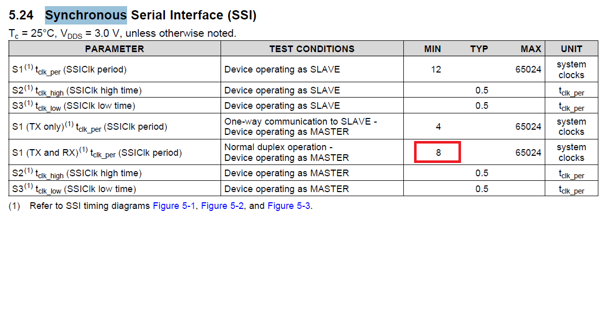

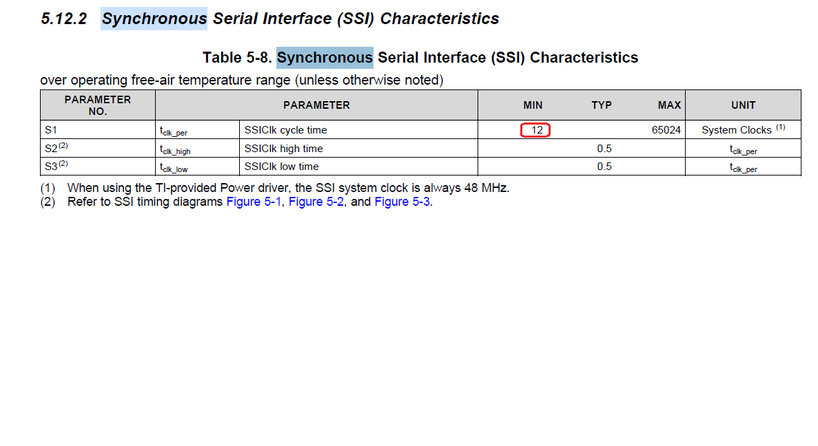

My customer used CC2640R2 and move to CC2642. They find out the range of SPI bit rate is different between CC2640R2 and CC2642 as below. Customer want to know 1) if CC2642 can support SPI to 6MHz the same as CC2640R2 ?  2) what's the limitation of the SPI bit rate on CC2642 ?
For CC2640R2, the max. rate can be 48MHz/8 = 6MHz.
For CC2642, the max. rate only can be 48MHz/12=4Mhz.
