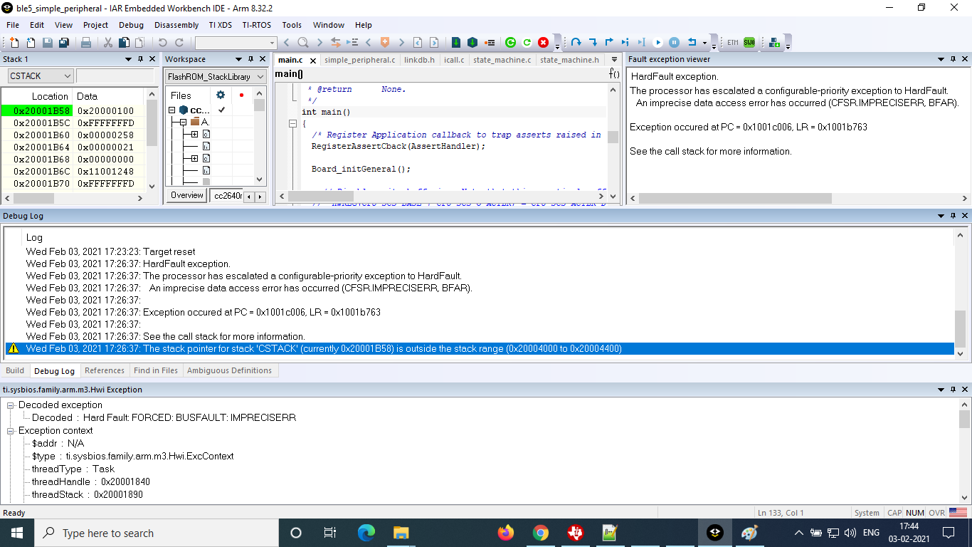

  • Hi Ammar,
    I debugged the issue and found like it a Stack overflow. But I could not pin point at what line of the code got the stacj overflow. Also, I am getting this when the device got disconnected from App. Can you suggest any methods to root cause the issue?

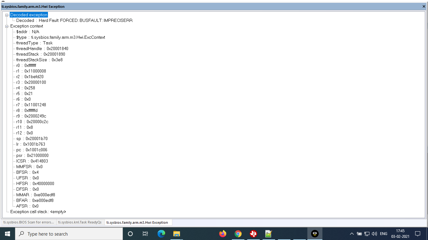

  • Hi Ammar,
    I am attaching some screenshot of my debug window. Can you check this and let me know your comments. It seems to be an "Oveclocked chip" error. How can I solve this issue.
  • Hi Anjaly,
    Sorry for the delay. Since the IMPRECISERR busfault is reported, you should try manually disabling buffered writes.
    The below excerpt is taken from the Debugger's guide linked above:
    If the exception is IMPRECISERR, PRECISERR can be forced by manually disabling buffered writes. Set CPU_SCS:ACTRL:DISDEFWBUF to 1, by either manually setting the bit in the register view in the debugger or by including <hw_cpu_scs.h> from Driverlib and calling the following.
    #include <ti/devices/cc26x0r2/inc/hw_cpu_scs.h>
    int main()
        // Disable write-buffering. Note that this negatively affect performance.
        HWREG(CPU_SCS_BASE + CPU_SCS_O_ACTLR) = CPU_SCS_ACTLR_DISDEFWBUF;
    Try this so we find out which memory address was written to when the exception was raised. This will give us an idea of a next step and see if your application is writing to this address or it's if it's used by the stack and we can go from there.
