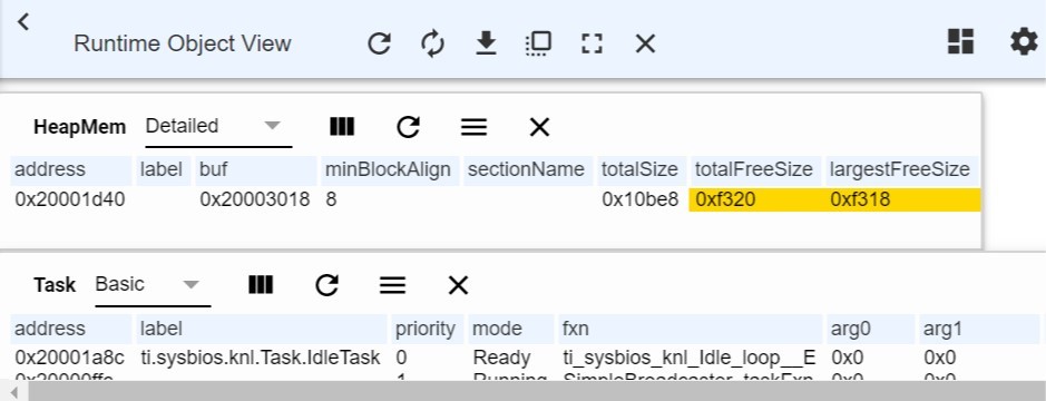

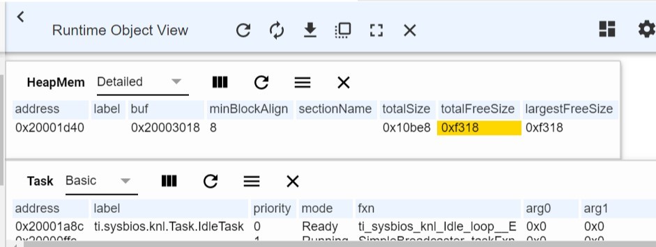

Hi Team,
SDK version: 4.30
My customer observed a memory leak of simple_broadcaster example, and it can be reproduced by the following steps:
1.Add GAP_ADV_EVT_MASK_END event:
// Set event mask
status = GapAdv_setEventMask(advHandleLegacy,
                    GAP_ADV_EVT_MASK_START_AFTER_ENABLE | GAP_ADV_EVT_MASK_END |
                    GAP_ADV_EVT_MASK_END_AFTER_DISABLE |
                     GAP_ADV_EVT_MASK_SET_TERMINATED);
2.Add "case GAP_EVT_ADV_END" in SimpleBroadcaster_processAdvEvent:
static bool SimpleBroadcaster_processAdvEvent(sbGapAdvEventData_t *pEventData)
        bool safeToDealloc = TRUE;
        static volatile uint8_t test;
       switch (pEventData->event)
                 case GAP_EVT_ADV_START_AFTER_ENABLE:
                               Display_printf(dispHandle, 2, 0, "Advertising");
                               break;
                 case GAP_EVT_INSUFFICIENT_MEMORY:
                              safeToDealloc = FALSE;
                              break;
                 case GAP_EVT_ADV_END:
                             test++;
                             break;
                default:
                         // Do nothing.
                            break;
       return(safeToDealloc);

3.Add breakpoints in line "test++;"
4.Everytime hits the breakpoint, we'll see a memory leak, please check the images below:

  • Hi Viki,
    Thank you for your patience. I get assigned to this thread only this morning.
    The problem seems to be due to not properly freeing the buffer passed within pEventData.
    Here is a code snippet that should solve your issue:
                                   break;
                                  break;
                                 test++;
                                 ICall_free(pEventData->pBuf); // fixed memory leak
                                 break;
                    default:
                             // Do nothing.
                                break;
  • Hi Clément,

  • Hi Viki - I think you're still going to leak memory, just not as fast.  I found the same memory leak occurred for the events:
    • GAP_EVT_ADV_START_AFTER_ENABLE
    • GAP_EVT_ADV_END_AFTER_DISABLE
    • GAP_EVT_ADV_START
    • GAP_EVT_ADV_END
    Basically all the cases where gap.h says to cast pBuf as a uint8_t to find the advertising handle, what they meant was that pBuf is a pointer to a uint8_t holding the advertising handle and you are responsible for freeing it.  So the example you're showing still leaks a byte from the GAP_EVT_ADV_START_AFTER_ENABLE case.
    I'm glad someone else has had the same issue, I recorded my experience here: e2e.ti.com/.../3600553
