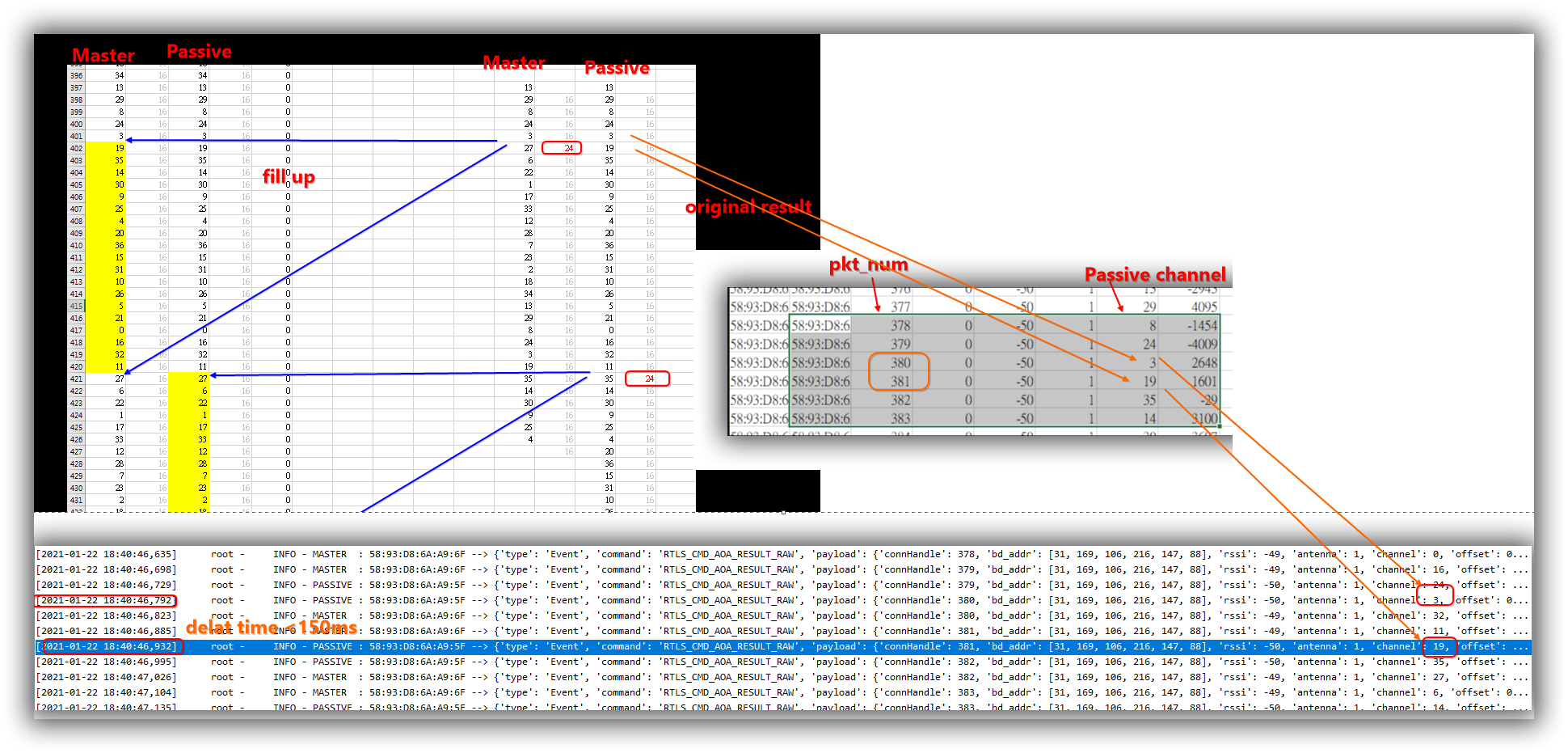

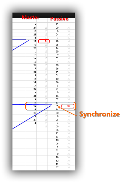

sometimes we can find the channel hopping discontinuity in IQ RAW data file. so i do a test to combine RF path of Master/Passive with divider. They will share the same patch ANT to catch IQ data.
even some AOA pkt are corrupted, Master/Passive should also have the same channel sequence.

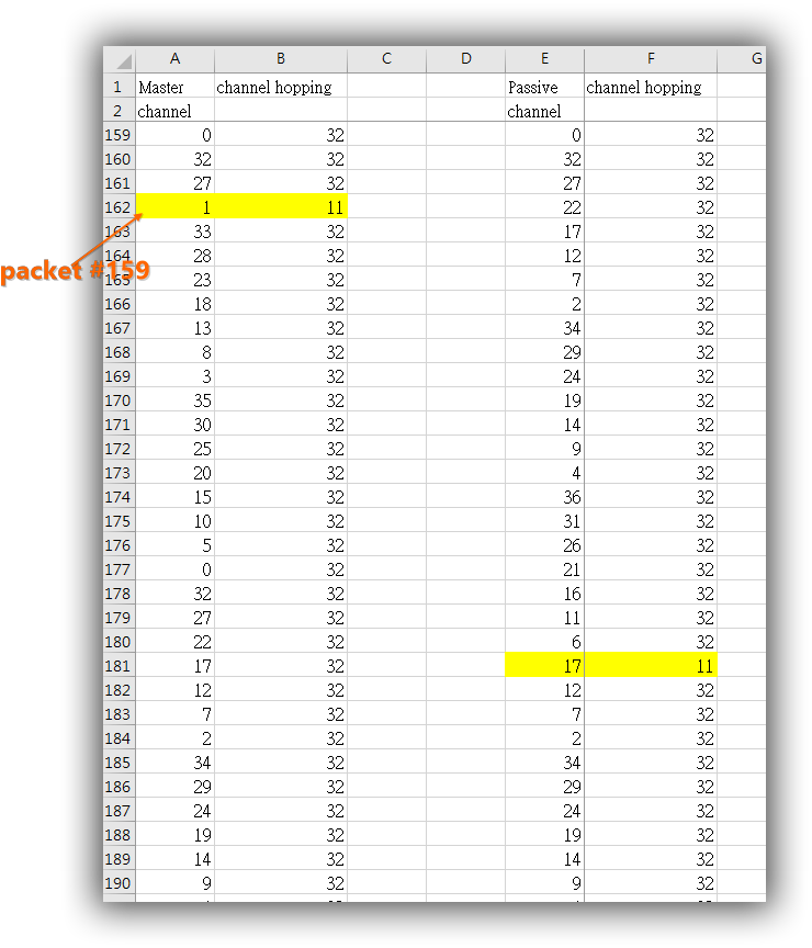

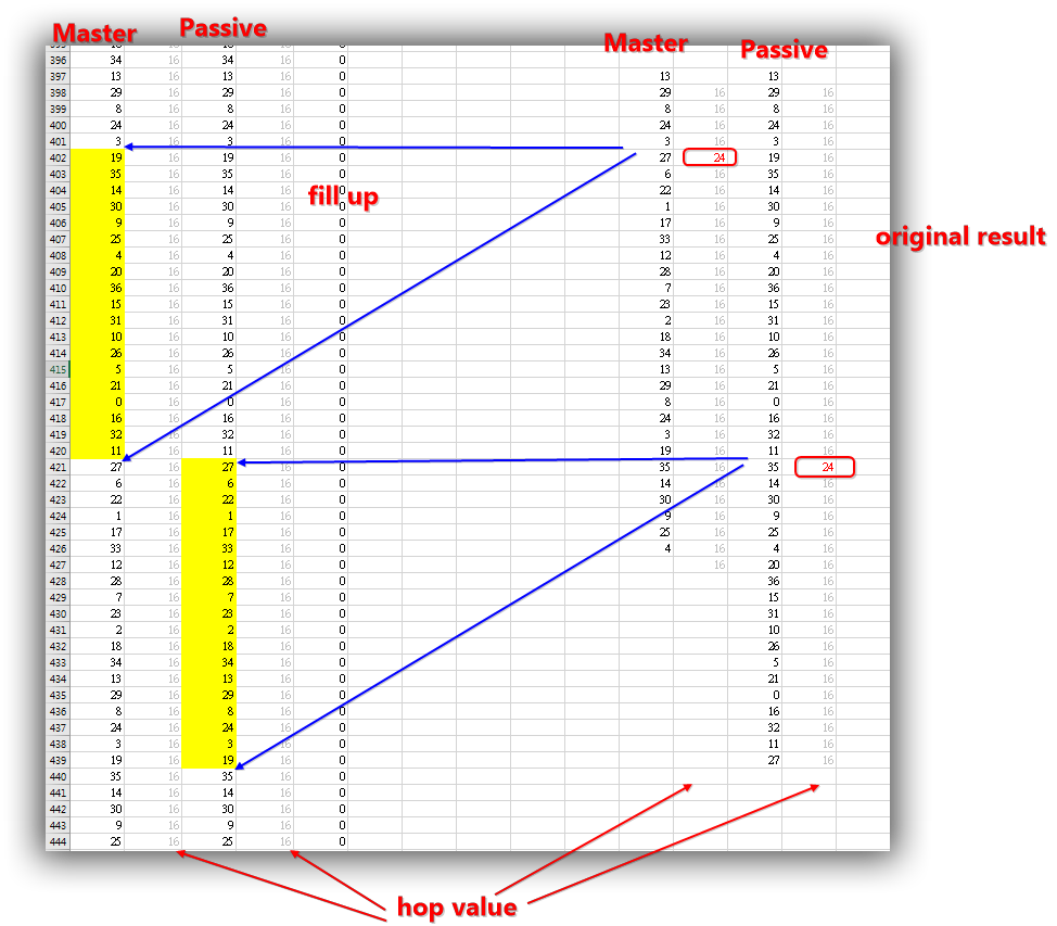

after got IQ RAW data, I filter the channel sequence of M+P to sheet "chan_compare" as attachment xslx file
there are happen 5 times channel hopping discontinuity,
At first I thought it was a packet drop, so I fill up the lost channel ID (see the yellow field, that didn't exist on original IQ RAW result)
1.always lost 18~20 consecutive packets each time
2.Passive can catch all packets that Master lost, but Passive will lost the next 18~20 consecutive packets.

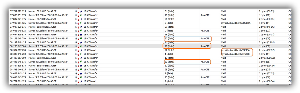

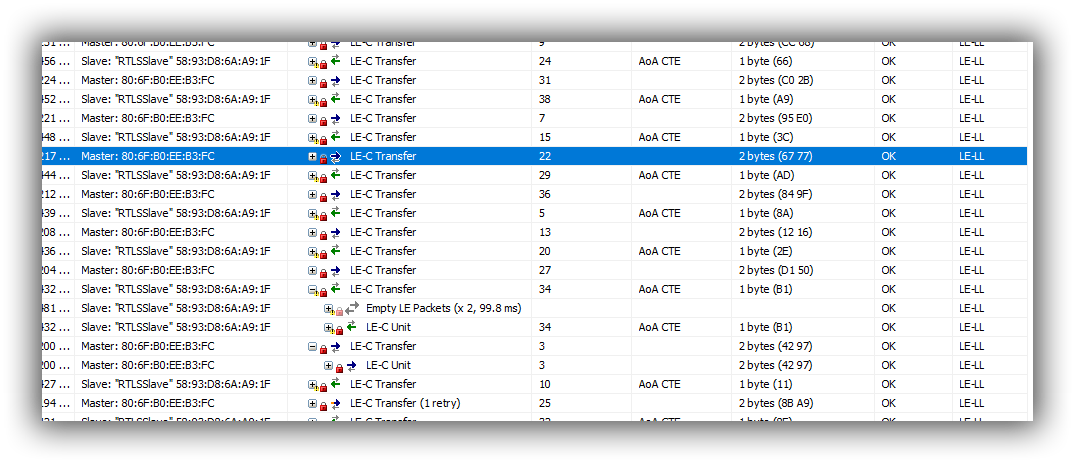

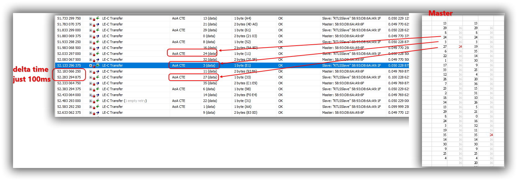

After use BT monitor to catch OTA packet(all channel every 100us), i think it is not pkt drop
1.Master got chan3 CTE pkt and next channel is chan11 for control pkt, then next is chan27 AOA pkt.
  The delta time of chan11,chan27 is 100ms, and my interval time is set to 50ms. it doesn't have enough time to drop so many pkts.
  so i guess Master have talk to Slave to ignore some hopping channel, but i don't know how to check it on pkt payload(chan11?).
2.if Master have talk to Slave to ignore some hopping channel, why Passive can got those channel which be ignored?
  Is it possible that Passive has a bug that got the chan27 CTE pkt but record to chan19?

    What condition will cause channel map update, because i didn't find this problem on conductive mode
    It doesn't make sense the passive can keep track of the connection even if it loses 18 successive packets
    ==>Looks like Passive allow 30 consecutive missed pkts
    // Threshold for consecutive missed packets in monitor session before terminated link
    #define BLE_CONSECUTIVE_MISSED_CONN_EVT_THRES       30
    Passive catch consecutive pkt which didn't be transmitted, but lost consecutive pkt which be transmitted. and both pkt numbers are same. I think Passive have a bug

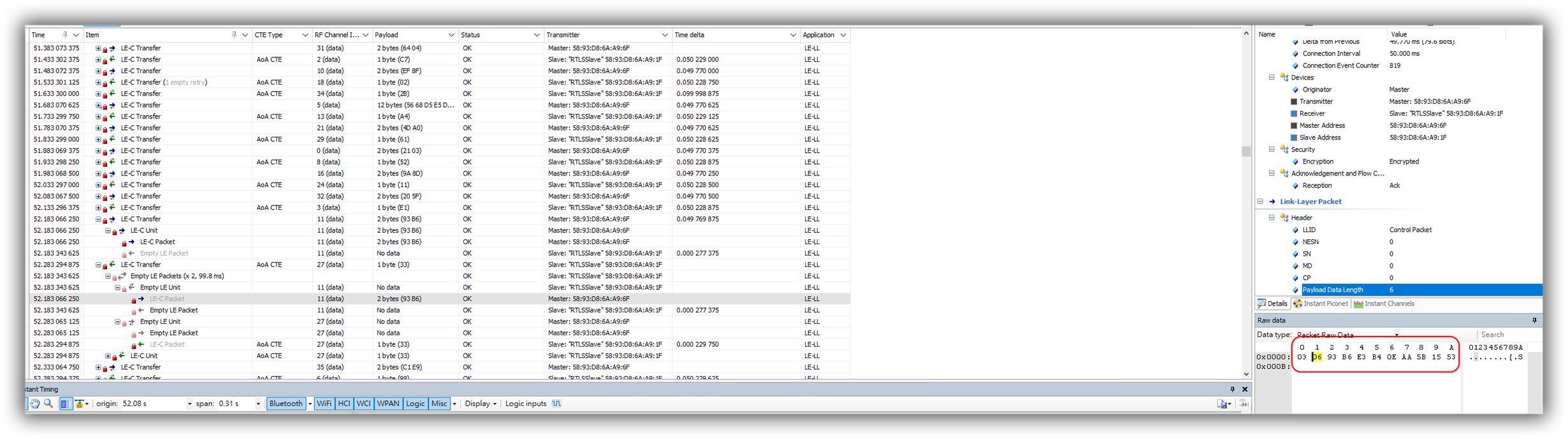

    tool is too big, so i just can provide the download linkhttps://e2e.ti.com/cfs-file/__key/communityserver-discussions-components-files/538/2021_5F00_1_5F00_22_5F00_AOA_5F00_frame_5F00_drop_5F00_test.7z
  • Hi Valery,
    Thank you for the traces provided. I had a look at them.
    I noticed that the peripheral appends CTE to every second packet. Is it expected behavior from your side? Is it the way you configure it?
  • Is it expected behavior from your side? Is it the way you configure it?
    no, i didn't configure it. Is that default behavior?
    Originally, I thought the Slave keep sending CTEs and the Master return ACK to confirm every CTE be received.
    Did you see channel map update between chan11 and chan27?
  • Hi Valery,
    I haven't yet found the issue, but let me summarize the findings:
    • As mentioned before, I see that only every second packet is appended with a CTE. This behavior is not the one we typically expect.
    • In this specific case, the channel hop increment is 8. As CTE are received only every second packet, it looks like the channel increment is 16 (cf. your xlsx document).
    • There is absolutely no channel update.
    • There is absolutely no error in the channel hops (it is always 8).
    • At some points the rtls_slave may not transmit the CTE three times in a row. So the channel increment looks like 3x8=24. I don't know yet why the device does this.

  • Hi Valery,
    I confirm it is expected behavior for the rtls_slave to send only one CTE every second connection event. In order to finish one CTE procedure it should take 2 connection events – in the first connection event we send the CTE request, in the second we receive the CTE response and in the third we send again the CTE request.
    At one point, you may see a different hop increment due to a packet loss. Typically, if the rtls_master sends the CTE request (LL_CTE_REQ) an this request is not received by the rtls_slave, then the rtls_slave won't append the CTE to the next connection packet.

                 I have add packet num in report field of passive, the pkt num is consecutive, This has nothing to do with python script.
                What can I do to help accelerate the analysis of this problem?
    An idea could be to let the devices toggle a pin every-time they sample a CTE on an arbitrary channel (e.g. channel 10). Then you can have a synchronization.
    [Valery]sorry, i means if Passive record wrong channel number, how can it correct to right channel num after 18~19 channel. (Synchronize on Channel 35)
    This is one of the limits of the topology including one master and one (or several) passive(s). The passive devices do not participate in the connection and cannot request a re-transmission when needed. In addition, the passive receives way more data (because it sniffs the RF packet coming from both sides).
    [Valery] Are there any parameters that can be adjusted? I wish Passive could catch up with the AOA channel sooner.

    1. In RAW report, we can find Master lost some packet and shift AOA channel
    check the sniffer log. the CRC of channel 1 CTE is error, but why Master still capture this frame and report to user?  Is the IQ information correct?

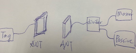

    2. I first assume that the channel of Master and Passive are same at the same time. Passive still catch the non-existent channel CTE.
        and recover the channel ID after 19 frame
    P.S. I can reproduce this issue on TI EVB board and use original SDK4.3 without any change

    From my observations, I assume the master reports the channel of the previous PDU (i.e. of a PDU without CTE). I do not have a BLE analyzer to confirm that. But could you verify this observation for me? To do so I think we could use the Ellisys to collect at the same time the UART and the BLE signals.
    In the meantime, a work around could be to add one hop to the channel reported by the rtls_master. If it was not clear, usually you have two hops between two IQ data reports (because a CTE is appended to every second connection packet).
