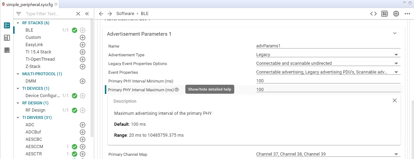

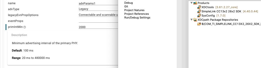

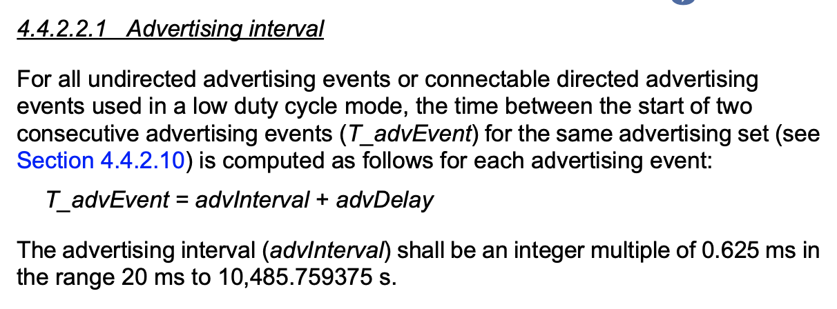

I want to implement the lowest power advertising interval that will still play nice with connecting to the TI Starter app. I see the CC2640 has an interval from 20ms to 10.24s. The Core v5.2 docs state that this is up to 10,485s, and SysConfig shows up to 480000ms. Which is correct?
