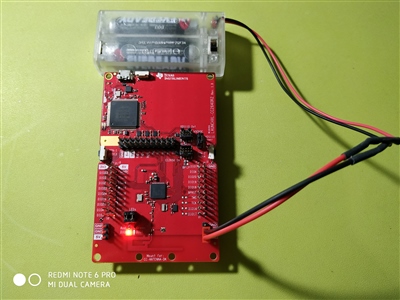

Hi YiKai,
I tested and measured the current of pinShutdown demo on the LAUNCHXL EVM board. The current changed between 6.45uA and 0.09uA alternatively when I push wake button and make it into shutdown mode periodically. If this time is 0.09uA in shutdown mode, and then the next time in shutdown mode must be 6.45uA. And vice versa.
Why the current in shutdown switches between 6.45uA and 0.09uA?
Why the shutdown current is 6.45uA? This current like a standby current.
Thank you!
Victor Chu

Hi Victor,
Reviewing the pin_shutdown example program the Board_shutDownExtFlash(), is already called within Board_init(). Another thing you can do is comment out the UART pin init here like this and set the drive strength of LEDs to MIN. Also drive strength of LEDs at pinShutdown.c.

Hi Markel,
It works, and the current is arond 0.12uA. That's not because of the UART issue. Since I even did not enable it from the beginning. I just put a 2-seconds delay before these instructions that you gave me, then it enter Shutdown properly.
