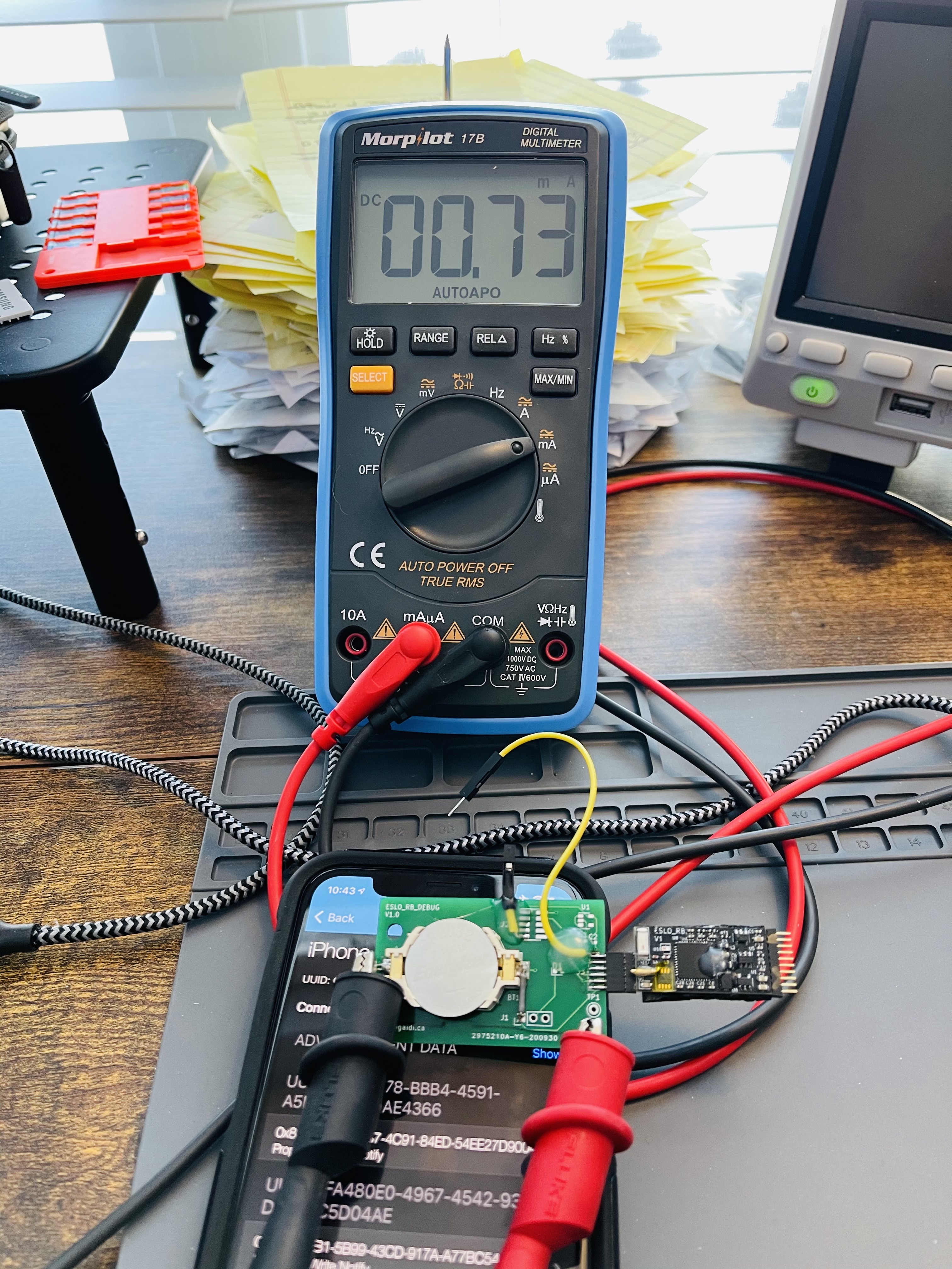

I want to call a function at 1Hz with "sleep" in between. I thought a timer was going to solve this, here's the timer:
Timer_Params_init(&timerParams);
timerParams.period = 1;
timerParams.periodUnits = Timer_PERIOD_HZ;
timerParams.timerMode = Timer_CONTINUOUS_CALLBACK;
timerParams.timerCallback = timerCallback;
timer0 = Timer_open(CONFIG_TIMER_0, &timerParams);
if (timer0 == NULL) { // failed init
	while (1) {
if (Timer_start(timer0) == Timer_STATUS_ERROR) {
	while (1) { // failed start
Inside mainThread(), at the bottom I have:
while (1) {
    Task_sleep(100000);

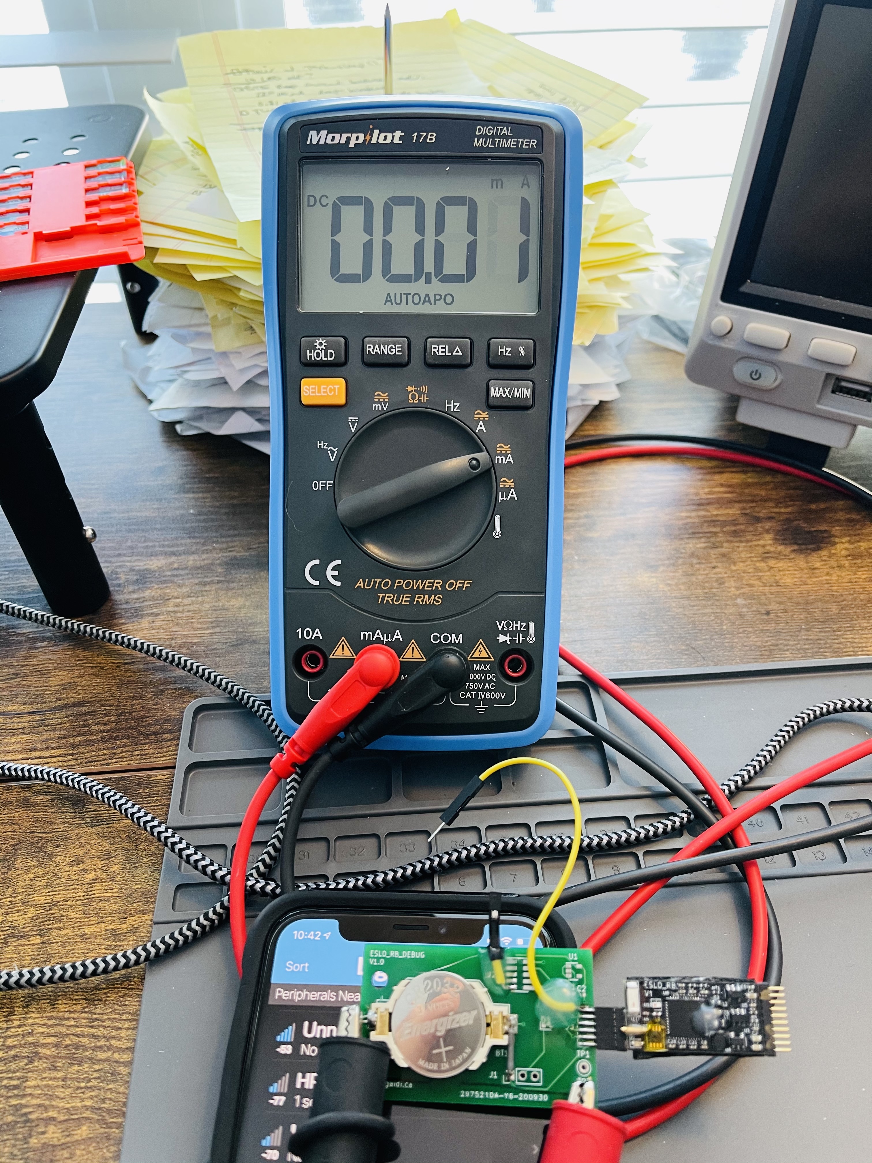

While my timer callback works, current hovers at ~1.5mA, so the device is not sleeping. If instead, I remove the timer and just make my own callback function in the while loop, I observe power savings at ~23uA:
while (1) {
    Task_sleep(100000);
    loopCallback();
What is it about the timer that's doing this? Is it possible that it's keeping the HF crystal on? I'm using BAW resonator with LF RCOSC.

  • Hi Ryan, I'm actually programming a standalone PCB, so my ammeter is inline with the battery itself. I just re-tested and get the same behavior if I replace the last while() loop with a return(NULL) as done in timerled, but that's the only thing I see that is different. Again, if I use Task_sleep in that while loop without the timer, everything sleeps just fine, and I can toggle an LED in there instead of the timer callback. My timer is configured the same in Sysconfig to timerled.

  • To achieve the lowest power with timerled I have to modify SysConfig to use LF RCOSC and use a while loop with Task_sleep (see modification below). The same problem exists, the timer works but doesn't achieve sleep in between GPIO_toggle. There's nothing to indicate in the API why I wouldn't achieve sleep, and my expectation was the same as yours (it should work): is it possible that the timer is forcing use of LF XOSC? With would force the main resonator to remain on and may be a source of the ~0.8mA I'm seeing.

  • These two measures are the code above (Task_sleep in while loop), LED off, only difference is XOSC_LF vs. RCOSC_LF. That said, using RCOSC_LF with the timer doesn't 'fix' anything—LED off current with RCOSC_LF using the timer is 0.84mA.

    I apologize for the confusion.  ~860 µA is expected when using the timer peripheral according to this E2E post, regardless of LFOSC source.  Z-Stack and others use util_timer which allows for standby mode operation.
    Ryan
