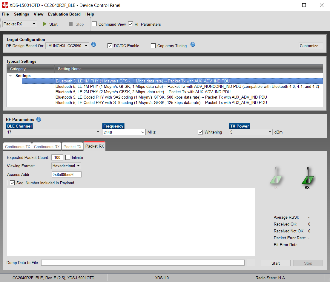

  • Hi JR,
    Is the only goal of this test to get a continuous signal of the CC2640R2? If so, I would recommend exploring the option of using SmartRF Studio 7 as you can have continuous TX/RX. The following shows an example screen capture of the SmartRF Studio 7:
    Does this fall in line with what you are looking for?

  • Hi JR,
    Glad to hear that this is what you're looking for! Sure, are you referring to how to connect the Launchpad to use SmartRF Studio 7? If so, you can use a micro USB connecter to connect the Launchpad to your PC. In terms of FW, if you are using the SmartRF Studio, you will not need to pre-program any firmware as this application will handle it for you.
    Once opening SmartRF Studio 7 and connecting your Launchpad to the PC, locate the List of Connected Devices as seen in the image below:
    Select BLE mode when the Select CC2640R2F mode window pops up.
    Jenny
  • Hi Jenny!
    Thanks! I played around a bit and noticed that RFStudio7 needs the JTAG interface, which fits to your recommendation to use the programming USB port on the launchpad.
    For my custom board that is not really an option, due to the size limitation and influence of the connector on the antenna - yes the board is tiny compared to the connector. :-)
    So I will stick to the HCI for most of my tests.
    I am very happy having learned about the RFStudio7! It makes my life so much easier to test the other side of the BLE connection with predefined data packets.
