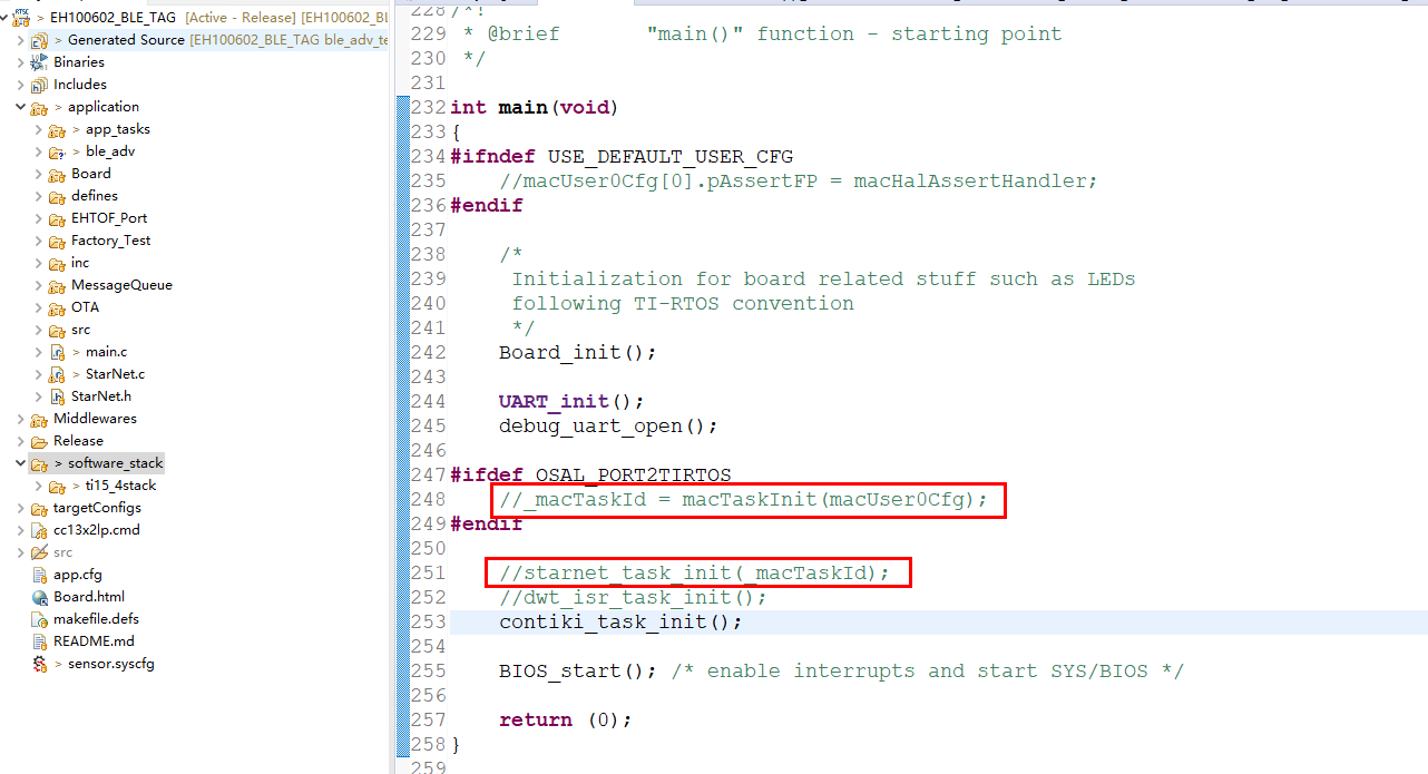

Hi, my target uses CC2652P, SimpleLink cc13x2_cc26x2 SDKv4.20, my application is based on example CC1352P_2_LAUNCHXL ti54stack sensor_2_4g.
My target works well with 15.4stack when data tx and rx.
Now I have a new task.
I need to transmit BLE adv signal based on current system.
I did an experiment.
First, I comment all my 15.4 code including 15.4 int and 15.4 task.
In the picture above, the code in red box is 15.4 init and has been comment.
Now the project will not init 15.4 stack.
In my application task,
while (1)
	Clock_setTimeout(clockHandle, 500 * 100);
	Clock_start(clockHandle);
	ble_nc_adv_tx();
	Semaphore_pend(gSem, BIOS_WAIT_FOREVER);
There is only one task in my application, ble_nv_adv_tx each 500ms.
ble_nc_adv_tx() is

When I run this project, the program died when run ble_nc_adv_tx(), and system reset.
So, how to run this ble_nv_adv_tx() in my application, thank you.
    You can refer to "simplelink_cc13x2_26x2_sdk_4_20_01_04\examples\rtos\CC1352P_2_LAUNCHXL\drivers\rfDualModeTx", it shows how to send ble_adv and proprietary packet on the same project.
  • Thank you very much.
    This rfDualModeTx example uses ble_adv and proprietary packet, both of them use low level RF drivers.
    But in my application, I need to use ti15_4stack.
    Based on this stack, how to use RF driver to tx BLE Adv?
    And I have tried according to the example above, it also failed.

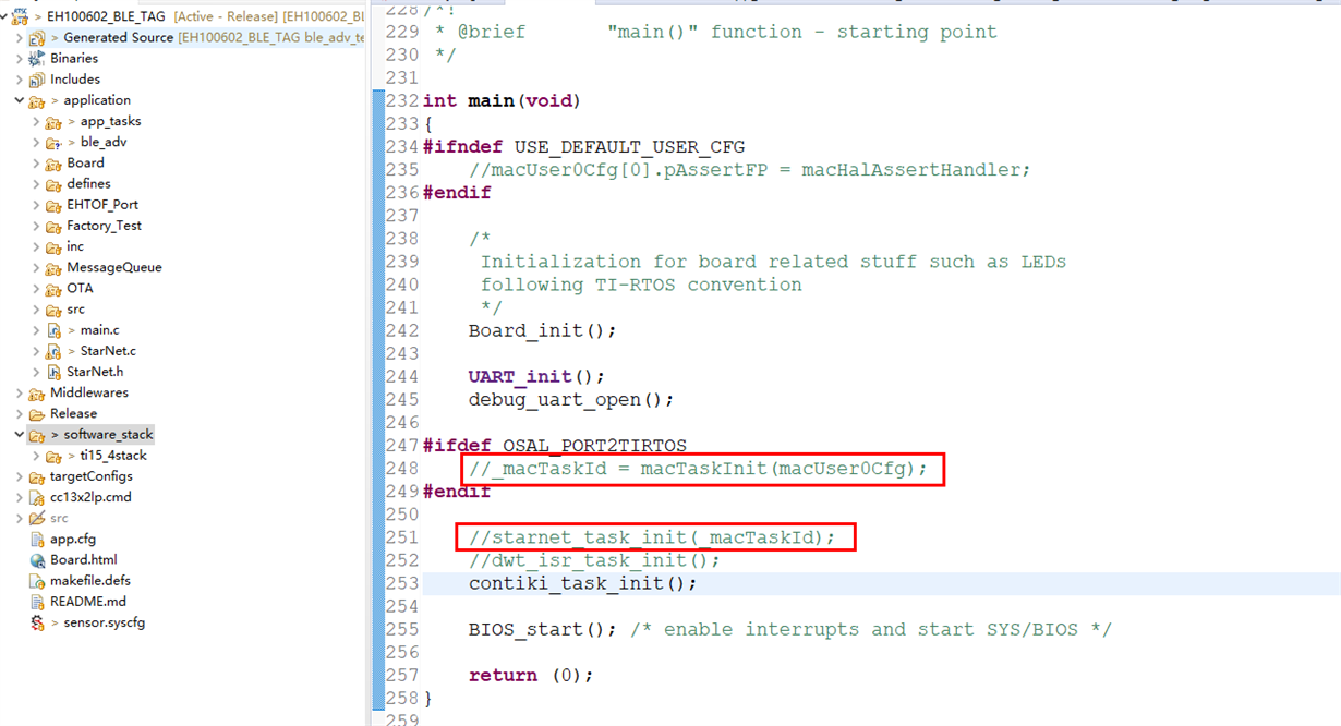

    void ble_nc_adv_tx(void)
        uint8_t chan = 3;
        RF_ScheduleCmdParams schParams;
        schParams.endTime = 0;
        // TODO: Need to replace with updated parameters from RFLIB-107
        // schParams.priority = RF_PriorityNormal;
        schParams.allowDelay = RF_AllowDelayAny;
        schParams.activityInfo = 0;
        schParams.duration = 0;
        schParams.endType = RF_EndNotSpecified;
        schParams.startTime = 0;
        schParams.startType = RF_StartNotSpecified;
        memset(&ble_adv_aoa_dat,0x00,sizeof(ble_adv_aoa_dat));
        ble_adv_aoa_dat.len = sizeof(ble_adv_aoa_t)-sizeof(ble_adv_aoa_dat.len);
        ble_adv_aoa_dat.hdr[0] = 0xff;
        ble_adv_aoa_dat.hdr[1] = COMPANY_ID_TEXAS_INSTRUMENTS&0xff;
        ble_adv_aoa_dat.hdr[2] = COMPANY_ID_TEXAS_INSTRUMENTS>>8;
        ble_adv_aoa_dat.hdr[3] = 0x03;
        //memset(ble_adv_aoa_dat.padding,0xaa,4/*sizeof(ble_adv_aoa_dat.padding)*/);
        memcpy(&ble_adv_aoa_dat.padding[0],&tag_id,4);
        memcpy(&ble_adv_aoa_dat.padding[4],&seq,2);
        memcpy(ble_adv_aoa_dat.tone,tone_dat[37-TONE_DAT_CHAN],sizeof(ble_adv_aoa_dat.tone));
        RF_Params rfParams;
        RF_Params_init(&rfParams);
        debug_printf("XX2\n");
        /* Request access to the radio */
        rfHandle = RF_open(&rfObject, &RF_prop_bt5le1m_0, (RF_RadioSetup*)&RF_cmdBle5RadioSetup_bt5le1m_0, &rfParams);
        debug_printf("XX3\n");
        /* Set the frequency */
        RF_cmdFs_bt5le1m_0.frequency = RFfrequencyTable_ble[chan].frequency;
        RF_cmdFs_bt5le1m_0.fractFreq = RFfrequencyTable_ble[chan].fractFreq;
        (void)RF_scheduleCmd(rfHandle, (RF_Op*) &RF_cmdFs_bt5le1m_0, &schParams, NULL, 0);
        debug_printf("XX4\n");
        rfc_ble5ExtAdvEntry_t ble5ExtAdvPacket;
        #define EXTENDED_HEADER_LENGTH            9
        /* Packet TX Configuration */
        #define PACKET_DATA_LENGTH                    27 /* Packet for BLE5 cannot exceed 37 with header (10) */
        static uint8_t packet[PACKET_DATA_LENGTH] = {0x11, 0x22};
        RF_ble_cmdBle5AdvAux.pParams->pAdvPkt = (uint8_t *)&ble5ExtAdvPacket;
        ble5ExtAdvPacket.extHdrInfo.length = EXTENDED_HEADER_LENGTH;
