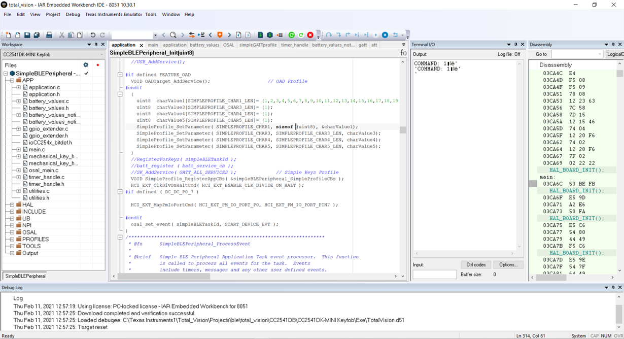

  • Hi
    I changed the length of the CHAR1 to 20 bytes and I send the command from the nrfConnect App and printed the command. I am attaching the screenshot what I'm getting after sending (1,0,0,0,0,0,0,0).
    I'm also attaching the  simpleProfile_WriteAttrCB code.

  • Do you check if your simpleProfile_WriteAttrCB is triggered and if yes, what value is written over the air?
  • Hi ,
    If I'm sending only "1" command then simpleProfile_WriteAttrCB is triggering and providing me output as I'm using serial print to print the values but if I'm sending the command as string like 100000 then it is not printing anything.
  • What do you mean "sending the command as string like 100000"? What is the data type of your written characteristic?

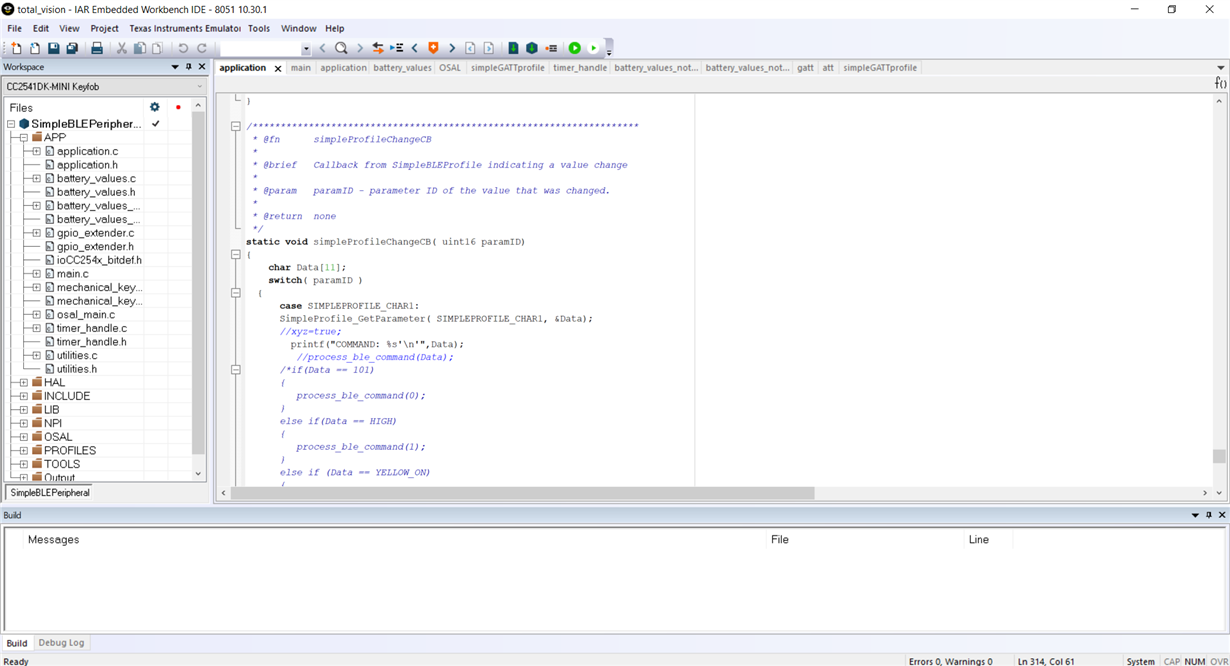

  • Hi ,
    * @fn simpleProfileChangeCB
    * @brief Callback from SimpleBLEProfile indicating a value changesimpleProfileChangeCB
    * @param paramID - parameter ID of the value that was changed.
    * @return none
    static void simpleProfileChangeCB( uint16 paramID )
      uint8 newValue[15];
      switch( paramID )
      case SIMPLEPROFILE_CHAR1:
      SimpleProfile_GetParameter( SIMPLEPROFILE_CHAR1, &newValue );
      printf("Command: %x\n",newValue);
    break;
    This is the code I'm testing and from the App I am testing sending "TEXT".
    So, for example if I'm sending "1" from nrfConnect APP to Characteristics 1, In the serial print output is printing as 1fb but when I'm sending string like 110000000 it is not printing anything. So, basically 110000000 are the status of the LED's for example 11 means LED1 and LED2 are ON and others are OFF. But this data will be send directly by the App and the firmware will pass this status to CC2541 using Bluetooth.
