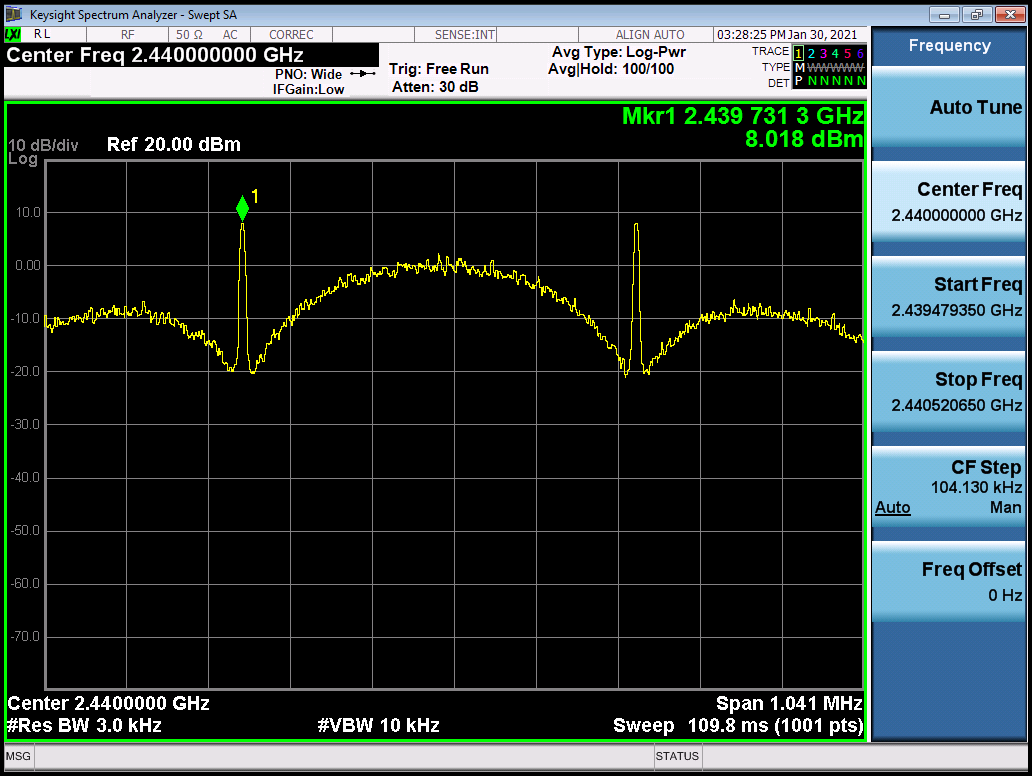

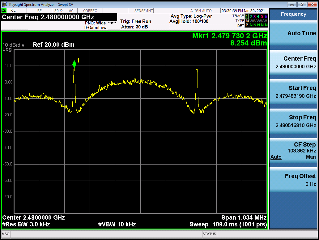

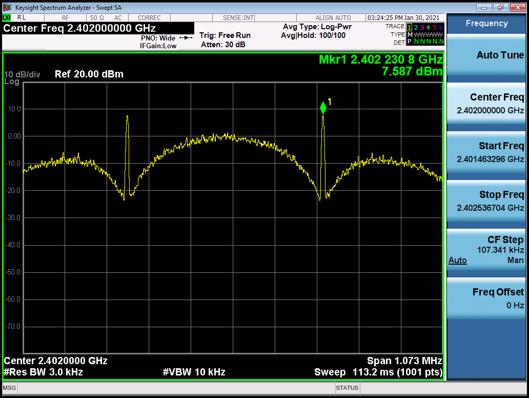

We are processing the FCC certification test for our CC1352P module, which is 20dB output power on the 2.4GHz band, and we observed a fail on the Power Spectral Density test with 125Kbps, while other datarates passed.
Here are the data plots for your reference.
Low channel PSD:
Mid channel PSD:
High channel PSD:
We observed the same result on the TI launchpad: LAUCHXL-CC1352P-2. From the plots, we can see two spikes that are not seen with other datarates.
Are there any solutions? Looking forward to your reply.

  • 1. I used below setting on Smart RF Studio 7.
    2. I connected the module to the Spectrum Analyzer through an SMA connector and got blow plot.
    3. Please note that the resolution bandwidth is 3 kHz, so from the plot, we can see the peak PSD is 8.018 dBm/3KHz, which is exceeding the limit (8 dBm/3KHz).
