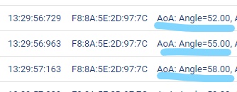

    can you kindly explain in detail what exactly did AOA_getPairAngles do. I understand from the code was that it estimate an angle between two antenna.
    however, i place my slave about 45 degrees to the master. but the result showed in antResult->pairAngle[pair] are [ -1, 230, -9...... ]
    can you kindly guild me through this? what function represent the right output angle value, which had shown in rtls_ui.exe
    The table antResult->pairAngle[] contains the angle computed for each antenna pair defined in the table pair_A1[] defined in ant_array2_config_boostxl_rev1v1.c
    Are you sure the rtls_master receiv the same settings while you observe the results through the RTLS_UI and while you look into the code?

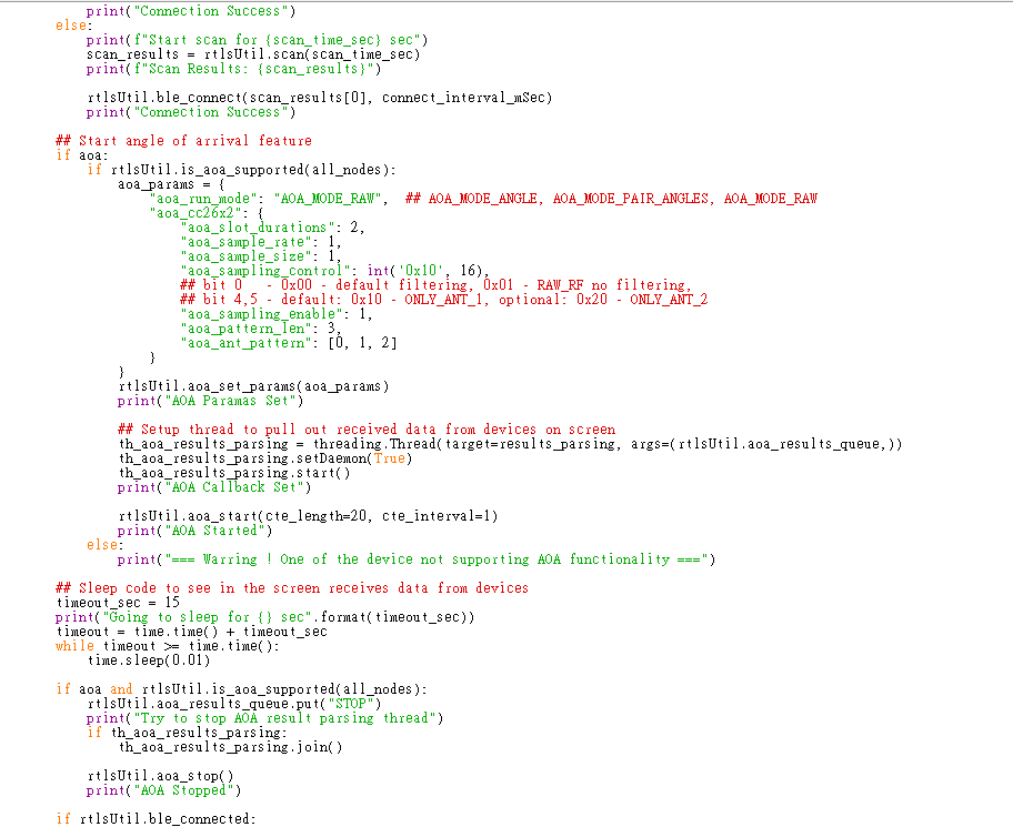

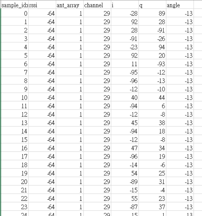

    i'm just confusing by the IQ data that shown in  `rtls_aoa_iq_with_rtls_util_export_into_csv.py`  , i add in an angle data into the csv file, so that i can do my calculation and compare with TI's angle.
    However, when i apply some basic calculation of getting the Phase-difference and trigonometry, the angle is really different from what TI shows. can you kindly show some of the solution that you think it's
    appropriate?
    thank you Clément. please help me with the answer thank you!
    Do you want to share the formula you are using to extract an angle from the IQ data? That way I could comment on it.
  • Hi
    1. i took IQ and did  Zre = Xre*Yre + Xim*Yim;       and use the result atan(zim/zre) *(180/pi) and it seems that i miss out the most important part.
                                    Zim = Xim*Yre - Xre*Yim;
    2. can i ask what it mean by Calculate the phase drift across one antenna repetition?  from what i know is it the movement of the angle difference from the same antenna?
    3. can you explain for me inside Paa_rel (samplerate ,a, i,r) ? what it mean by these numbers?
    1- Are you taking IQ data from the same antenna or from different antennas?
    2- As you may know, the signal phase sampled on a single antenna will vary across the time. This is why you need to take into account this variation when you do the calculation.
    3-  Considering the line
    pIQExt[AOA_OFFSET_FIRST_VALID_SAMPLE*sampleRate + r*numAnt*sampleRate + a*sampleRate + i]
    Here you try to get the proper sample in pIQExt. The sample to consider. Based on the sampling frequency, the antenna you are considering (a), the slot inside the sample slot (i) and the index of the slot you are considering (r) you will get a different index in the pIQExt table.
    Please refer to the documentation for more details.
