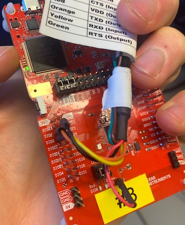

    • I recommend you run the tests (at least test the connection between the tool and the device) using a Launchpad flashed with the out of the box host_test example. I have attached a picture of some tests I run before (not with the exact same tester). If it not clear, the USB input of the device is used only to power-up the board. The wires connected to my Launchpad are the one coming from the USB-RS-232 converter. As you can see, the out of the box example does not use the RTS/CTS signals. Only the GND, Rx and Tx are connected on my Launchpad. As a side note, the picture does not show the RF connection between the tester and the Launchpad, but this one is of course required (not that on launchpads, you have to flip a capacitor in order to route the RF signals to the CMD output instead of the PCB antenna)
