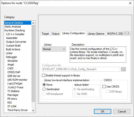

3. Thirdly. The settings in IAR.
________________________________________________________________________________________
Please, can someone help me and tell me what do I wrong and what is the right way :)
