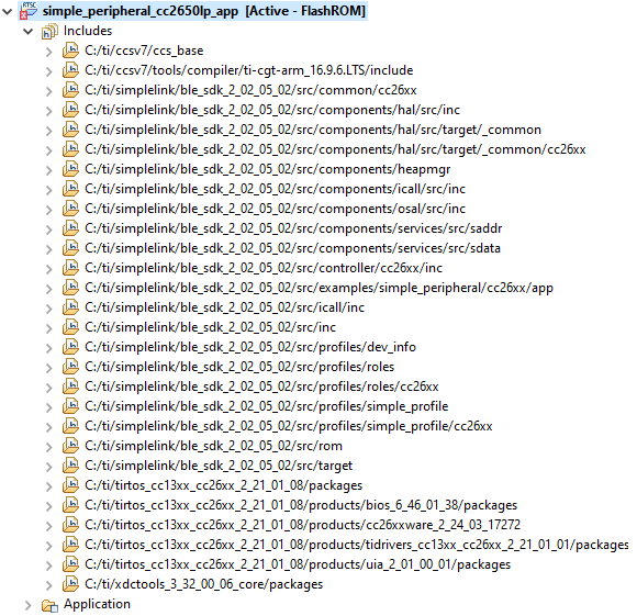

    Just like Markel, I can also build the CC2650 projects from SDK versino 2.2.5 on CCSv7.4.0.
    Adan Pantoja said:
    From the console output, it appears that the program cannot find "xdc/std.h" and it is also having issues with the "app_ble.cfg" file.
    The include file is indeed the root of the issues when trying to build the <app_ble.cfg>. This is usually caused by a bad path to an include directory or a missing dependency installed as Markel suggested.
    When you expand the includes project directory, do you see any missing paths (greyed out)? This is waht you should see:
    If there is a greyed out path, check the Project Include options and the Products installed:
    You can proceed to install and restart CCS to scan the installed products.

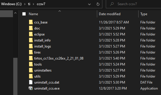

  • Hi Rafael,
    Thank you for getting back to me! I have checked the include files and none are greyed out (see screenshot).
    I have also checked my products and they happen to be the same as yours (see screenshot below)
    One thing I noticed is that when I downloaded BLE stack it installed tirtos_cc13xx_cc26xx_2_21_01_08 and xdctools_3_32_00_06_core in the TI directory. But when I loaded CCS it prompted me to install both of the things again, could that cause any issues?
    I am extremely confused as to why this is not working. The steps that I am doing are as follows:
    1. Installed Code Composer Studio version 7.4.0.00014
    2. Installed BLE stack, which the executable installs tirtos_cc13xx_cc26xx_2_21_01_08 and xdctools_3_32_00_06_core.
    4. Open CCS which prompted me to install tirtos_cc13xx_cc26xx_2_21_01_08 and xdctools_3_32_00_06_core.
    3. Load simple_peripheral_cc2650lp_app and stack into the workspace.
    4. Build simple_peripheral_cc2650lp_stack. (No issue when building this)
    5. Build simple_peripheral_cc2650lp_app.
    Step 5 is where I am stuck because of the issues mentioned above.
    Is there anything else I can try? I am desperate at this point to get this project working.
    Thank you,
    Adan

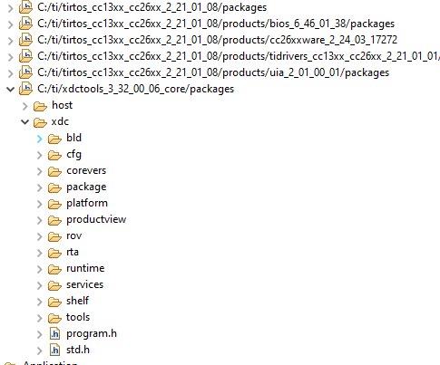

  • Adan,
    That is normal. When you open CCS 7.4, it automatically runs something called Product Discovery. This is necessary to use the dependencies of the BLE Stack, such as TI-RTOS and XDC. Additional information in section 6.1.3.10 of the CCS User's Guide I linked above.
    When the Product Discovery process finishes, you usually need to restart CCS.
    Since the file std.h is being reported as missing, can you be sure it exists in the Include tree by expanding the entry for the xdctools as shown below?
    I send attached the entire build output of my project here - perhaps you can spot something out of the ordinary.
    simple_peripheral_cc2650lp_app_build_output.txt

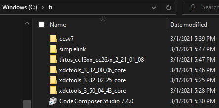

  • Rafael,
    I have had an unusual experience with CCS. My project seems to now build and is working properly. I have no clue as to what caused it to fix itself.
    The steps I took before it magically worked are as follows:
    1. Uninstalled all files: BLE stack, TIRTOS, XDC, and CCS (Cleared my C:/ti folder).
    2. Installed CCS 10.2
    3. Installed BLE stack (which installs TIRTOS, and xdc)
    4. Imported the simple_peripheral_cc2650lp_app/stack and copied into workspace.
    5. Download tirtos and xdc into CCS.
    6. Select the correct version of tirtos and xdc in project properties under products.
    7. Built stack and then the app.
    Step 7 is where I still got the same issue as mentioned above.
    I then decided to install ccs 7.4, so ..
    8. Install CCS 7.4
    9. Imported the simple_peripheral_cc2650lp_app/stack and copied into workspace.
    10. Download tirtos and xdc into CCS.
    11. Select the correct version of tirtos and xdc in project properties under products.
    12. Built stack and then the app.
    And here is where it somehow decided to build properly.
    The thing that is most frustrating is that I have been doing the steps mentioned above multiple times and the project never compiled, but then it finally compiled. So .. to sum up my post: I do not know what I did to resolve this issue, but I am no longer having it with CCS7.4. When I build the project using CCS 10.2, I still get the same issue.
    It would be ideal to figure out exactly what is going on for other people who may be experiencing this, but for now I am moving forward with my development.
    Thank you all for your assistance! It was greatly appreciated.
    -Adan
