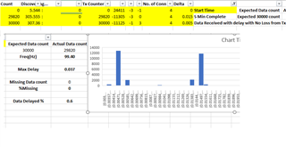

    1. Applying Guard Time to Only Rx and analyzed 5min data received from Transmitter.
    Result :
    2. Applying Guard Time at only Tx
    Result :

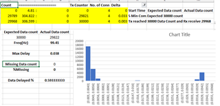

    3. Applying Guard Time to both Rx and Tx
    Result:
    I have Implemented application level counter as you suggested and observed timing along with number of count.
    So, from above result you can observe that
    1. Applying Guard time to Tx is no use.
    2. Applying guard time to Rx actually give no loss of data but there is delay in receiving data you can observe that in readings.
    3. After applying Rx guard time My frequency of receiving data is distribute in two half.
    So, I need to know How can I concentrate My Frequency near to 10ms data rate. I tried changing Connection interval but I got best result from present connection interval (i.e Min Conn Interval - 10ms and Max Conn Interval 20ms).
    I will provide you sniffer log as well later.

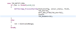

    2. I am using Notification approach for receiving data in central
    As you suggested indication approach so, I tried implementing indication as well.
    I was getting proper sequencing for 4 sensor but data frequency was different for different sensor for all the 4 sensor, and my expectation was to get 100 Hz data frequency i.e delta time 10ms,
    when 1 sensors is connected I received 47.8Hz frequency but (100 HZ is expected)
    When 2 sensor are connected we can achieve sequencing but frequency drop is present for 1st sensor 48.3 Hz and for 2nd it is 47.99 Hz
    In case of 4 sensor the frequency got further decrease to 1st sensor 28.65 Hz and for 2nd sensor 47.23 Hz, 3rd sensor 42.62 Hz and for 4th sensor  23.44 Hz
    sequencing is also not as per expectation.
    So what Is there way to improve this ?
    But As it is unable to Provide 100 Hz frequency with single sensor, is this the limitation of Indication approach as I can only achieve 47.8 Hz
    So, should I continue working on notification approach for synchronization of sensor data.

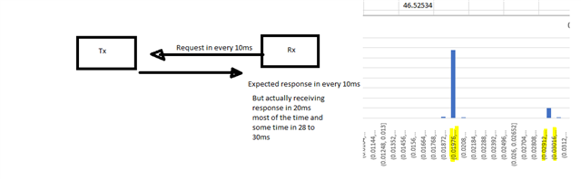

    5. Actually I used Request response approach as well but I could only achieve 47 to 46 Hz of frequency for all with above Rx and Tx time.
    Can I achieve 100 Hz frequency with request response i.e each data is receive each data in 10ms.
  • Hey Vidit,
    Try increasing the APP_SUGGESTED_TX_TIME. You mention the frequency improves when using 1M PHY. These parameters are related to which PHY you use so I would suggest trying something larger, like 2624 us. Please let me know if this makes a difference.
    Just to confirm, you are observing the time from TX on one device to RX on one device is approximately a 20ms period, rather than a 10 ms period?
  • Hi Ammar,
    I think if we will increase Tx time frequency will drop further but, still I tried changing APP_SUGGESTED_TX_TIME to 2624 us but did not see any improvement in result.
    Yes, My expectation is to get response in every 10ms for each request.
