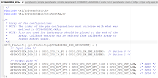

    now I have change macro CC2640R2_LAUNCHXL to CC2640R2DK_4XS
    I can see it is building using CC2640R2DK_4XS.h and CC2640R2DK_4XS.c
    but no help.
    strange point, i found these code (attached picture ) in CC2640R2DK_4XS.c
    as there should be no such pins, so it is strange.

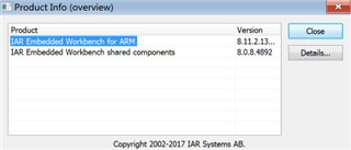

  • thank you for your kind and patient answer. I have installed latest 4.40 sdk.
    build this sample in IAR(version in attached picture):
     C:\ti\simplelink_cc2640r2_sdk_4_40_00_10\examples\rtos\CC2640R2_LAUNCHXL\ble5stack\simple_peripheral
    have below error:
    Building configuration: cc2640r2lp_app - FlashROM_StackLibrary Updating build tree... Performing Pre-Build Action "C:\ti\simplelink_cc2640r2_sdk_4_40_00_10\examples\rtos\CC2640R2_LAUNCHXL\ble5stack\simple_peripheral\tirtos\iar\app\..\..\..\..\..\..\..\..\..\xdctools_3_51_03_28_core\xs" --xdcpath="C:\ti\simplelink_cc2640r2_sdk_4_40_00_10\ examples\rtos\CC2640R2_LAUNCHXL\ble5stack\simple_peripheral\tirtos\iar\app\..\..\..\..\..\..\..\..\kernel\tirtos\packages;C:\ti\simplelink_cc2640r2_sdk_4_40_00_10\examples\rtos\CC2640R2_LAUNCHXL\ble5stack\ simple_peripheral\tirtos\iar\app\..\..\..\..\..\..\..\..\source;C:\ti\simplelink_cc2640r2_sdk_4_40_00_10\examples\rtos\CC2640R2_LAUNCHXL\ble5stack\simple_peripheral\tirtos\iar\app\..\..\..\..\..\..\..\..\source\ti\ble5stack" iar.tools.configuro -c "C:\Program Files\IAR Systems\Embedded Workbench 8.0\arm" --cc "C:\Program Files\IAR Systems\Embedded Workbench 8.0\arm\bin\iccarm.exe" --device "Default" --compileOptions "dummy.c -D DeviceFamily_CC26X0R2 --diag_suppress Pa050 -o C:\ti\simplelink_cc2640r2_sdk_4_40_00_10\examples\rtos\CC2640R2_LAUNCHXL\ble5stack\simple_peripheral\tirtos\iar\app\FlashROM_StackLibrary\Obj --debug --endian=little --cpu=Cortex-M3 -f C:\ti\simplelink_cc2640r2_sdk_4_40_00_10\examples\rtos\CC2640R2_LAUNCHXL\ble5stack\simple_peripheral\tirtos\iar\app\defines\cc2640r2lp_app_FlashROM_StackLibrary.opt -f C:\ti\ simplelink_cc2640r2_sdk_4_40_00_10\examples\rtos\CC2640R2_LAUNCHXL\ble5stack\simple_peripheral\tirtos\iar\app\..\..\..\..\..\..\..\..\source\ti\ble5stack\config\build_components.opt -f C:\ti\simplelink_cc2640r2_sdk_4_40_00_10\ examples\rtos\CC2640R2_LAUNCHXL\ble5stack\simple_peripheral\tirtos\iar\app\..\..\..\..\..\..\..\..\source\ti\ble5stack\config\factory_config.opt -f C:\ti\simplelink_cc2640r2_sdk_4_40_00_10\examples\rtos\CC2640R2_LAUNCHXL\ ble5stack\simple_peripheral\tirtos\iar\app\..\..\..\tirtos\build_config.opt -f C:\ti\simplelink_cc2640r2_sdk_4_40_00_10\examples\rtos\CC2640R2_LAUNCHXL\ble5stack\simple_peripheral\tirtos\iar\app\..\config\configPkg\ compiler.opt.defs -e --fpu=None --dlib_config \"C:\Program Files\IAR Systems\Embedded Workbench 8.0\arm\INC\c\DLib_Config_Normal.h\" -I C:\ti\simplelink_cc2640r2_sdk_4_40_00_10\examples\rtos\CC2640R2_LAUNCHXL\ ble5stack\simple_peripheral\tirtos\iar\app\..\..\..\..\..\..\..\..\source\ti\ble5stack\controller\cc26xx\inc\ -I C:\ti\simplelink_cc2640r2_sdk_4_40_00_10\examples\rtos\CC2640R2_LAUNCHXL\ble5stack\simple_peripheral\tirtos\iar\app\..\..\ ..\..\..\..\..\..\source\ti\ble5stack\inc\ -I C:\ti\simplelink_cc2640r2_sdk_4_40_00_10\examples\rtos\CC2640R2_LAUNCHXL\ble5stack\simple_peripheral\tirtos\iar\app\..\..\..\..\..\..\..\..\source\ti\ble5stack\common\cc26xx\ -I C:\ti\ simplelink_cc2640r2_sdk_4_40_00_10\examples\rtos\CC2640R2_LAUNCHXL\ble5stack\simple_peripheral\tirtos\iar\app\..\..\..\src\app\ -I C:\ti\simplelink_cc2640r2_sdk_4_40_00_10\examples\rtos\CC2640R2_LAUNCHXL\ble5stack\ simple_peripheral\tirtos\iar\app\..\..\..\..\..\..\..\..\source\ti\ble5stack\icall\inc\ -I C:\ti\simplelink_cc2640r2_sdk_4_40_00_10\examples\rtos\CC2640R2_LAUNCHXL\ble5stack\simple_peripheral\tirtos\iar\app\..\..\..\..\..\..\..\..\source\ti\ ble5stack\inc\ -I C:\ti\simplelink_cc2640r2_sdk_4_40_00_10\examples\rtos\CC2640R2_LAUNCHXL\ble5stack\simple_peripheral\tirtos\iar\app\..\..\..\..\..\..\..\..\source\ti\ble5stack\profiles\dev_info\ -I C:\ti\ simplelink_cc2640r2_sdk_4_40_00_10\examples\rtos\CC2640R2_LAUNCHXL\ble5stack\simple_peripheral\tirtos\iar\app\..\..\..\..\..\..\..\..\source\ti\ble5stack\profiles\simple_profile\ -I C:\ti\simplelink_cc2640r2_sdk_4_40_00_10\ examples\rtos\CC2640R2_LAUNCHXL\ble5stack\simple_peripheral\tirtos\iar\app\..\..\..\..\..\..\..\..\source\ti\ble5stack\profiles\simple_profile\cc26xx\ -I C:\ti\simplelink_cc2640r2_sdk_4_40_00_10\examples\rtos\ CC2640R2_LAUNCHXL\ble5stack\simple_peripheral\tirtos\iar\app\..\..\..\..\..\..\..\..\source\ti\ble5stack\target\ -I C:\ti\simplelink_cc2640r2_sdk_4_40_00_10\examples\rtos\CC2640R2_LAUNCHXL\ble5stack\simple_peripheral\tirtos\ iar\app\..\..\..\..\..\..\..\..\source\ti\ble5stack\hal\src\inc\ -I C:\ti\simplelink_cc2640r2_sdk_4_40_00_10\examples\rtos\CC2640R2_LAUNCHXL\ble5stack\simple_peripheral\tirtos\iar\app\..\..\..\..\..\..\..\..\source\ti\ble5stack\hal\src\target\ _common\ -I C:\ti\simplelink_cc2640r2_sdk_4_40_00_10\examples\rtos\CC2640R2_LAUNCHXL\ble5stack\simple_peripheral\tirtos\iar\app\..\..\..\..\..\..\..\..\source\ti\ble5stack\hal\src\target\_common\cc26xx\ -I C:\ti\ simplelink_cc2640r2_sdk_4_40_00_10\examples\rtos\CC2640R2_LAUNCHXL\ble5stack\simple_peripheral\tirtos\iar\app\..\..\..\..\..\..\..\..\source\ti\ble5stack\hal\src\target\cc2650\rom\ -I C:\ti\simplelink_cc2640r2_sdk_4_40_00_10\ examples\rtos\CC2640R2_LAUNCHXL\ble5stack\simple_peripheral\tirtos\iar\app\..\..\..\..\..\..\..\..\source\ti\ble5stack\heapmgr\ -I C:\ti\simplelink_cc2640r2_sdk_4_40_00_10\examples\rtos\CC2640R2_LAUNCHXL\ble5stack\ simple_peripheral\tirtos\iar\app\..\..\..\..\..\..\..\..\source\ti\ble5stack\icall\src\inc\ -I C:\ti\simplelink_cc2640r2_sdk_4_40_00_10\examples\rtos\CC2640R2_LAUNCHXL\ble5stack\simple_peripheral\tirtos\iar\app\..\..\..\..\..\..\..\..\source\ ti\ble5stack\osal\src\inc\ -I C:\ti\simplelink_cc2640r2_sdk_4_40_00_10\examples\rtos\CC2640R2_LAUNCHXL\ble5stack\simple_peripheral\tirtos\iar\app\..\..\..\..\..\..\..\..\source\ti\ble5stack\services\src\saddr\ -I C:\ti\ simplelink_cc2640r2_sdk_4_40_00_10\examples\rtos\CC2640R2_LAUNCHXL\ble5stack\simple_peripheral\tirtos\iar\app\..\..\..\..\..\..\..\..\source\ti\ble5stack\services\src\sdata\ -I C:\ti\simplelink_cc2640r2_sdk_4_40_00_10\ examples\rtos\CC2640R2_LAUNCHXL\ble5stack\simple_peripheral\tirtos\iar\app\..\..\..\..\..\..\..\..\source\ti\devices\cc26x0r2\ -I C:\ti\simplelink_cc2640r2_sdk_4_40_00_10\examples\rtos\CC2640R2_LAUNCHXL\ble5stack\ simple_peripheral\tirtos\iar\app\..\..\..\..\..\..\..\..\source\ -Ohz" --linkOptions "-o C:\ti\simplelink_cc2640r2_sdk_4_40_00_10\examples\rtos\CC2640R2_LAUNCHXL\ble5stack\simple_peripheral\tirtos\iar\app\FlashROM_StackLibrary\ Exe\ble5_simple_peripheral_cc2640r2lp_app_FlashROM_StackLibrary.out --config_def CC2650=2 --config_def FLASH_ROM_BUILD=2 --map C:\ti\simplelink_cc2640r2_sdk_4_40_00_10\examples\rtos\CC2640R2_LAUNCHXL\ ble5stack\simple_peripheral\tirtos\iar\app\FlashROM_StackLibrary\List\ble5_simple_peripheral_cc2640r2lp_app_FlashROM_StackLibrary.map --config C:\ti\simplelink_cc2640r2_sdk_4_40_00_10\examples\rtos\ CC2640R2_LAUNCHXL\ble5stack\simple_peripheral\tirtos\iar\app\..\..\..\..\..\..\..\..\source\ti\ble5stack\common\cc26xx\iar\cc26xx_app_and_stack.icf --keep __vector_table -f C:\ti\simplelink_cc2640r2_sdk_4_40_00_10\examples\ rtos\CC2640R2_LAUNCHXL\ble5stack\simple_peripheral\tirtos\iar\app\..\config\configPkg\linker.cmd -f C:\ti\simplelink_cc2640r2_sdk_4_40_00_10\examples\rtos\CC2640R2_LAUNCHXL\ble5stack\simple_peripheral\tirtos\iar\app\..\ config\lib_linker.cmd --semihosting C:\ti\simplelink_cc2640r2_sdk_4_40_00_10\examples\rtos\CC2640R2_LAUNCHXL\ble5stack\simple_peripheral\tirtos\iar\app\..\config\ble_r2.symbols C:\ti\simplelink_cc2640r2_sdk_4_40_00_10\ examples\rtos\CC2640R2_LAUNCHXL\ble5stack\simple_peripheral\tirtos\iar\app\..\..\..\..\..\..\..\..\source\ti\devices\cc26x0r2\driverlib\bin\iar\driverlib.lib C:\ti\simplelink_cc2640r2_sdk_4_40_00_10\examples\rtos\ CC2640R2_LAUNCHXL\ble5stack\simple_peripheral\tirtos\iar\app\..\..\..\..\..\..\..\..\kernel\tirtos\packages\ti\dpl\lib\dpl_cc26x0r2.arm3 C:\ti\simplelink_cc2640r2_sdk_4_40_00_10\examples\rtos\CC2640R2_LAUNCHXL\ble5stack\ simple_peripheral\tirtos\iar\app\..\..\..\..\..\..\..\..\source\ti\drivers\lib\drivers_cc26x0r2.arm3 C:\ti\simplelink_cc2640r2_sdk_4_40_00_10\examples\rtos\CC2640R2_LAUNCHXL\ble5stack\simple_peripheral\tirtos\iar\app\..\..\..\..\..\..\..\..\ source\ti\drivers\rf\lib\rf_singleMode_cc26x0r2.arm3 C:\ti\simplelink_cc2640r2_sdk_4_40_00_10\examples\rtos\CC2640R2_LAUNCHXL\ble5stack\simple_peripheral\tirtos\iar\app\..\..\..\..\..\..\..\..\source\ti\display\lib\display.arm3 C:\ti\ simplelink_cc2640r2_sdk_4_40_00_10\examples\rtos\CC2640R2_LAUNCHXL\ble5stack\simple_peripheral\tirtos\iar\app\..\..\..\..\..\..\..\..\source\ti\grlib\lib\iar\m3\grlib.a --entry __iar_program_start --vfe --text_out locale" --profile release --projFile "C:\ti\simplelink_cc2640r2_sdk_4_40_00_10\examples\rtos\CC2640R2_LAUNCHXL\ble5stack\simple_peripheral\tirtos\iar\app\cc2640r2lp_app.ewp" --cfgArgs NO_ROM=0 -o C:\ti\ simplelink_cc2640r2_sdk_4_40_00_10\examples\rtos\CC2640R2_LAUNCHXL\ble5stack\simple_peripheral\tirtos\iar\app\..\config\configPkg C:\ti\simplelink_cc2640r2_sdk_4_40_00_10\examples\rtos\CC2640R2_LAUNCHXL\ ble5stack\simple_peripheral\tirtos\iar\app\..\..\..\tirtos\app_ble.cfg Using RTSC configuration file: C:/ti/simplelink_cc2640r2_sdk_4_40_00_10/examples/rtos/CC2640R2_LAUNCHXL/ble5stack/simple_peripheral/tirtos/iar/app/../../../tirtos/app_ble.cfg... js: "C:/ti/simplelink_cc2640r2_sdk_4_40_00_10/kernel/tirtos/packages/iar/tools/configuro/Main.xs", line 133: Error: xdc.tools.configuro: Error: Can't find the platform package 'ti.platforms.tiva'. TI platforms are no longer shipped as part of XDCtools (C:\ti\xdctools_3_51_03_28_core). Please ensure you are either using a pre-3.30 version of XDCtools or you have added a product that includes your platform support along the path 'C:/ti/simplelink_cc2640r2_sdk_4_40_00_10/kernel/tirtos/packages;C:/ti/simplelink_cc2640r2_sdk_4_40_00_10/source;C:/ti/simplelink_cc2640r2_sdk_4_40_00_10/source/ti/ble5stack;C:\ti\xdctools_3_51_03_28_core/packages'. Check that this path names a directory containing the necessary platform support and that the platform name is properly spelled. Error while running "C:\ti\simplelink_cc2640r2_sdk_4_40_00_10\examples\rtos\CC2640R2_LAUNCHXL\ble5stack\simple_peripheral\tirtos\iar\app\..\..\..\..\..\..\..\..\..\xdctools_3_51_03_28_core\xs" --xdcpath="C:\ti\ simplelink_cc2640r2_sdk_4_40_00_10\examples\rtos\CC2640R2_LAUNCHXL\ble5stack\simple_peripheral\tirtos\iar\app\..\..\..\..\..\..\..\..\kernel\tirtos\packages;C:\ti\simplelink_cc2640r2_sdk_4_40_00_10\examples\rtos\ CC2640R2_LAUNCHXL\ble5stack\simple_peripheral\tirtos\iar\app\..\..\..\..\..\..\..\..\source;C:\ti\simplelink_cc2640r2_sdk_4_40_00_10\examples\rtos\CC2640R2_LAUNCHXL\ble5stack\simple_peripheral\tirtos\iar\app\..\..\..\..\..\..\..\..\ source\ti\ble5stack" iar.tools.configuro -c "C:\Program Files\IAR Systems\Embedded Workbench 8.0\arm" --cc "C:\Program Files\IAR Systems\Embedded Workbench 8.0\arm\bin\iccarm.exe" --device "Default" --compileOptions "dummy.c -D DeviceFamily_CC26X0R2 --diag_suppress Pa050 -o C:\ti\simplelink_cc2640r2_sdk_4_40_00_10\examples\rtos\CC2640R2_LAUNCHXL\ble5stack\simple_peripheral\tirtos\iar\app\FlashROM_StackLibrary\Obj --debug --endian=little --cpu=Cortex-M3 -f C:\ti\simplelink_cc2640r2_sdk_4_40_00_10\examples\rtos\CC2640R2_LAUNCHXL\ble5stack\simple_peripheral\tirtos\iar\app\defines\cc2640r2lp_app_FlashROM_StackLibrary.opt -f C:\ti\ simplelink_cc2640r2_sdk_4_40_00_10\examples\rtos\CC2640R2_LAUNCHXL\ble5stack\simple_peripheral\tirtos\iar\app\..\..\..\..\..\..\..\..\source\ti\ble5stack\config\build_components.opt -f C:\ti\simplelink_cc2640r2_sdk_4_40_00_10\ examples\rtos\CC2640R2_LAUNCHXL\ble5stack\simple_peripheral\tirtos\iar\app\..\..\..\..\..\..\..\..\source\ti\ble5stack\config\factory_config.opt -f C:\ti\simplelink_cc2640r2_sdk_4_40_00_10\examples\rtos\CC2640R2_LAUNCHXL\ ble5stack\simple_peripheral\tirtos\iar\app\..\..\..\tirtos\build_config.opt -f C:\ti\simplelink_cc2640r2_sdk_4_40_00_10\examples\rtos\CC2640R2_LAUNCHXL\ble5stack\simple_peripheral\tirtos\iar\app\..\config\configPkg\ compiler.opt.defs -e --fpu=None --dlib_config \"C:\Program Files\IAR Systems\Embedded Workbench 8.0\arm\INC\c\DLib_Config_Normal.h\" -I C:\ti\simplelink_cc2640r2_sdk_4_40_00_10\examples\rtos\CC2640R2_LAUNCHXL\ ble5stack\simple_peripheral\tirtos\iar\app\..\..\..\..\..\..\..\..\source\ti\ble5stack\controller\cc26xx\inc\ -I C:\ti\simplelink_cc2640r2_sdk_4_40_00_10\examples\rtos\CC2640R2_LAUNCHXL\ble5stack\simple_peripheral\tirtos\iar\app\..\..\ ..\..\..\..\..\..\source\ti\ble5stack\inc\ -I C:\ti\simplelink_cc2640r2_sdk_4_40_00_10\examples\rtos\CC2640R2_LAUNCHXL\ble5stack\simple_peripheral\tirtos\iar\app\..\..\..\..\..\..\..\..\source\ti\ble5stack\common\cc26xx\ -I C:\ti\ simplelink_cc2640r2_sdk_4_40_00_10\examples\rtos\CC2640R2_LAUNCHXL\ble5stack\simple_peripheral\tirtos\iar\app\..\..\..\src\app\ -I C:\ti\simplelink_cc2640r2_sdk_4_40_00_10\examples\rtos\CC2640R2_LAUNCHXL\ble5stack\ simple_peripheral\tirtos\iar\app\..\..\..\..\..\..\..\..\source\ti\ble5stack\icall\inc\ -I C:\ti\simplelink_cc2640r2_sdk_4_40_00_10\examples\rtos\CC2640R2_LAUNCHXL\ble5stack\simple_peripheral\tirtos\iar\app\..\..\..\..\..\..\..\..\source\ti\ ble5stack\inc\ -I C:\ti\simplelink_cc2640r2_sdk_4_40_00_10\examples\rtos\CC2640R2_LAUNCHXL\ble5stack\simple_peripheral\tirtos\iar\app\..\..\..\..\..\..\..\..\source\ti\ble5stack\profiles\dev_info\ -I C:\ti\ simplelink_cc2640r2_sdk_4_40_00_10\examples\rtos\CC2640R2_LAUNCHXL\ble5stack\simple_peripheral\tirtos\iar\app\..\..\..\..\..\..\..\..\source\ti\ble5stack\profiles\simple_profile\ -I C:\ti\simplelink_cc2640r2_sdk_4_40_00_10\ examples\rtos\CC2640R2_LAUNCHXL\ble5stack\simple_peripheral\tirtos\iar\app\..\..\..\..\..\..\..\..\source\ti\ble5stack\profiles\simple_profile\cc26xx\ -I C:\ti\simplelink_cc2640r2_sdk_4_40_00_10\examples\rtos\ CC2640R2_LAUNCHXL\ble5stack\simple_peripheral\tirtos\iar\app\..\..\..\..\..\..\..\..\source\ti\ble5stack\target\ -I C:\ti\simplelink_cc2640r2_sdk_4_40_00_10\examples\rtos\CC2640R2_LAUNCHXL\ble5stack\simple_peripheral\tirtos\ iar\app\..\..\..\..\..\..\..\..\source\ti\ble5stack\hal\src\inc\ -I C:\ti\simplelink_cc2640r2_sdk_4_40_00_10\examples\rtos\CC2640R2_LAUNCHXL\ble5stack\simple_peripheral\tirtos\iar\app\..\..\..\..\..\..\..\..\source\ti\ble5stack\hal\src\target\ _common\ -I C:\ti\simplelink_cc2640r2_sdk_4_40_00_10\examples\rtos\CC2640R2_LAUNCHXL\ble5stack\simple_peripheral\tirtos\iar\app\..\..\..\..\..\..\..\..\source\ti\ble5stack\hal\src\target\_common\cc26xx\ -I C:\ti\ simplelink_cc2640r2_sdk_4_40_00_10\examples\rtos\CC2640R2_LAUNCHXL\ble5stack\simple_peripheral\tirtos\iar\app\..\..\..\..\..\..\..\..\source\ti\ble5stack\hal\src\target\cc2650\rom\ -I C:\ti\simplelink_cc2640r2_sdk_4_40_00_10\ examples\rtos\CC2640R2_LAUNCHXL\ble5stack\simple_peripheral\tirtos\iar\app\..\..\..\..\..\..\..\..\source\ti\ble5stack\heapmgr\ -I C:\ti\simplelink_cc2640r2_sdk_4_40_00_10\examples\rtos\CC2640R2_LAUNCHXL\ble5stack\ simple_peripheral\tirtos\iar\app\..\..\..\..\..\..\..\..\source\ti\ble5stack\icall\src\inc\ -I C:\ti\simplelink_cc2640r2_sdk_4_40_00_10\examples\rtos\CC2640R2_LAUNCHXL\ble5stack\simple_peripheral\tirtos\iar\app\..\..\..\..\..\..\..\..\source\ ti\ble5stack\osal\src\inc\ -I C:\ti\simplelink_cc2640r2_sdk_4_40_00_10\examples\rtos\CC2640R2_LAUNCHXL\ble5stack\simple_peripheral\tirtos\iar\app\..\..\..\..\..\..\..\..\source\ti\ble5stack\services\src\saddr\ -I C:\ti\ simplelink_cc2640r2_sdk_4_40_00_10\examples\rtos\CC2640R2_LAUNCHXL\ble5stack\simple_peripheral\tirtos\iar\app\..\..\..\..\..\..\..\..\source\ti\ble5stack\services\src\sdata\ -I C:\ti\simplelink_cc2640r2_sdk_4_40_00_10\ examples\rtos\CC2640R2_LAUNCHXL\ble5stack\simple_peripheral\tirtos\iar\app\..\..\..\..\..\..\..\..\source\ti\devices\cc26x0r2\ -I C:\ti\simplelink_cc2640r2_sdk_4_40_00_10\examples\rtos\CC2640R2_LAUNCHXL\ble5stack\ simple_peripheral\tirtos\iar\app\..\..\..\..\..\..\..\..\source\ -Ohz" --linkOptions "-o C:\ti\simplelink_cc2640r2_sdk_4_40_00_10\examples\rtos\CC2640R2_LAUNCHXL\ble5stack\simple_peripheral\tirtos\iar\app\FlashROM_StackLibrary\ Exe\ble5_simple_peripheral_cc2640r2lp_app_FlashROM_StackLibrary.out --config_def CC2650=2 --config_def FLASH_ROM_BUILD=2 --map C:\ti\simplelink_cc2640r2_sdk_4_40_00_10\examples\rtos\CC2640R2_LAUNCHXL\ ble5stack\simple_peripheral\tirtos\iar\app\FlashROM_StackLibrary\List\ble5_simple_peripheral_cc2640r2lp_app_FlashROM_StackLibrary.map --config C:\ti\simplelink_cc2640r2_sdk_4_40_00_10\examples\rtos\ CC2640R2_LAUNCHXL\ble5stack\simple_peripheral\tirtos\iar\app\..\..\..\..\..\..\..\..\source\ti\ble5stack\common\cc26xx\iar\cc26xx_app_and_stack.icf --keep __vector_table -f C:\ti\simplelink_cc2640r2_sdk_4_40_00_10\examples\ rtos\CC2640R2_LAUNCHXL\ble5stack\simple_peripheral\tirtos\iar\app\..\config\configPkg\linker.cmd -f C:\ti\simplelink_cc2640r2_sdk_4_40_00_10\examples\rtos\CC2640R2_LAUNCHXL\ble5stack\simple_peripheral\tirtos\iar\app\..\ config\lib_linker.cmd --semihosting C:\ti\simplelink_cc2640r2_sdk_4_40_00_10\examples\rtos\CC2640R2_LAUNCHXL\ble5stack\simple_peripheral\tirtos\iar\app\..\config\ble_r2.symbols C:\ti\simplelink_cc2640r2_sdk_4_40_00_10\ examples\rtos\CC2640R2_LAUNCHXL\ble5stack\simple_peripheral\tirtos\iar\app\..\..\..\..\..\..\..\..\source\ti\devices\cc26x0r2\driverlib\bin\iar\driverlib.lib C:\ti\simplelink_cc2640r2_sdk_4_40_00_10\examples\rtos\ CC2640R2_LAUNCHXL\ble5stack\simple_peripheral\tirtos\iar\app\..\..\..\..\..\..\..\..\kernel\tirtos\packages\ti\dpl\lib\dpl_cc26x0r2.arm3 C:\ti\simplelink_cc2640r2_sdk_4_40_00_10\examples\rtos\CC2640R2_LAUNCHXL\ble5stack\ simple_peripheral\tirtos\iar\app\..\..\..\..\..\..\..\..\source\ti\drivers\lib\drivers_cc26x0r2.arm3 C:\ti\simplelink_cc2640r2_sdk_4_40_00_10\examples\rtos\CC2640R2_LAUNCHXL\ble5stack\simple_peripheral\tirtos\iar\app\..\..\..\..\..\..\..\..\ source\ti\drivers\rf\lib\rf_singleMode_cc26x0r2.arm3 C:\ti\simplelink_cc2640r2_sdk_4_40_00_10\examples\rtos\CC2640R2_LAUNCHXL\ble5stack\simple_peripheral\tirtos\iar\app\..\..\..\..\..\..\..\..\source\ti\display\lib\display.arm3 C:\ti\ simplelink_cc2640r2_sdk_4_40_00_10\examples\rtos\CC2640R2_LAUNCHXL\ble5stack\simple_peripheral\tirtos\iar\app\..\..\..\..\..\..\..\..\source\ti\grlib\lib\iar\m3\grlib.a --entry __iar_program_start --vfe --text_out locale" --profile release --projFile "C:\ti\simplelink_cc2640r2_sdk_4_40_00_10\examples\rtos\CC2640R2_LAUNCHXL\ble5stack\simple_peripheral\tirtos\iar\app\cc2640r2lp_app.ewp" --cfgArgs NO_ROM=0 -o C:\ti\ simplelink_cc2640r2_sdk_4_40_00_10\examples\rtos\CC2640R2_LAUNCHXL\ble5stack\simple_peripheral\tirtos\iar\app\..\config\configPkg C:\ti\simplelink_cc2640r2_sdk_4_40_00_10\examples\rtos\CC2640R2_LAUNCHXL\ ble5stack\simple_peripheral\tirtos\iar\app\..\..\..\tirtos\app_ble.cfg Total number of errors: 1 Total number of warnings: 0
    It looks like you are not using the proper IAR version - EWARM-8.32.2 is required. You could also use CCS-9.0.0.00013. Please review the SDK release notes for aitional information.
    This build issue is not related to the original topic. If my answer does not help you to solve it, could you please open a new topic to address it?
