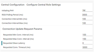

I set a timer to resend a packet (50 bytes) after connected. (Modified from multi-role.)
It lost 20% packets if the timer is set to 500ms. No lost if it is set to 800ms.
I think the next packet should be sent under 3 interval. How do you think?

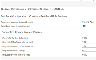

Interval is set to 100~150.
Here are the setting:
BRs,
Zell Wu

    You mean that the intervals may be changed after GATT table exchanged ? Even if I set both master/slave intervals to 100~150ms in multi_role.sysconfig? As i know , the interval is depend on master.
    I will consider the get the timing from GATT table discovery.
    BRs,
    Zell Wu
