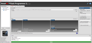

Both cases have a similar behavior and display the same message.
Header Failed!
Header rejected with fault: Stack and
flash boundary mismatch, program
entry mismatch
This happens immediately after pairing completes. On the launchpad output I see the following:

#000123 [ 427.785 ] INFO: (oad.c:752) OAD event=3 next state=0
#000124 [ 427.845 ] INFO: (oad.c:752) OAD event=3 next state=0
#000125 [ 427.905 ] INFO: (oad.c:752) OAD event=3 next state=0
#000126 [ 427.966 ] INFO: (oad.c:752) OAD event=0 next state=0
#000127 [ 427.966 ] INFO: (project_zero.c:837) OAD Error: 9
#000128 [ 430.424 ] INFO: (project_zero.c:1737) Updated params for E0:33:8E:54:5E:30, interval: 30.0 ms, latency: 0, timeout: 2000 ms
This is the output when using iOS. When using Android, the application crashes after the first two "(oad.c:752) OAD event=3 next state=0" messages.
Shouldn't I be prompted to select a firmware file before the header validation process?
BTW, I have also tried with using the Simple Peripheral project with the same results.
