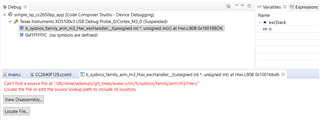

  • Hi, I found out that it get stuck in an exception handler, I decoded the exception in the image below
    I don't have the board schematic. from this exception decoding, can you tell me what might be causing this problem ?
    PS: I am running the sensortag example in the image above.

  • As a sanity check, did you also flash the stack project?
    Here's a link to a guide (designed for CC2640R2 but the concepts still apply):
    Running the SDK on custom hardware:
    Debug CPU exceptions:
    Look through the "Running the sdk on custom hardware" to make sure the pins are mapped out to your custom board, along with the other points in the guide. You may need to do some translation to the CC2650 equivalents of the references in the CC2640R2 guide. There's not enough information in the image, but if you are using an modified SDK example I would not debug this as a "memory issue".
    Unfortunately I cannot assist much further without a schematic. I suspect the issue is either a hardware issue or a mismatch between the example project's pin assignments. You will need to modify the project to match your custom hardware.

  • So, first I pressed debug button on the stack project and then I the stopped the project and then pressed the debug button on the app project. Now it does not get stuck in Hwi, the exception in Hwi(ROV) shows "No data to dispaly". Now when I pause it, it seems to get stuck at some other address but ccs cannot find the source, as shown in the image below:
    Although the task tab (ROV) does show idle task is running. it is possible that it is stuck at idle loop in idle task. Anyways the Simplelink Starter app on my phone shows SimpleBLEPeripheral but it comes and goes and when I try to connect, it does not connect. After 5 tries of the connection the SimpleBLEPeripheral disappears from the BLE device list.
    So what do you say? is it still the hardware issue or I am getting something wrong?

  • Hey Najeeb,
    Glad to hear we're making good progress. Seeing the peripheral on your phone is a great sign. What phone are you using to test? I can try to do a quick test on a LaunchPad to see if I'm also able to reproduce this issue.
    The custom hardware section sheds light on the potential issues that can occur if a device running on different hardware is not properly configured. A quick example is related to sleep clock accuracy. If the device uses a different crystal, the BLE stack needs to be configured for the crystal's accuracy if it's different than our LaunchPads.
