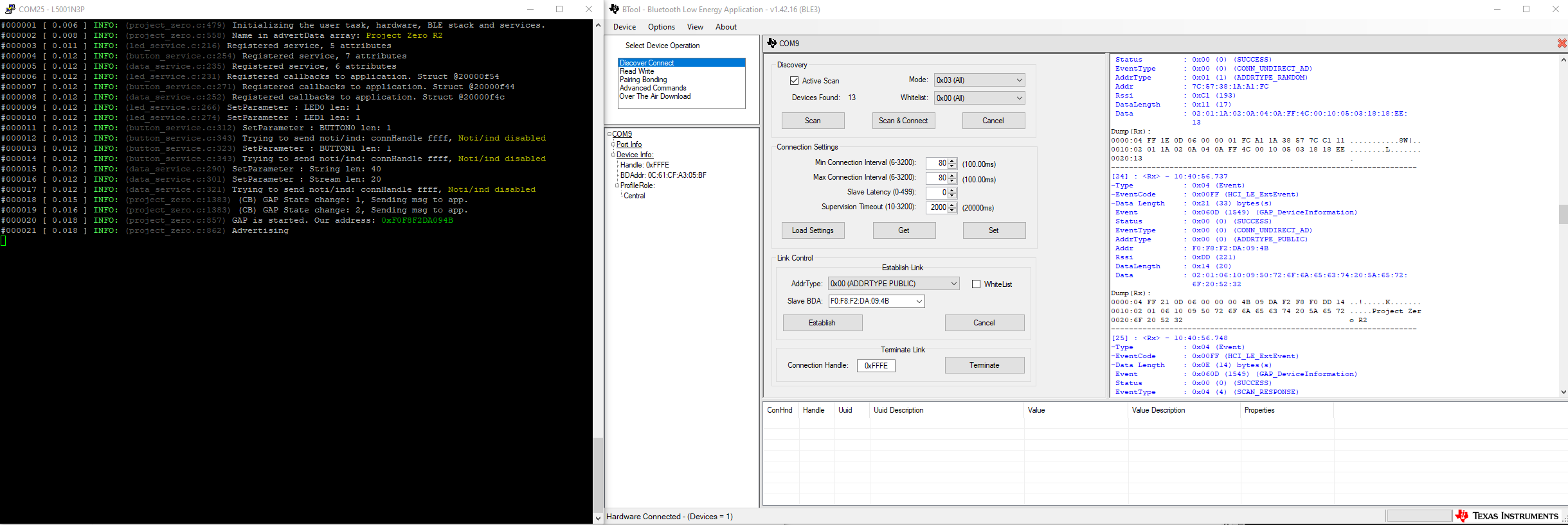

Hi TIers,
Just want you to know that you forgot to enable advertising at GAPROLE_STARTED and GAPROLE_WAITING.
-kel
  • Hi Markel,
    The BLE Project Zero project initializes the advertising by setting the GAPROLE_ADVERT_ENABLED parameter within the ProjectZero_init() function. I did a quick test and was able to verify that upon start-up and post-disconnections, Project Zero would automatically start advertising again. Did you run into any instance where the advertising would not automatically restart?
    Jan
  • SDKv4;40 Project Zero unmodified. Rebuild All and flash hex file using SmartRF Flash Programmer 2 1.8.0. I am using IOS LightBlue App. I already tested 10x am very sure it does not advertise.
    You need to enable advertisement at GAPROLE_STARTED for it to advertise and be able to connect.
    -kel
  • Hello Markel,
    I followed the steps provided and flashed the device using Smart RF Flash Programmer, but I am still able to see the the Project Zero advertising. I am using LightBlue on Android. Can you provide the project_zero.c file as well as the generated hex where you are seeing this behavior? I have attached my unmodified project_zero.c and hex files. We may be able to spot a difference between our files using diff.
    Jan

      uint8_t initialAdvertEnable = TRUE;  // Advertise on power-up
      // By setting this to zero, the device will go into the waiting state after
      // being discoverable. Otherwise wait this long [ms] before advertising again.
      uint16_t advertOffTime = 0; // miliseconds
      // Set advertisement enabled.
      GAPRole_SetParameter(GAPROLE_ADVERT_ENABLED, sizeof(uint8_t),
                           &initialAdvertEnable);

  • Here is the CCS Project. Import it to CCSv10.2. The hex file is there.
    https://drive.google.com/file/d/17XP0awlXOkCeA1R-S5W8_AfNf7XV9OlC/view?usp=sharing
    -kel
  • Hi Markel,
    Thank you for providing a hex file so quickly. I was able to flash the hex file, but I was still able to see the Project Zero advertising using Lightblue Android, BLE Scanner Android, and host_test on another CC2640R2. I have attached a screenshot of host_test showing project_zero advertising. Can you verify if the hex I provided you has the same behavior? I was not able to see a difference between your project and my project, besides the #if block added in GAPROLE_STARTED.
    Jan
    With the same Project Zero hex file, the behavior is at power up it will advertise then stop advertising.
    -kel
  • Hi Markel,
    Thank you for the video. I was able to run a few more test, but was still able to see Project Zero advertising. I took a sniffer log and attached it to this post. (Wireshark). The Project Zero peripheral has an address of TexasIns_da:09:4b. This test lasted a minute and Project Zero was seen advertising throughout. Are you able to take a sniff log or use another phone to see if you are able to see the advertisements for longer? This may be a phone specific issue. What is the specific iPhone model you are using?
    Jan
    https://e2e.ti.com/cfs-file/__key/communityserver-discussions-components-files/538/ProjectZero_2D00_CC2640R2_2D00_Advertising_2D00_1min.pcapng
  • Hi Jan,
    I just flashed the hex file I sent you and see the same results as shown at my shared video. This is what your customer is experiencing. We download your SDK and install it. Then we import the project zero to CCS workspace. Rebuild all and flash the hex file using SmartRF Flash Programmer 2. The project zero advertises upon power up then stops.
    How about you try asking several colleagues at different locations to do the same. Use variations of smart phone for testing. Just discuss and resolve it internally. I am not going to mark this post as "Answered". I
    -kel
  • Hi Markel.
    Thank you for all of the information you provided. I consulted with my colleagues and we were not able to observe the behavior you are describing. It seems you are using an iPhone 4. This may be a device specific issue. We were not able to reproduce this with an iPad air (2011) or an iPhone 5. If you could take a sniffer capture, then this would confirm whether or not the advertisements are truly stopping. You could do this by either using a dedicated Bluetooth sniffer or using a second CC2640R2 board with SmartRF Packet Sniffer 2. Another option may be to enable the RF Debug pins to see the radio activity to verify if the radio is active or not during these periods where the smartphone cannot see the advertisements. The Debugging RF Output section of the BLE User's Guide covers how to do this. Does enabling the advertisements in the points you mentioned earlier eliminate this behavior entirely? I truly apologize for any inconvenience this unexpected behavior may be causing.
    Jan
  • Possible that there is a problem with my board.
  • Yes, I confirmed its a board problem. As you can see from the video the board in use is new. I tested with my very first CC2640R2F Launchpad bought more than 2 years ago and it advertises no problem. Sort of unusual that newer CC2640R2F Launchpad boards gets defective sooner.
    -kel
