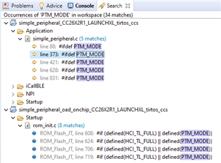

    I searched PTM_MODE in both simple_peripheral projects, and as you can see the oad one does not even include NPI folder and related files. That's why I said it's similar to the CCFG case, it is not supported in syscfg at all.
    Now I need a quick and simple way to add PTM into OAD project for my customer, please advise.

  • Hi Jo,
    Could you tell me if you have managed to run the out-of-the-box project? Could you tell me if you have managed to enable the Backdoor Bootloader? Again, we have to address the issues one by one if not we will never get anything working.
    When it comes to PTM, you should first assess if the available flash will be sufficient to fit OAD and PTM - it should be ok. Then, please refer to this thread.
