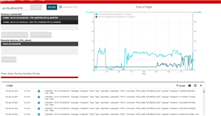

i am using the BOOSTXL-AOA with 3 simplelink launchxl-cc2640r2. i am also using the sdk simplelink_cc2640r2_sdk_3_30_00_20. This is the only sdk version that is working for me, and it only works for RTLS_Monitor version 0.9.5. Also with this version, after a certain amount of time the data stops showing. All the other sdk releases dont work for me, even if i followed the steps properly. All the devices are connected properly and on the monitor i see "sampling ToF data" but then it stops there and no data is shown. can you provide me with some help on whch version of sdk should i use and what to do to fix this problem?
