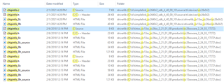

The program appears to debug and run on our board, but runs into this error when paused:
We tried solving the error by adding one of these to the Source Lookup Path, I highlighted the two that we tried:
Here's where we did this:
After making this addition to the Source Lookup Path, the error went away but now it enters this loop whenever we pause it:
This happens regardless of which file we add to the Source Lookup Path, although the code looks slightly different within each chipinfo.c file.
We are just wanting to see the DIO data. What can we do? We appreciate any help.
    First, you have added the proper C file. Adding the wrong C file would not break the code - because the C file is only use by the IDE to help you understand the machine code.
    With that said, the issue seems to come from an incompatibility between the code an the device. Which device are you using? You are mentioning CC2640 in all your posts but here the code is for CC2640R2F.
    Would you like to share a picture of your device / development board?

    We are using the CC2640F128. We could not find any example code for this board (Such as from an SDK or the Resource Center) so we were not sure if perhaps it should be able to run the same code that was written for the CC2640R2F. Here are two pictures of our board:
    The issue is coming from an error between CC2640 an CC2640R2 - You are using CC2640 (the product page is here)
    Please review the getting started guide. For this device you need to download TIRTOS for cc26xx-c13xx and the BLE Stack (here).
    Generally speaking CC2650 an CC2640 are binary compatible, it may help your researches :)
