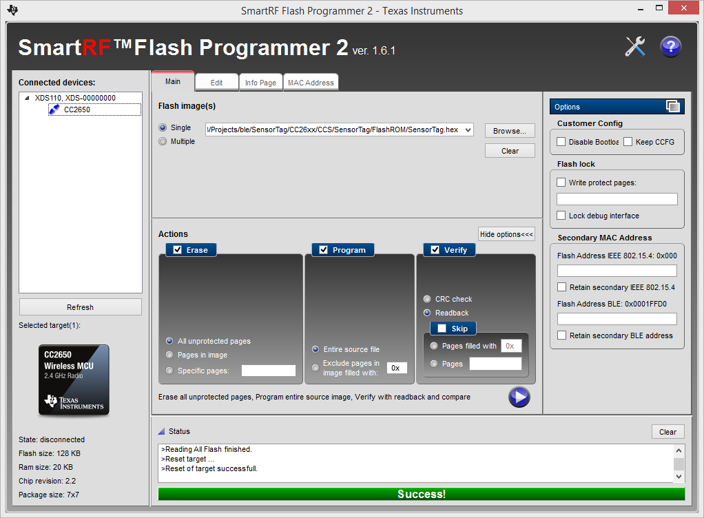

Hi all,
I tried to compile the Sensortag Code and Stack from the BLE stack V2 (downloaded this week).
I openned CCS, imported the Sensortag and Sensortag stack projects, then build everything. It works, and I get a .hex file in the output directory.
I ran SmartRf, and programmed.No errors, but the firmware isn't doing anything... No led blinking or BLE activity. Is anyone having this issue?
Thanks a lot
    Your screen shot only shows the Application project hex file being programmed. Did you build & program the Stack project's hex file?
    Also, you can use the prebuilt SensorTag hex file located in the Accessories\HexFiles directory within the SDK. I would program with this file to make sure your flashing environment is working correctly.

  • Hi AlphaPaul,
    The two images (stack and application) are two fully separate images which communicates through a software layer called Icall (Indirect Call).
    When developing on the current SW platform there are a few things that are important to be aware of that I am not sure is documented anywhere:
    Application/stack boundaries
    The stack must be compiled before the application so that the Boundary tool executed after stack build can adjust the flash/ram boundaries between application and stack (see ch 3.10 of SWRU393)
    Customer configuration
    The SensorTag application project in the current SDK does not include ccfg.c so the last page of flash will be empty if you have fully erased the device. This causes the device to enter bootloader mode (since the field SET_CCFG_IMAGE_VALID_CONF_IMAGE_VALID != 0) when powered on (when debugger is not attached) and the application will thus not work.
    The original HEX file for the sensorTag contains a separate "baseloader" used for OAD support which is located together with CCFG on the last flash page. This project is unfortunately not included with the SDK at the moment but I think it will be for the next release in July.
    I would recommend to do one of the following when developing for the SensorTag:
    Option A
    • Erase the device
    • Flash the device with the original HEX image (which includes CCFG and the baseloader
    Modify the linker file (cc26xx_ble_app.icf) and remove the FLASH_LAST_PAGE region and the ccfg section. Note that the linker file is shared between projects so you might want to do a local copy and change the linker file settings.
    • This is to ensure the baseloader from the original HEX is not overwritten by an empty last page by the application
    • Flash your application and stack either through CCS / IAR or with SRF Prog 2. Remember to only erase "Pages in image) when flashing with SRFProg 2.
    Option B (no OAD support)
    • Erase the device
    • Modify the application to compile in ccfg_appBLE.c
    • Flash your applicatino and stack as normal.

  • Also be careful with Erase->All unprotected pages setting ...
    When you are programming both the App and Stack, then Select Erase->Pages in image (don't select erase all unprotected pages)
