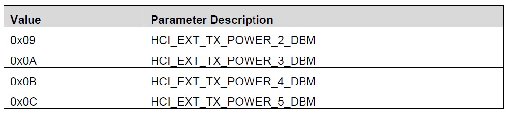

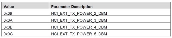

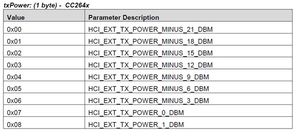

    At TI BLE Vendor Specific HCI Reference Guide Version 3.1.0 these values below should be set at HCI_EXT_SetTxPowerCmd();. Meaning the TX Power defines values at ble_user_config.h are WRONG
    I change the TX Power define values at ble_user_config.h to these below. I set TX Power from 0 dBM to 5 dBM and I am able to measure incrementing current values, which is correct. I recommend that at future CC2640R2F SDK releases that the TX Power define values at ble_user_config.h change to these below or its decimal equivalent (0-12).
