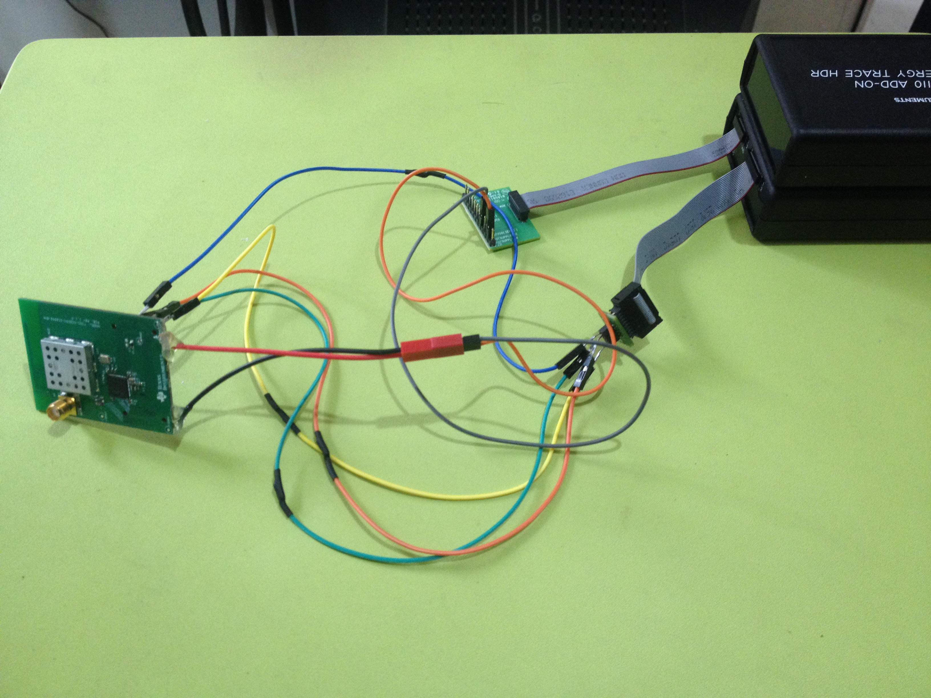

    Here are my complete test results using the TxPower Table below. I am using XDS110 Debug Probe + Energy Trace Debug Probe Add on.

    With these test results above the TXpower table is not good. I am using Energy Trace to get this current values and I do not know how it compares to DC Power Analyzer. Most likely the DC Power Analyzer is better.
    What I would like to know is how do I set the TXPower values from the tidub71.pdf at the TxPowerTable[]. I already asked about this and I did not get a complete answer.

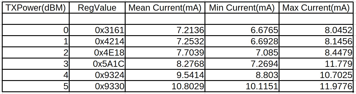

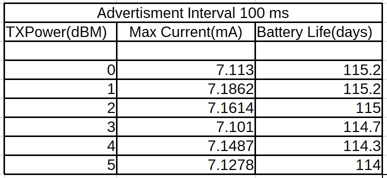

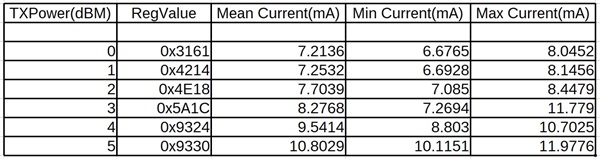

        Using Simple Peripheral Stack Library from SDK 2.20 I did Energy Trace Test using CC2640R2F Launchpad with TXPower from 0 dBM to 5 dBM. Here are my tests results below. Is this normal? Should it be that a higher TXPower would equate to higher current consumption? This is is shown at tidub71.pdf, but that data is for CC2650-CC2592 EMK.
      -kel

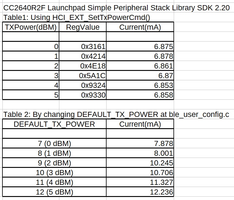

  • Hi Kel,
    From those results it looks like you are running 0 dBm only. How are you changing TX Power? Are you using the HCI command?
    Cheers,
    Fredrik
  • Hi Fredrik,
        With the CC2640R2F Launchpad test I call HCI_EXT_SetTxPowerCmd(TX_POWER_0_DBM); at Initialization. My procedure below.
    1. Set TXPower.
    2. Build Program
    3. Load Program using CCS Debug, then terminate CCS Debug Session.
    4. Perform Energy Trace.
        I also flashed hex files using SmartRF Flash Programmer with TXPower = 0 DBM and TXPower = 5 DBM. Then measure current using Digital Multimeter. The CC2640R2F Launchpad is powered using 2xAA battery. I read around 7mA max current at both TXPower = 0 DBM and TXPower = 5 DBM.
        Anyway, I am currently trying the TXPower Table by TI TA12012 to CC2640R2F-CC2592 EMK and I am not getting the expected results. At TPower 9 dBM I read max current 126. 9846. TI TA12012 table can be found at this post below. I need help with this as I am doing this project that will go to mass production at next phase.
    -kel

    Can you try running the rfCarrierWave example from CC2640R2F SDK 2.20? Try using different txPower settings in smartrf_settings.c and see what corresponding current consumption you get.
        Here are my test results using TI TA12012 TXpower Table. The current increase from 9 dBM to 12dBM. Then the rest is around 126 mA. This similar current measurement readings at different set TXPower value is same test results with my recent test using CC2640R2F Launchpad. I can conclude that HCI_EXT_SetTxPowerCmd() has something to do with this.
    Here are my code changes below.

  • Hi Fredrik,
        Here below are my test results using rfCarrierWave Example Program running at the CC2640R2F Launchpad. The data is good and clearly shows at Mean Current(mA) column that the current increases as TXPower increases. So, with this I still conclude there is problem with HCI_EXT_SetTxPowerCmd(). What is the fix?
        I can't help but feel dissapointed that the HCI_EXT_SetTxPowerCmd() does not work. But I only lost some time and sleep doing these test with my cheap testing tools.
    -kel
    I guess this will be resolved at the next TI CC2640R2F SDK release? I will keep this post unresolved for now.
    I do not want to test older SDK version if the HCI_EXT_SetTxPowerCmd() works or not!
    -kel

  • Hi Fredrik,
         To summarize what I previously did, since for 7 days there is no reply here.
         Just so to eliminate the factor of the use of modified TXPower Table and CC2640R2F-CC2592 EMK, I did the test using CC2640R2F Launchpad and Simple Peripheral SDK 2.20. I change the TXPower using HCI Command. Here are the test results below.
    As per your request I did the same test using rfcarrierwave example program. At rfcarrierwave you do not use HCI Commands to set TXPower. Here are the test results below. The mean current is the average current. The Max Current is caused by some spike.
    The data clearly shows that the HCI_EXT_SetTxPowerCmd() at SDK 2.20 has problems. I did these test more than 2x just to ensure the data is valid.
    -kel
        I did another set of tests using CC2640R2F Launchpad. First test I call HCI_EXT_SetTxPowerCmd() at SimplePeripheral_init() to change TXPower from 0 dBM to 5 dBM. Second test I change the DEFAULT_TX_POWER at ble_user_config.c. Here are my test results below shown Table 1 and Table 2. The test results clearly shows that HCI_EXT_SetTxPowerCmd() does not work. So, it is no good if I use it at CC2640R2F-CC2592 EMK. When can I expect the fix for the HCI_EXT_SetTxPowerCmd(). I want to modify the HCI_EXT_SetTxPowerCmd() but I can not find the code for it.
      Also, just out of curiosity I did the same test using CC2650 Launchpad and Simple Peripheral BLE Stack 2.20 and I am getting similar results. Meaning it is possible that the HCI_EXT_SetTxPowerCmd() did not work from CC2640R2F SDK 1.00 to SDK 2.20.
     -kel
