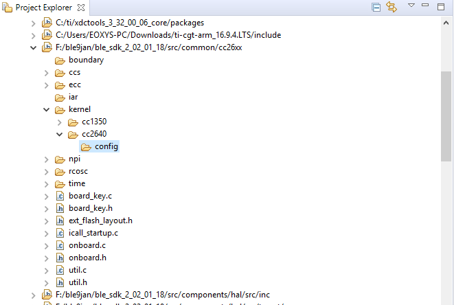

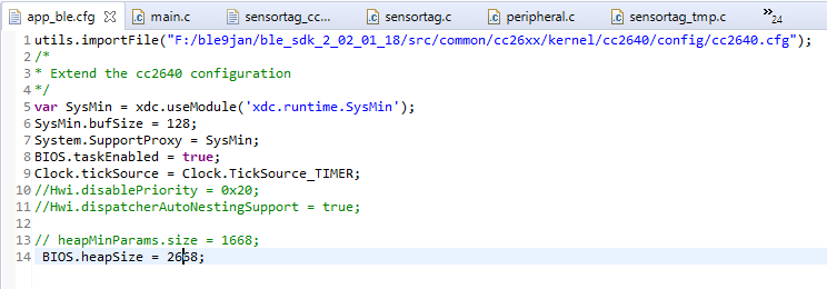

    1) We have increased heap size by 1000 bytes more (Please refer below screenshot). Even then, we are getting same above issue. Is the heap config fine?.

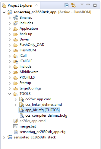

    2) The very first line of above screenshot shows importing of cc2640.cfg file. We doubt that this cc2640.cfg file is not getting imported properly. How to check this importing of cc2640.cfg file working fine?.
    3) This cc2640.cfg file is not visible under TOOLS folder of Project Explorer (Please refer below Project explorer window screenshot). We feel that cc2640.cfg is not imported properly. How to make this cc2640.cfg file visible under the TOOLS folder of Project explorer window?
    4) The cc2640.cfg file is not visible under the Project explorer include path as well (please refer below image). Is this okay?. But this cc2640.cfg file is anyway there under this include path when we browse and see via Windows File Manager.

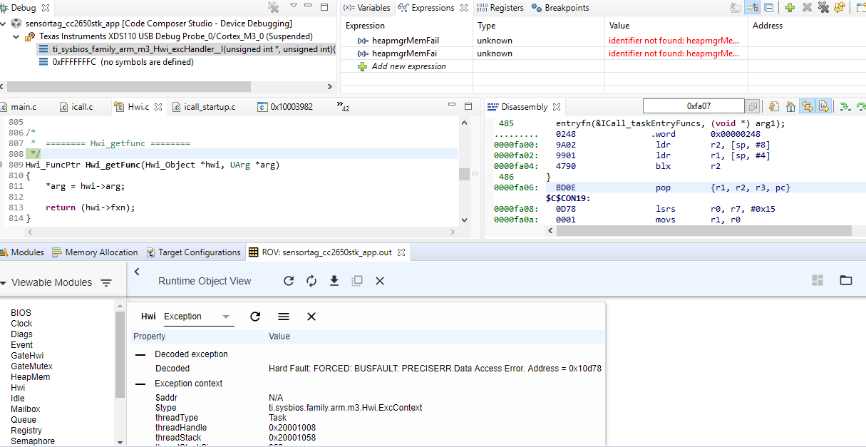

  • Hi Sean,
    I have added the heapmgrMemFail in the CCS watch window , and  I ran the processor in the debug mode after run when I paused  in watch window I t is showing variable not found.
    and  it is showing HWI.C FILE .(Hwi exception handler as shown below) I'm not getting what is happening ? and I  set the  HEAPMGR_SIZE to 0.

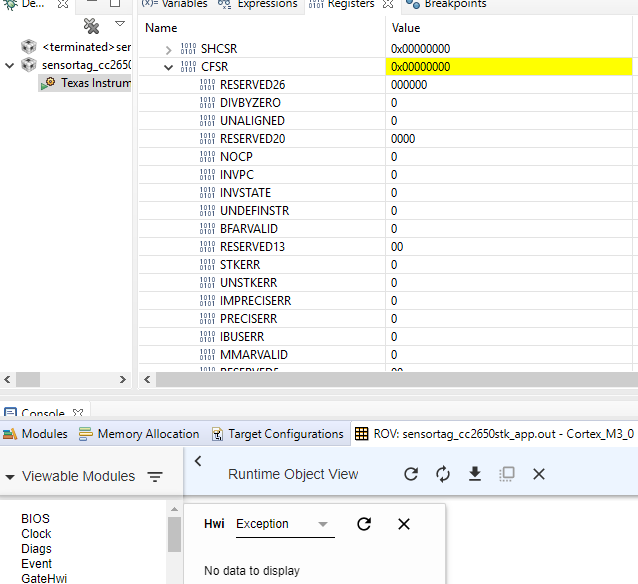

  • Hi  Sean2,
     1) I added the variable  as heapmgrMemFail as you said, then also I'm getting  identifier not found as shown below.
    2) I  went through the deciphering CPU exceptions , the CFSR register  contents is shown below( after run the target)
    I'm not getting what is the wrong can you give some suggestions?
  • Hi Sean2,
    I think I'm having an issue with the Hwi exception handler as shown below. I dont have much knowledge about  this  HWI handler
    can you give some suggestion  for solving this issue?

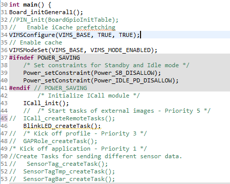

  • Hi Sean2,
    We did following 2 tests by having BLINK LED task (BlinkLED_createTask) and ICALL task (ICall_createRemoteTasks).
    1) In main, the BlinkLED_createTask alone is enabled (as per below screen shot image). Here the ICall_createRemoteTasks is commented out. With this, the project is working fine and no exceptions were raised. The CFSR register is set to all 0's (i.e no errors in CFSR).
    Debug window screen shot image:
    2) Next time in main, both BlinkLED_createTask and ICall_createRemoteTasks are enabled (as per below screenshot image). With this, the project is NOT working fine and Hard Fault Exceptions were raised (Please refer screenshot image). In CFSR, the INVSTATE flag is set.
    Debug window image:
    3) With respect to above tests in point 1 and 2, We feel that ICall_createRemoteTasks is having issue and causing exceptions. For your information, we have compiled both app and stack projects successfully. But, we have downloaded only app project out file (sensortag_cc2650stk_app.out) into CC2640 target via XDS110 JTAG debugger probe. We have NOT downloaded stack out file (sensortag_cc2650stk_stack.out) into target. We assumed that app out file is combined with stack out, when we compile app project. Are we doing it correctly?

  • Hi Roopa,
    UNDEFINSTR and INVSTATE consistent with a device trying to execute an invalid instruction, specifically one that does not have the THUMB bit set. All instructions in CM3 must have this bit set. In general you can get into this state by attempting to execute an invalid function pointer or where the runtime stack has overflow causing an invalid instruction to be loaded.
    This is the problem. The stack and app projects compile and link as separate images. In fact, if the ICall task is enabled, then the process will attempt to "jump" into the stack by executing ICALL_STACK0_ADDR as a functon pointer. If you have not loaded the stack project then it will jump to a region of flash without code present (0xFFF...).
    This is covered here:
    www.ti.com/.../swru393
    Section Chapters 2-4 cover the SW architecture, section 2.7 covers how to merge hex files if needed using python.

    >> Here, We see that the ICALL_STACK0_ADDR is NOT defined. But the following key values are defined
    ICALL_STACK0_ADDR should ALWAYS be defined. If it isn't you can get into the situation you described with overlapping hex files.
    have you verified that ccs_linker_defines.cmd is passed into the linker options on CCS? (Project properties --> ARM Linker --> File Search Path)
    At this point is seems something is wrong with the proejct settings. Can you try this again with a fresh install of the SDK as well and try to reproduce this?
