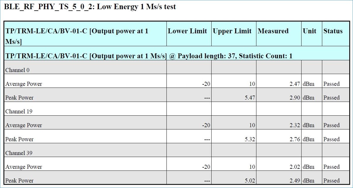

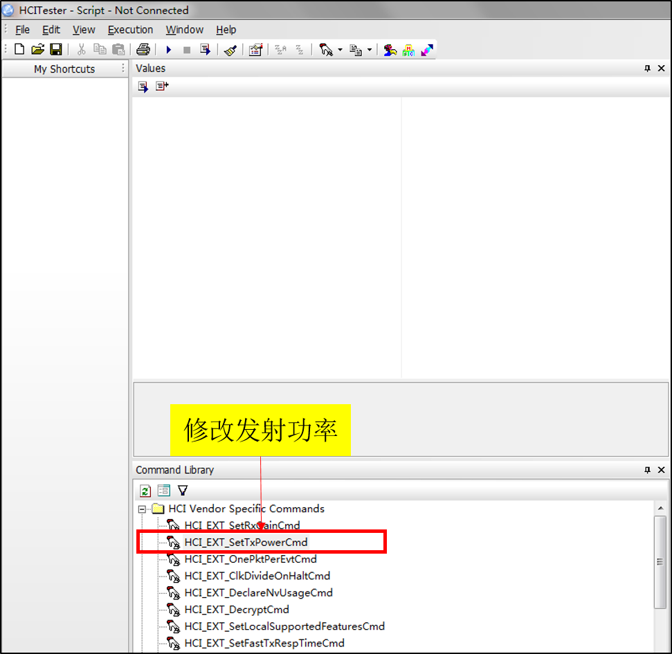

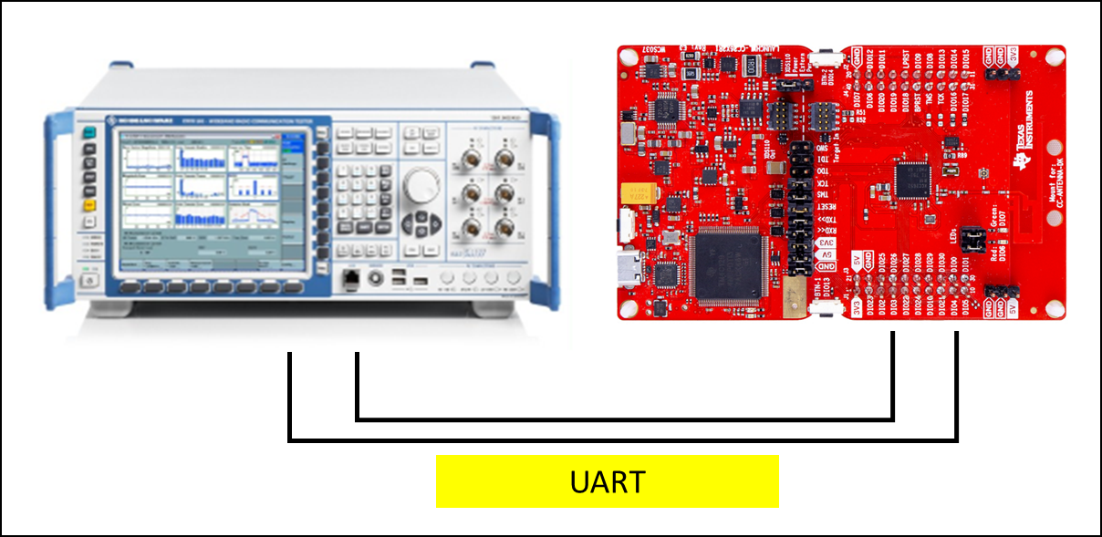

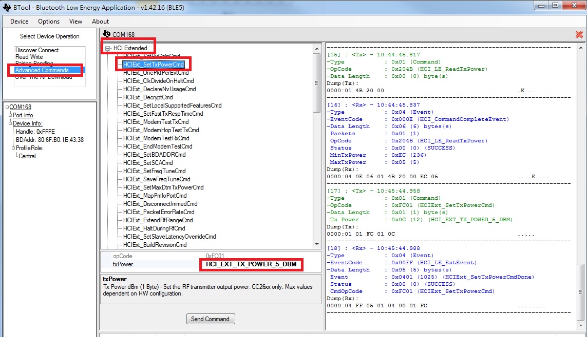

     The default TX POWER of Simple Peripheral project is 0dBm . However , the TX POWER should be changed to 5dBm in order to improve BLE transmition distance .
     In order to verify which configuration setting parameter can change the default TX POWER , the HOST TEST project and CC2652 Launchpad were used , as shown in picture 1 . The macro
definition DEFAULT_TX_POWER was set to HCI_EXT_TX_POWER_5_DBM , as shown in picture 2 . Testing the actual TX POWER of CC2652 through R&S CMW500, as shown in picture 3 . The testing result
is shown in picture 4 .
      Neither the DEFAULT_TX_POWER was set to HCI_EXT_TX_POWER_5_DBM or HCI_EXT_TX_POWER_0_DBM , the actual TX POWER of CC2652 stayed the same . How to change the default TX POWER in CC2642 ?
     Where is my configuration wrong ?
picture 1 CC2652 Launchpad
picture 2 My DEFAULT_TX_POWER configuration
picture 3 R&S CMW500
picture 4 TX POWER testing result
